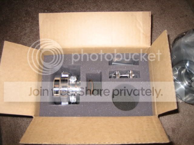

Ok so im getting ready to talk to the company that i bought my pistons from and im going to tell them my situtaion and see if i can get a
bigger pistons,regradless of what the mechanic says about seeing if i need to bore,I think its wiser to bore it out and have it hot tanked...but do you think a 81.5 bore is good or what do you recommend for my goals?
Also thanks for the link to the Mounts! Got a great deal..

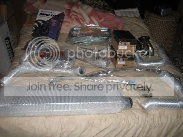

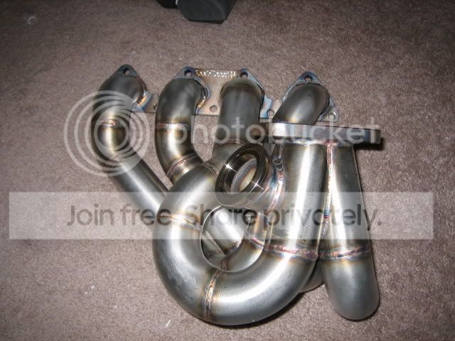

Well i just did my taxes and it looks like ill be able to use another 1k so that brings me back up to 2k..after buying these parts below along with
a Moroso oil pan..Ill now be able to hopefuly gather what i need to finish and tune my setup..im now looking for a 3" Exhaust,buying
and having installed the S300,OBDII to OBDI harness,and P28...
However i was looking at the VictorX Manifold
and was looking to make my goal a little more achiveable by adding a better Air flow..
however ive read about this paticular manifold
and they say that it more efficent from
7,000 to 10,000 RPMS...
Now i dont plan on going past 8,200 Redline point..so with that being said will this mani. still be good for my setup?

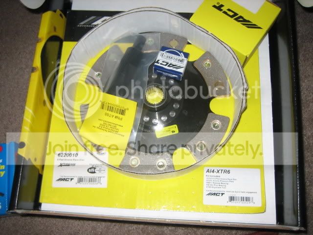

from where did you buy your clutch and how much you paid ?
Old Feb 10, 2007 | 04:11 PM
  #66
JWjDM's Avatar
Posts: 83
From: Ca
JHPUSA..$517 After taxes,and Shipping..

the edlebrock victor x is good for everybody lol. but you can save yourself some money and go with the skunk or type r as those are gonna be better than stock for sure. as far as 3" exhaust- either kteller or thermal or goto your local muffler shop and have them custom fab something for you. now that you have an extra $1k, save it or save most of it in case there are any hiccups during or after the build. its always better to be over-prepared

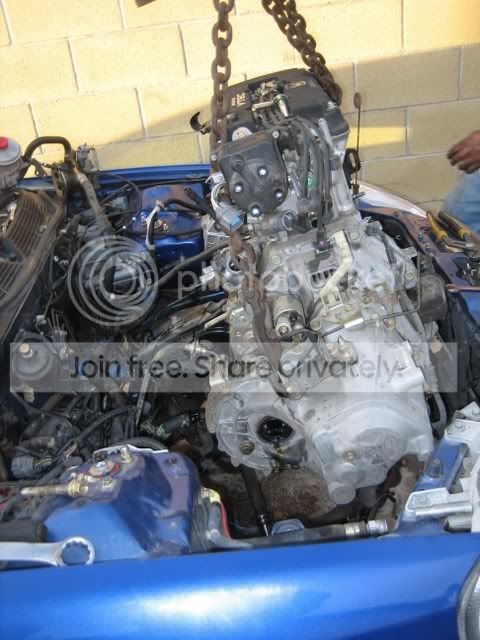

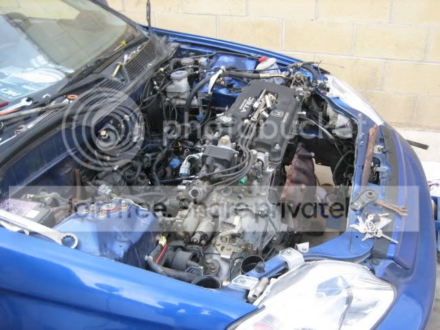

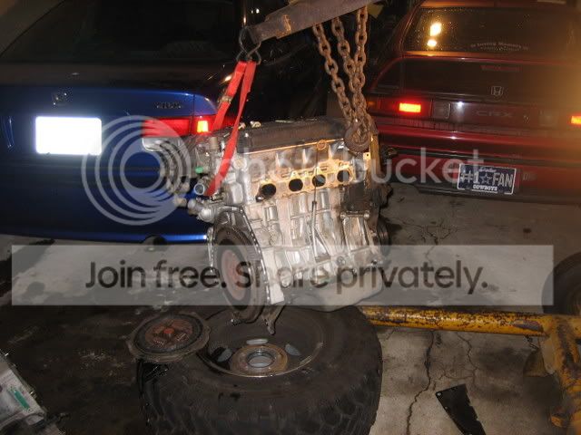

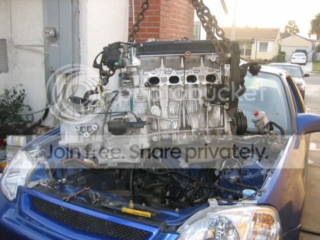

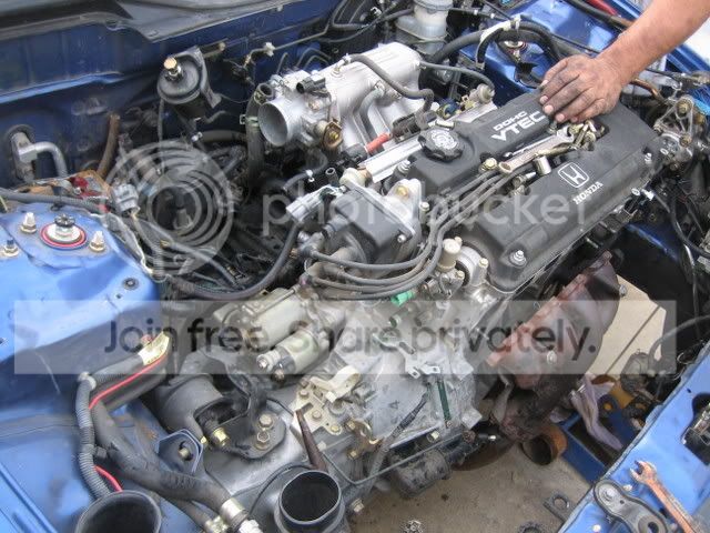

well after working on the car this past weekend,Removing the engine and getting it ready for the mechanic,Just felt like throwing up some pics..
^^^ Suck
gonna take the flywheel and have it machined

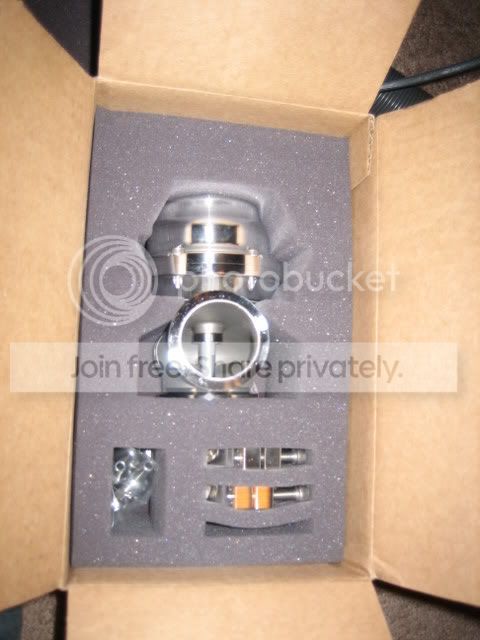

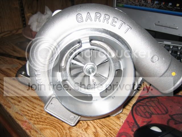

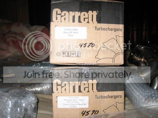

And YES!!! about time my turbo finally came in today along with my Moroso Oil Pan..
Old Feb 21, 2007 | 07:24 AM
  #72
zexxbo's Avatar
Posts: 2,887
Default Re: (JWjDM)
if you notice on the side of your tial wastegate box, it says .7bar (10.15psi) which is the amount youll be boosting without a boost controller. youre gonna be 300+ whp with that amount of boost, maybe even be somewhere around 330-350whp it depends. everything looks pretty sweet tho, but did you ever find out if your motor needs to be bored out?

Yeah i did notice the wastegate label,i was bummed when i didnt see any little boxes with different springs like you said,but its cool..im actually looking to make
around 350-400 or whatever i could get out of the setup..

lol ops. i didnt mean boxes with springs, i meant like a checkbox (like on job applicatiosn where it says male/female, etc). you can buy different spring rates but the springs are like $20-$30 each i think, sorry to give you the wrong impression. but usually there is a checkbox on the side of the box that is marked with the spring rate currently inside the wastegate, yours looks typed.
