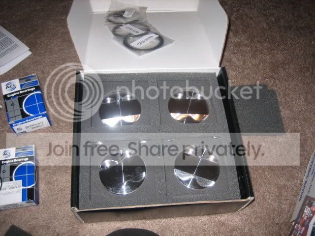

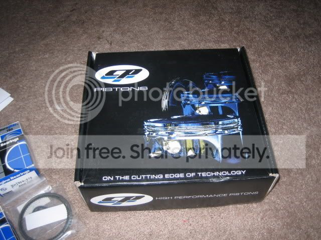

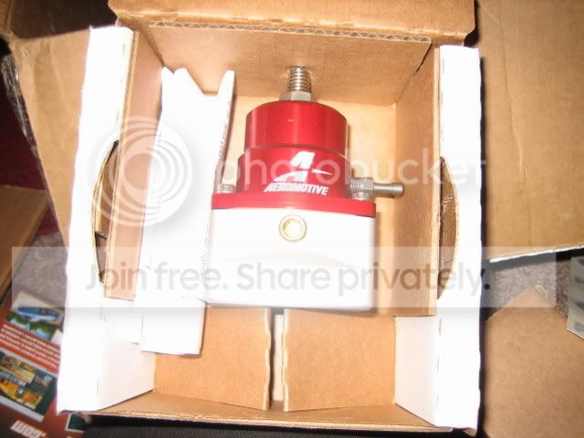

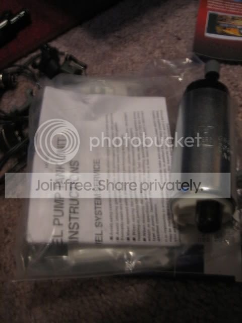

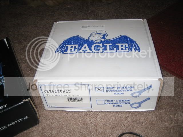

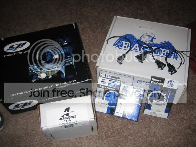

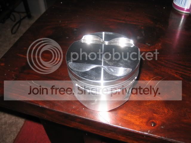

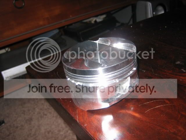

While now awaiting my Clutch and Turbo Kit to arrive..
I recived my other parts..But you guys were right..I dont know what i was thinking when i
ordered the 81mm without even checking to see if i need to bore out to 81.5mm..
hopefuly i dont need to but i know that im better of doing so,well see....
I just wanna say thanks to everyone here on Honda-Tech that has helped me..
I didnt know Anything about Turbo Setup until i came to Honda-Tech..
So thanks for helping and guiding me in the right path..

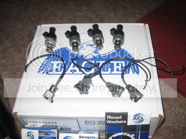

ignore most of this, 780cc injectors are enough to hold 550whp and probably more. anything more than that and youre going to want sleeves for your block. your setup is gonna be fine with the eagle rods and cp pistons. have your mechanic micropolish your crank and check if your engine needs to be bored ASAP. if it does need to bore to 81.5mm then contact whoever you bought the pistons from and explain the situation and im sure they will take care of you.
its ok that you didnt check your block before ordering your pistons, but im under the impression that its currently in your car for daily driving so i see the dilemma and you didnt really seem like you knew to anyways, so lesson learned. youre gonna need fittings for your aeromotive fpr and you might want to pick up a fuel rail. you will want some cross drilled or slotted rotors, you can usually find some unused ones on ebay that someone doesnt need for cheap. i got front powerslots for $65 shipped so maybe you can find something similar.
<TABLE WIDTH="90%" CELLSPACING=0 CELLPADDING=0 ALIGN=CENTER><TR><TD>Quote, originally posted by HiProfile »</TD></TR><TR><TD CLASS="quote">I hate to sound like a jerk in any way. But you say you want a turbo/manifold that will support mroe power if you choose. Then you try to get smaller injectors, you don't check your block for problems, you want to 'build' the head...and everything that you ask has been covered at least 10 time EACh in the archives.
