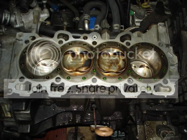

Old Jul 28, 2006 | 01:28 PM
  #54
TypeSLO's Avatar
Posts: 399
From: FL
Default Re: (redzcstandardhatch)
well, in my case, i just pulled the head off of my motor. i have another head which has been machined and is practically brand new. using a golden eagle 84.5mm head gasket. i don't plan on pulling the block out and machining it since everything looks great. i will test the surface of the block for trueness but that's the main reason why i asked this question in the first place.
plus i had a problem before with the headgasket. it was leaking a bit of water into the oil.
this is a pic of the block. you won't be able to tell anything but that's after a little over 10k miles. cyl 2 and 3 had some oil sitting on top so it's got a sticky oil stain. 1 and 4 look brand new.

Default Re: (ryan89crx)
<TABLE WIDTH="90%" CELLSPACING=0 CELLPADDING=0 ALIGN=CENTER><TR><TD>Quote, originally posted by TypeSLO &raquo;</TD></TR><TR><TD CLASS="quote">well, in my case, i just pulled the head off of my motor. i have another head which has been machined and is practically brand new. using a golden eagle 84.5mm head gasket. i don't plan on pulling the block out and machining it since everything looks great. i will test the surface of the block for trueness but that's the main reason why i asked this question in the first place.
What torque sequence are you using?
