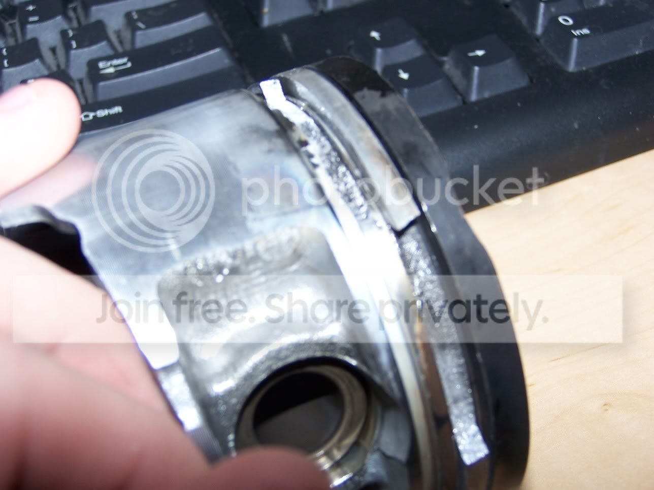

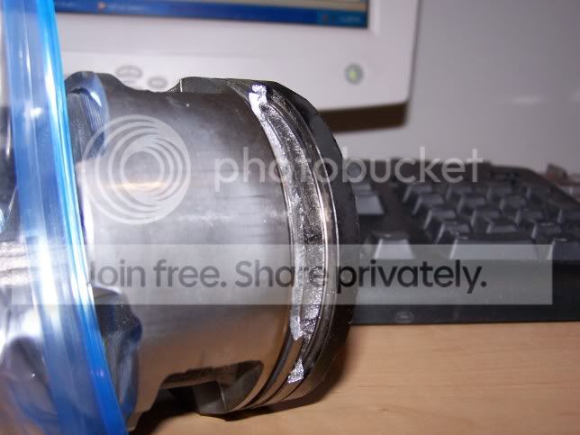

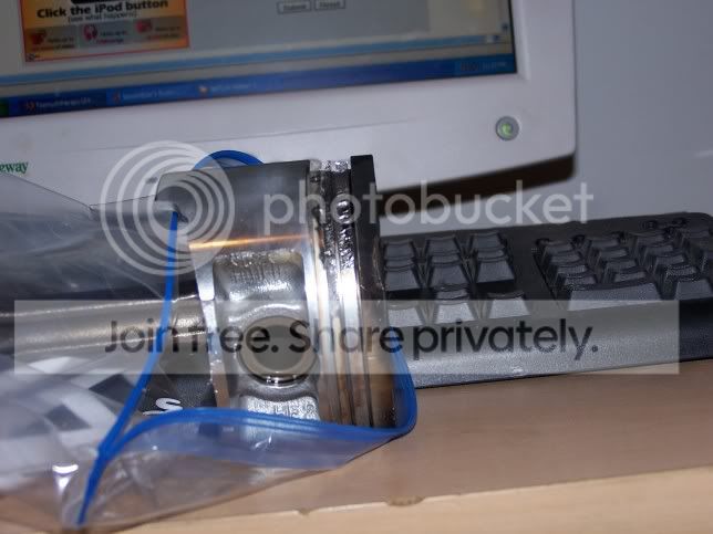

well, we ripped it apart, and i busted the ringlands on 8psi........
cylinder 1
cylinder 2
cylinder 3
and cylinder 4 had a hairline crack..
the rings were fine too
