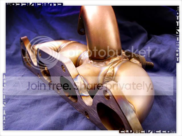

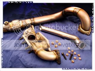

If you're doing a B18C1 and MUST do a cast log manifold, try this:
Smooth flow, no dremel required!
Spooling performance has GREAT prices on their log manifold combos. Check out the Forced Induction Sponsor's Only forum... https://honda-tech.com/zeroforum/49

I agree with the SPoolin log. Its going to be just as reliable as a cast manifold, but with all the advantages of a good manifold with good wastegate placement. Another option (that costs more than the log above) is the InlinePro SS manifold. It has great wastegate placement and has been proven (in T4 form) to over 750whp

That manifold looks like crap especially around the collector (notice how it enters the collector unevenly). You also have to realize youre going to have to make a custom downpipe and dumptube ($$$). Just dish out the cash and get a good log manifold if thats the route you're going to go. 575 for Manifold,DP, and Dumptube that are top quality is a good deal ... http://www.spoolinperformance....3d169
Phil makes good manifolds, you're goals are 300-350. I made 380hp @ 14psi with my B18C1 using one of phil's log manifolds. Its worth the money. Hes a good guy.

the only cast B-series manifold I would buy, but it cost more than phil's
inline Pro T3

<TABLE WIDTH="90%" CELLSPACING=0 CELLPADDING=0 ALIGN=CENTER><TR><TD>Quote, originally posted by JoePSI &raquo;</TD></TR><TR><TD CLASS="quote">the only cast B-series manifold I would buy, but it cost more than phil's
inline Pro T3
good manifold, 400hp on my buddys b18c.

what's up with the ninja star design.

<TABLE WIDTH="90%" CELLSPACING=0 CELLPADDING=0 ALIGN=CENTER><TR><TD>Quote, originally posted by Rickdrizzle &raquo;</TD></TR><TR><TD CLASS="quote">what's up with the ninja star design.</TD></TR></TABLE>
you can drill the other sides to turn your wastegate placement

Spoolin log combo
