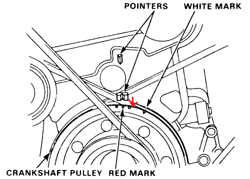

Just to be sure, if I wanted to retard my timing 4 degrees I would be right about here wouldnt I?
Yes the red mark pictured would be ~12 degrees base timing.
