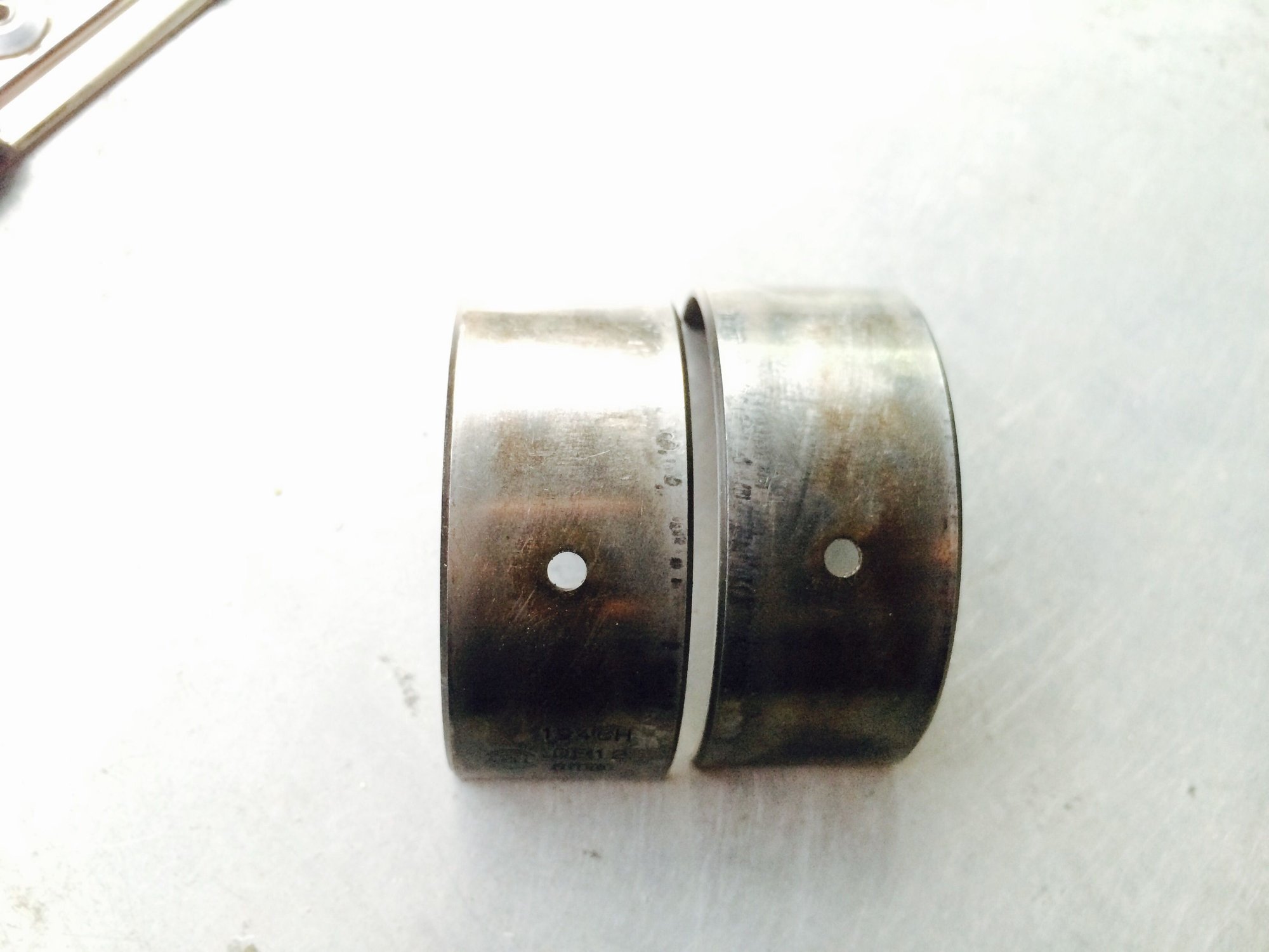

Damn that's bad. Do you think that know is really die to this bearing? The rod was stuck and had no movement what so ever on the crank journal, not even side to side.

That's the outer side of the bad bearing.

And the inner side...
