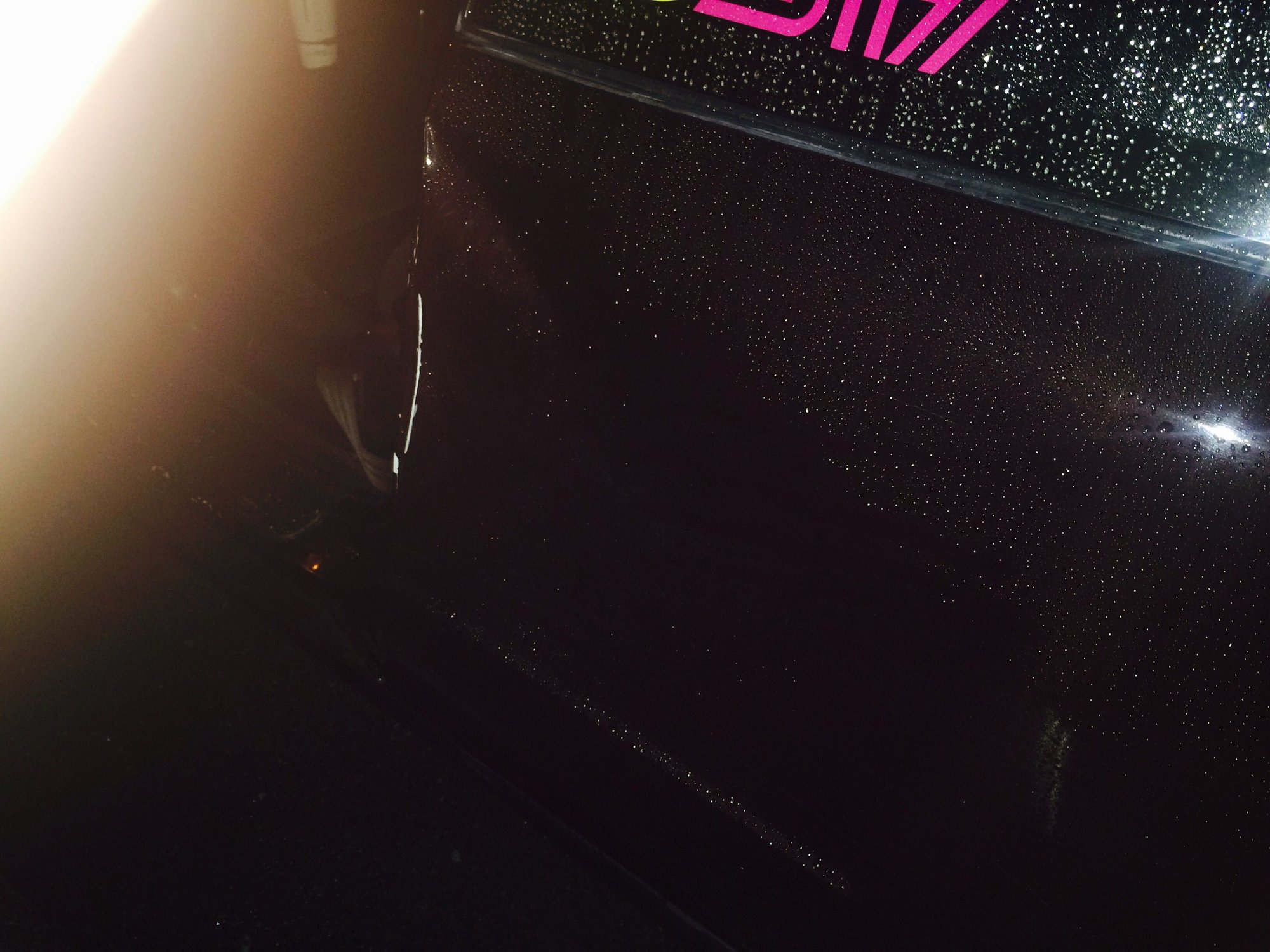

Car has been having a rough week. Woke up this morning to see a huge ******* dent in quarter panel because someone didn't ******* know how to park. Left no note and anything. Last nite around 11pm I woke up to my alarm pager and thought someone was trying to get in my car so I looked out side and it was clear and this morning I noticed that dent. Now time to repaint the car aswell.
