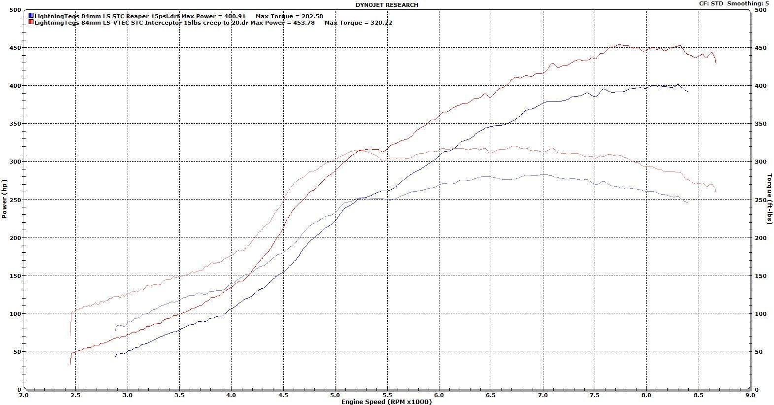

theres no way it was 0. Im talking same boost levels, he had a number for torque at same boost levels, so im assuming he at least tested at same boost levels. Vtec heads typically rev higher so there has to be a change postive or negative at the same boost level I doubt HP was exactly the same

The VTEC setup had about 5 lbs of creep in it to 20 lbs. I think if it had remained stable like the LS head did the torque would have fallen off up top to about match the LS at 8500 rpm so peak power would have been about the same. Conditions were not favorable though. Had some issues with the fuel pump.
I dont think the LS would have had nearly as much of change with spool with the new turbo just because the 404 cams dont come into power until 5000 no matter what, so the car wasnt breathing down low. The Low cam of VTEC is allowing efficiency where the race cammed LS could not.

creep? but both dyno runs were at 15 psi yes? or was it creeping past 15 psi? this was on GSR cams?
also faster spool on bigger turbo good work, both turbos seem pretty large for what your making...havent actually gone through your entire thread mostly cuz your build has way diff goals then me. I assume your turning up the booost to hit 600 HP
Those aren't even the final graphs
Both ran around 30+ psi and hit 600whp
Itr cams, plus there was a typo or something on the graph he posted
(ITR Cams) The Vtec setup hit 15 psi 750 rpm sooner and made more torque but it ended up around 19-20 lbs by 8500rpm
Yeah the LS made 602/453 on 30lbs. I've street tuned the VTEC setup to that number and based on acceleration logs and injector duty cycle, its probably 625 ish. My pump went out on the dyno when I started to turn up the boost unfortunately.
