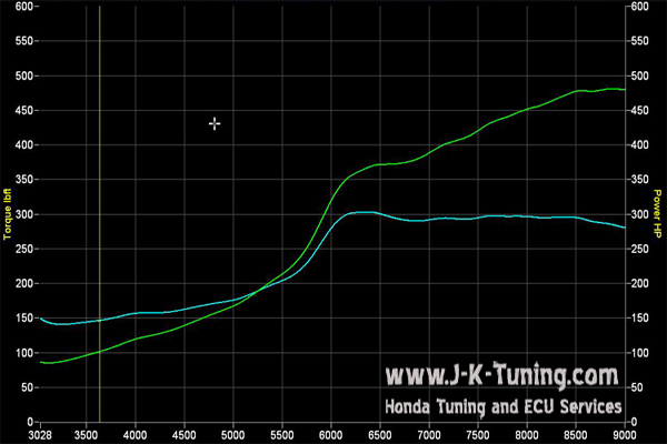

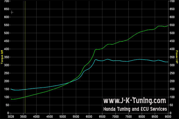

Here are two graphs from today.
First one is at 16psi.. at 16psi it made more power than it did last time on 19-20 psi.
The second one is with the boost at around 20psi on the top end. The clutch start slipping at anything higher than 18psi so it has a little wave in the graph from the clutch.
Overall it was a 80-90 whp gain over the Log manifold!

Dyno plot time.
Yambor's newest manifold setup at 20psi (solid) and 16psi (dotted).
His clutch didn't like things very much in the last two runs.
Here's his newest setup (solid) versus his old log manifold setup (dotted).
And the pressure graph between the two setups on high boost. (Pink=New)
