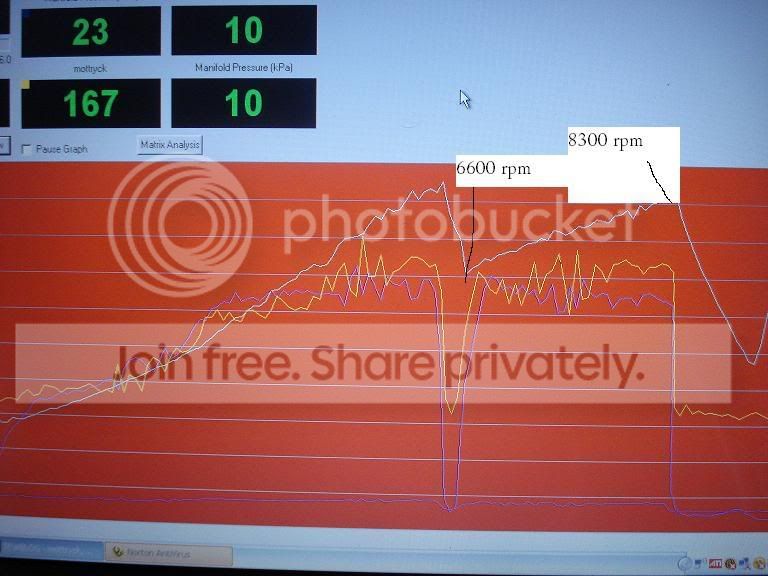

how much back pressure do you guys have?
i thought mine was a little high, iam only boosting 14psi
my setup is
b16a1
Garrett 57trim stage 3 turbine 63 A/R
UGR manifold 3"downpipe and exhaust with no cat
itr cams
the light blue line is rpm
the pink is boost
yellow is back pressure
max backpressure was 1,4 bar
[IMG][/IMG]

Where are you monitoring backpressure?
Old Aug 31, 2007 | 11:27 AM
anton_'s Avatar
Posts: 218
From: umea, sweden
Default Re: backpressure (alpha)
i took it one Inch from the collektor

what kind of power is the car making? where does it peak? and where does it fall off?
these answers would determine if backpressure would even be of concern.

haven't dynoed yet but i have checked my hp with a gtech and a AP22 and it sas that the peak hp is around 8200-8500. the car pulls hard all the way to readline

That would be a 1.55:1 ratio - thats not high at all. Most oem setups go well past 2:1, while VERY few 4-cyl turbo setups go below 1:1. You will tell when your exhaust/turbine becomes a big restriction - torque will drop like it was a V8 at redline.
