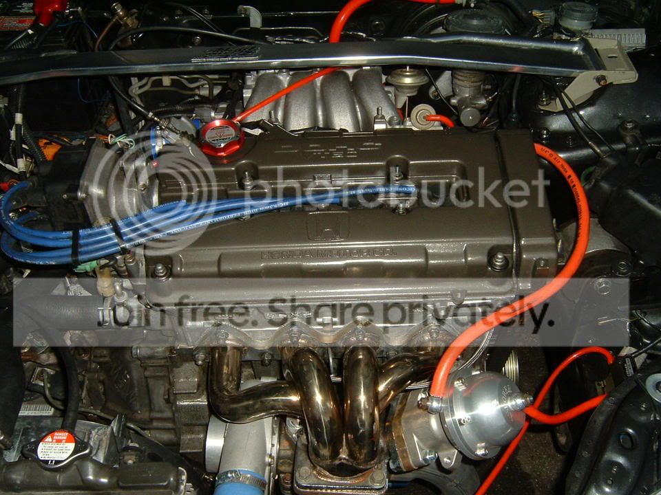

here is mine... GSR HEAD...B20 Bottom...T3T4.... !!!STOCK SLEEVES!!!... Scat Pistons... Eagle H Beam rods w/ ARP rod bolts... ems is HONDATA S300...biggest issue is i cant release crank case pressure... need to get PCV valve put in i think...
just dynod' @ Church Auto in Long Beach... made 200 whp @ 8psi on "Stock" Fuel Pump, had to stop the dyno tuneing because the car started to run lean... will be changing out fuel pump and running again... will post dyno pics soon... having issues with car currently, i think i killed my current fuel pump... if you have any questions...fire away... i have been on this project for about a year.

im running DSM Blue top 450 cc's would have went bigger but the motor isnt sleeved so no use, waste of money
PRIMETIME...dont believe ur tuner... yea you can do it im sure... but the beating you take is not worth the power you may gain... those walls are PROVEN thin... trust me... my tuner KNOWS whAt he is doing and has a very good clue what he is talking about... to make 3 spreads in TIME magazine in the past 2 years, and COUNTLESS Import Tuner & Tune Mag prefered tuner choices... im sure he may have a clue what a reliable motor is.
not saying you are COMPLETELY WRONG...you can push 20 psi at some stock sleeves ALL DAY LONG... but for how long is the question!
you really need to take these things into consideration...so u guys are telling me that with "PERFECT TUNING" and a nice set of forged internals you can run 18-20psi (or more), AGGRESSIVE/NON-AGGRESSIVE DAILY DRIVING on "stock B20 Sleeves" and not have a thing to worry about...WRONG...-PERFECT TUNING- will not increase the strength of your sleeves... dont equal out...
