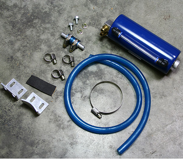

I dont know who installed that ebay kit, buy with that kit came blue catch and that have only ONE hose so it doesnt breath at all. So one hose comes in and its closed tank. Like in this picture but only 1 place for hose.
