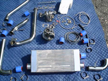

set up for a gsr its a ebay kit but will work for now 57 TRIM
5 BOLT EXHAUST
STAGE IV WHEEL - BRAND NEW
.50 A/R
.63 EXHAUST
.50 STAGE IV WHEEL
T3/T4 HYBRIDhttp://www.stockreco.com/aaaa10275.jpg
5 BOLT EXHAUST
.50 A/R
.63 EXHAUST
.50 STAGE IV WHEEL

watch out for the ebay kits, they are usally junk. Especialy SSautocrone and XS Turbo. Some peoples turbo housing were literaly glued on

honk for ssautochrome.
It doesn't really matter what size that turbo is, given that it's going to fail almost immediately.
normal price turbo kits aren't a big scam. They cost a lot because their constituent parts cost a lot. You usually get what you pay for, but in the case of ssautochrome, I think you get less than what you paid for.
