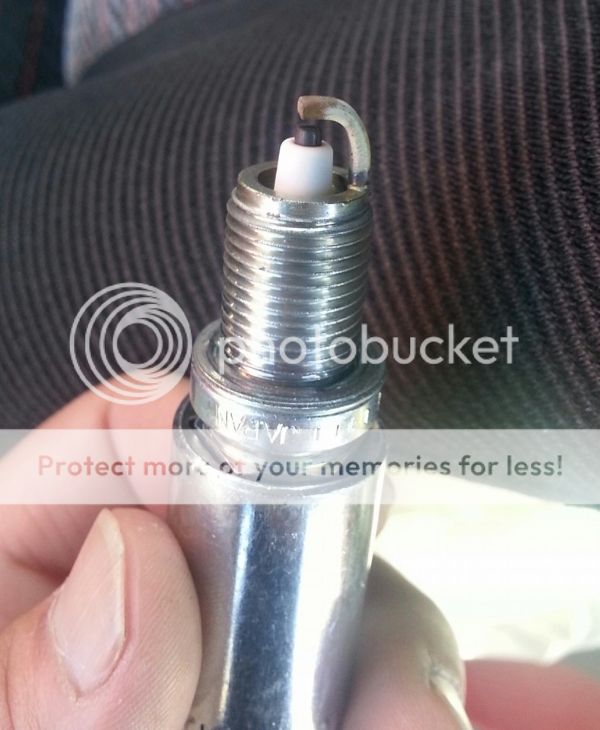

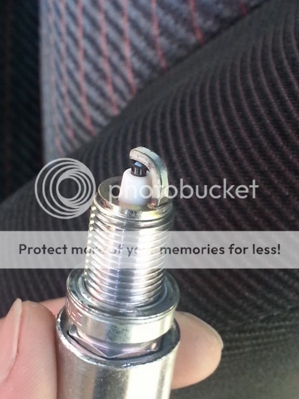

Just wanted to contribute to this thread sinced it helped me. I did a 3rd gear pulled with one sparkplug ground tip sanded and one left alone. Here's my finding:
Cylinder #1 (Sanded Ground Strap) Grey Tip with Gap
Cylinder #3 (Un-sanded Ground Strap) Brown tip, No Gap
What i did was changed to new plugs at a secluded area & warmed up the new plugs for abot 5-10 min. Did a wot pulled in 3rd gear and shut off coasting to a safe stop area. Then read plugs. Needs more fuel & maybe 1*-2* advanced ignition timing. AFR was about 13.0
Motor: LS
B16 pistons
Crower 404 cams
Rev 7.8k
afr 13.0 @ wot

You need to sand the tip down more. Needs to be bare metal. You still have the coating on the tip in both pics
