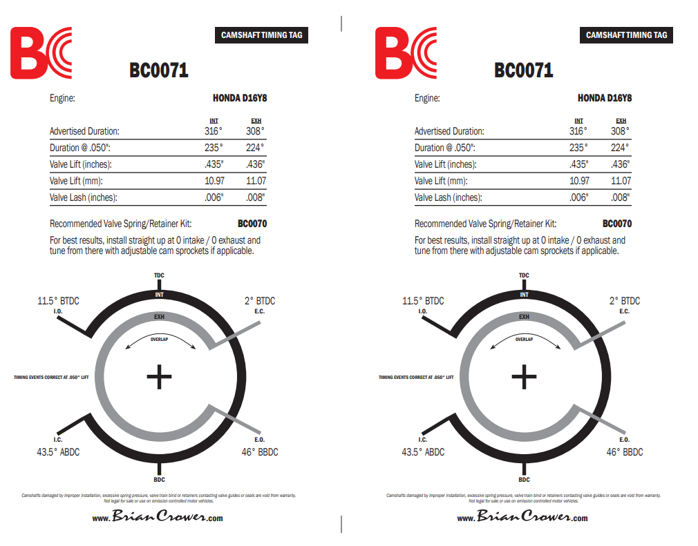

Quick quest as well. The guy installed all of the parts and the aem cam gear is at zero. That's correct as it's drop in?

yes, looks like zero is the best place to start for that cam
BC Cam Stage 2
