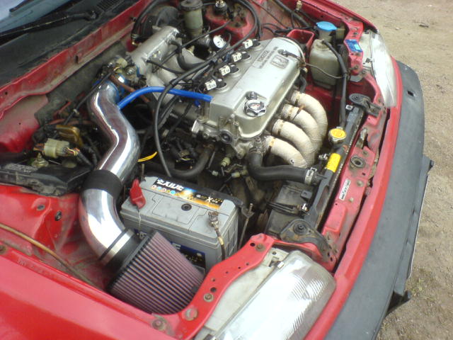

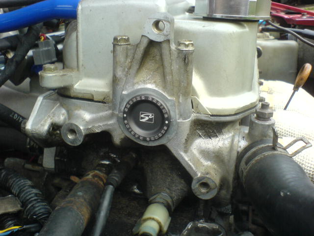

so do you feel C.O.P. are worth it? in sense there's a member from another forum that used VEMS and ran CBR600RR cops and elimated the distributor in all. here' pics of his engine.

It all depends on the power goals etc. I wish every honda came with COP technology.
