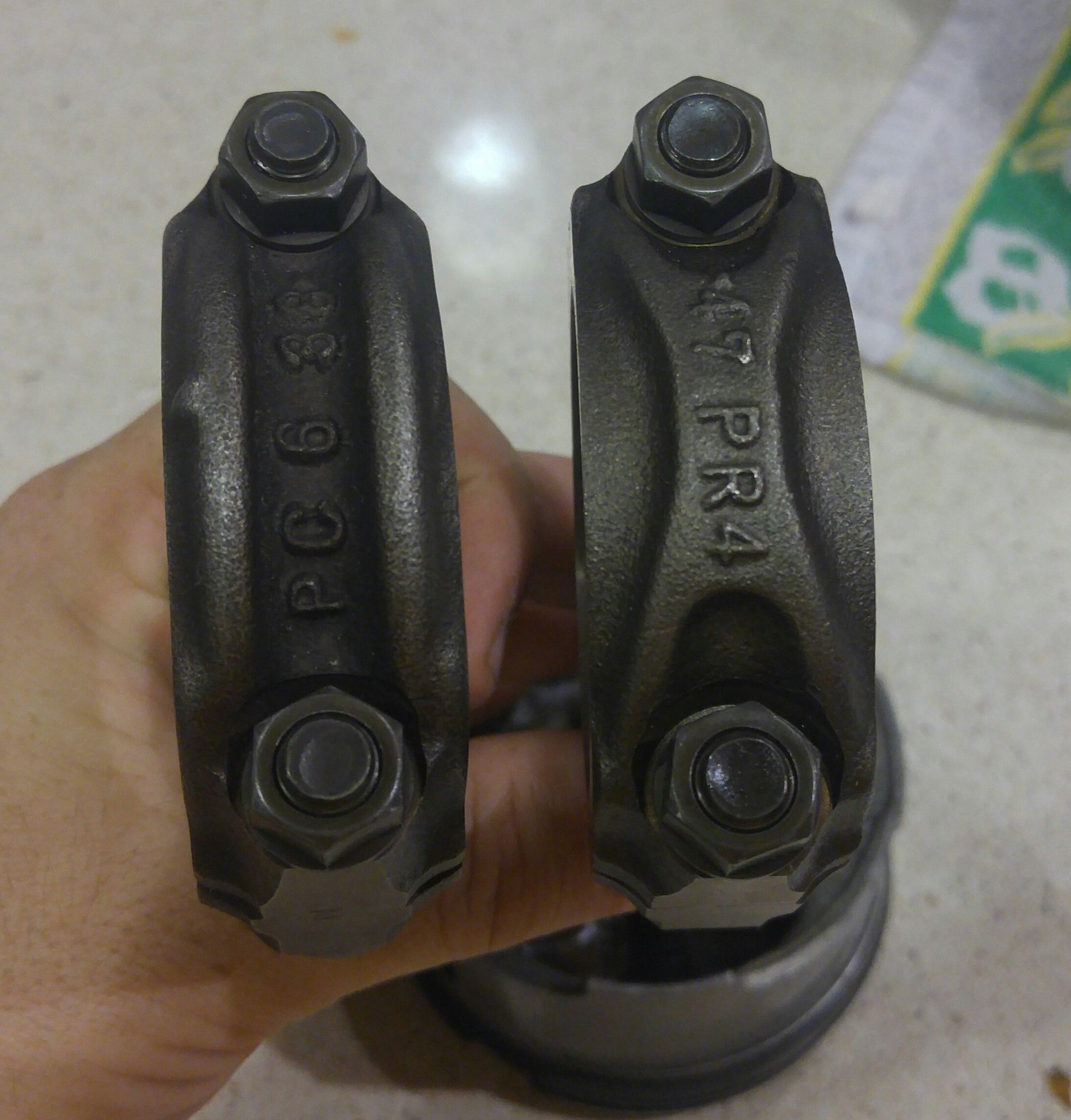

Then to ask a dumb question.. If I am doing ARP bolts and the rod needs to be corrected anyway, would swapping rod caps be plausible so that I can then do this to lighten them?
My rods have the support of the rod cap on the outside as 2 'ribs' rather than the single thicker rib down the middle. So turning it down would severely weaken it.
I could provide pics if you like...

Yes pictures would help. Typically when doing the ARP rod bolt upgrade the rods are also shot peened which adds strength to the rod.What rod caps are you going to try and use? One more question what is your end goal like application this is going to be used in

Now about the rods, here is the pic. The left is my A20 with the cap reinforcement on the outside vs the PR4's central strength. I already have ARP bolts and planning to peen them.

Do you have the A20 yet. If so I would strongly recommend taking the crankshaft to a machine shop with the rods so it can be precisely measure. Even for the rod width between the journals. Awesome plan though my first car was an 1986 Prelude SI with the BT2 2.0 12 valve. It was a super fun car and handled great.
