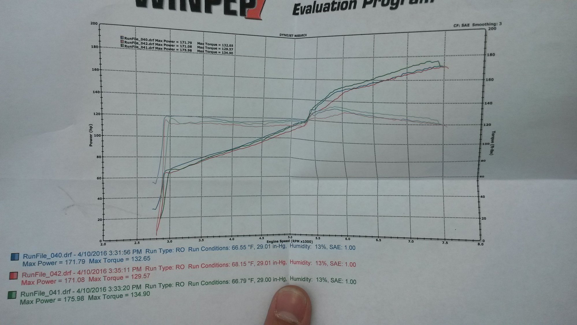

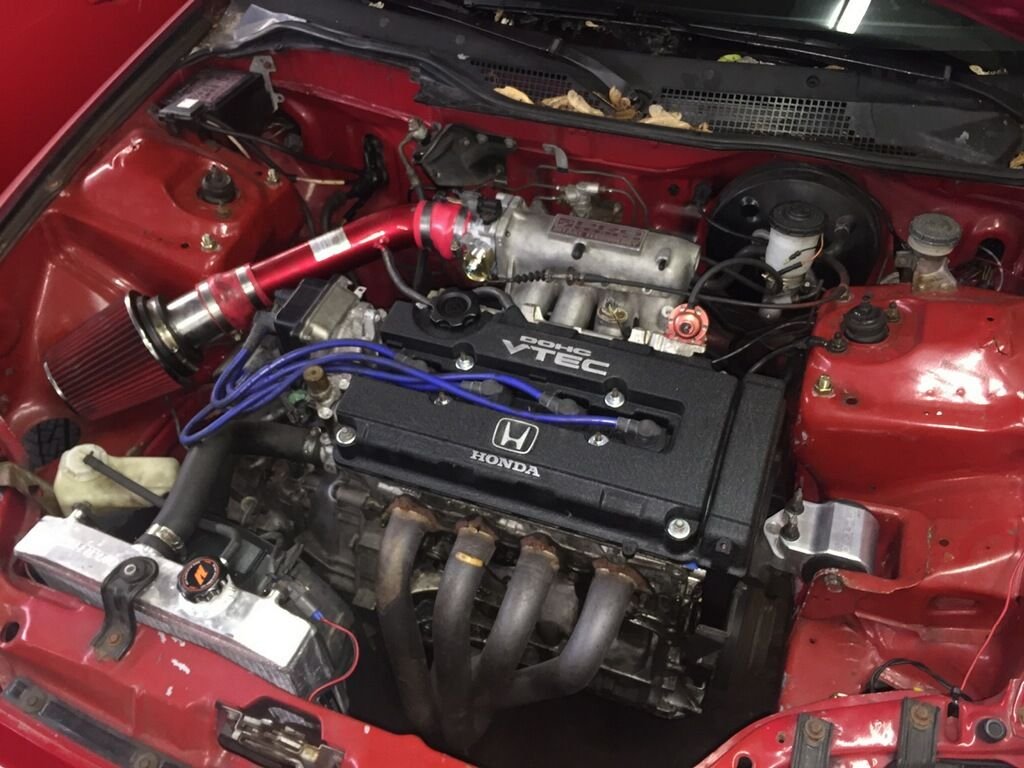

Default My b20v dyno numbers
Got the motor already built but apparently had Crower Cams and 11.1 pistons but I have no paper work to back it up so this is what I know and what it made on a DynoJet recently. (Don't have a recent pick of the bay)
-b20b block
-b18c head
-skunk2 pro series intake mani
-70mm skunk throttle body
-short ram intake/aem filter
-aem adjustable fpr
-stock fuel rail
-stock gas pump
-dc headers
-cat delete/yonaka exhaust quiet
-buddy club adjustable cam gears
