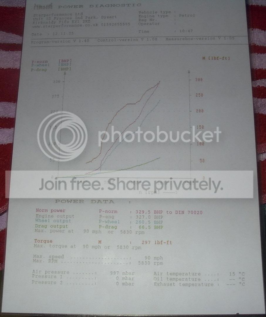

Are you sure you car makes that type of power? SR20's are nice motors but yeah, I think you are making something more like 270-300 on that puny turbo. On 15 psi at least. If not , nice numbers.

And a picture of the last dyno. run (at 12 psi)...
We got to 5830 rpm and it span the tyres in the rollers...

i dont think the point of the OP's thread was to argue about how much power he's making.
