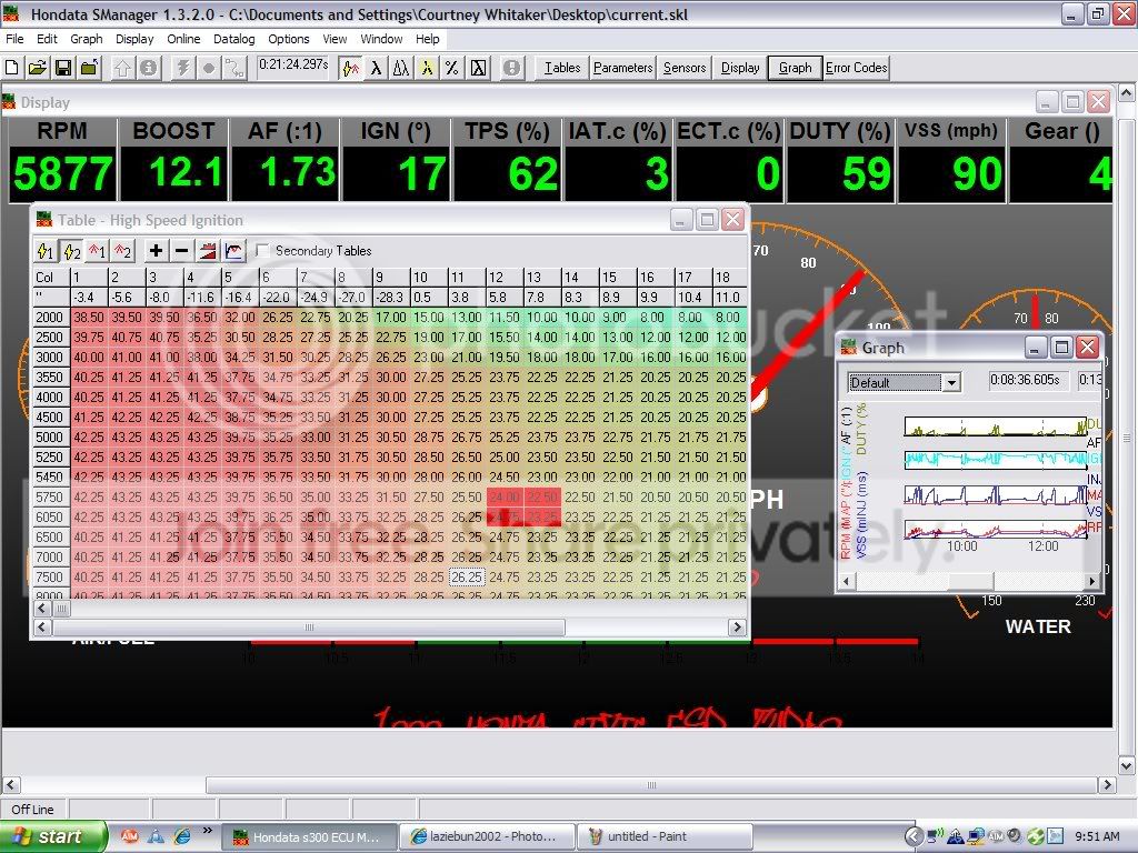

well i checking out my datalog, and notice somthing that seem wired to me. Notice how the boost is at 12.1 psi and on the matrix its showing me that im at column 12 and 13 which is only 5.8 and 7.8psi....any one might have a clue on this one???

Can you verify if your Sensor Setup for Map is psi, or "/psi ?
go th View/options/sensors/map and see what its displaying in Units..

its in "/psi...............

Uh, what the hell is going on with the vacuum numbers? It goes from less to more vacuum from columns 1 to 9, then jumps to 0.5psi boost. It looks like there is something majorly wrong going on with your map...
You may want to post the map and the datalog so we can all look at it. If you need, I can host them for you, just email them to me at blakebonkofsky@geektuned.com.

He has vacum setup as absolute, it should be set to atmospheric.

Yup thats was the probelm with that (thanks), but still having the issue with 12.1psi hanging around 12 and 13 column.

At the point, not trying to sound like an a$$, but you really need to get your car professionally tuned. Your map is still wacked out like it was when you initially posted the map way back. I have no issues on my end viewing my own Maps and datalogs, I'm sorry to say but you should not be boosting on this map..
As for your Map sensor not sync'n to Table vs display. I suggest you contact Hondata and ask them on their support website, or go see a tuner for troubleshooting. Settings etc.. look ok.

under map in parameters, there is a voltage to pressure conversion. what do you have the scalar and offset at? i looked mine up and they were 862.4 on the scalar and -431 for offset

The only thing I can find, is that the values do line up when selected secondary maps, however, the map has these maps disabled, so I'm not sure why this is happening.

Yup setup just like yours

what's up with the map scaler going to 16psi only in cell 24? normally that would be like 60psi under 5bar mode. Looks like you did the add load index and datalog is confused, aka its maping to the standard index versus your created indexes.
aka, if you had the standard load index, column 12 & 13 would be between 7.8psi and 12psi.

seen4ever that the funny thing it works in secondary table....

Potential bug/discrepancy, or your map is so jacked up its melting the daughter board
