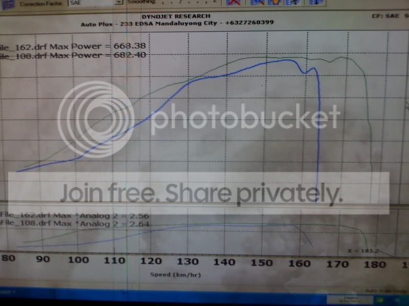

ralph11sec's Avatar
Posts: 777
From: MANILA, PHILIPPINES, philippines
Default Re: missfire problem on stock ignition
here's the dyno...
the green = s366, blue = s372...
as you can see, the blue graph didn't get to rev higher. (thats about 9t only)
we'll try a new dist/ignitor/ngk 9s next time...
btw, this was on 22deg IAT/c16...
what do you guys think this s372 should rev up to? 10t? 9t seem to have narrow powerband...

littlebluecrx's Avatar
Joined: Mar 2002
Posts: 2,459
From: Crofton, Md, USA
Originally Posted by ralph11sec
here's the dyno...
whats the afr doing at the higher rpm?

ralph11sec's Avatar
Posts: 777
the usual...
11.5-12.0
