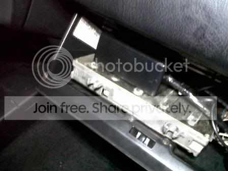

Old Oct 22, 2010 | 05:27 PM
SSVTi's Avatar
Posts: 30
From: Tilburg, The Netherlands, NB
Default Re: Ignition issues
I'm also using the M&W Pro10 with the Ps92 Coil.
Does anyone knows a trick to make the oem tach work with this combination? The M&W tach output wont trigger the oem tach.
I've also tried to trigger the oem tach off the ignitor output. But this didnt work eigther...probably because the ignitor will only send a tach signal if there's a coil hooked up to it.
