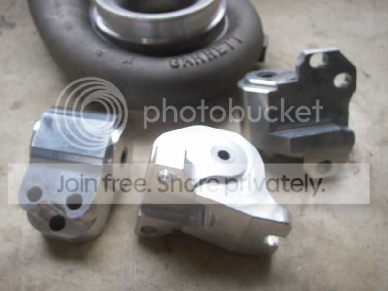

<TABLE WIDTH="90%" CELLSPACING=0 CELLPADDING=0 ALIGN=CENTER><TR><TD>Quote, originally posted by Turbo-charged &raquo;</TD></TR><TR><TD CLASS="quote">
It looks like the tranny mount bolt holes are elongated.... are they like this for a reason? I would imagine it allows for alignment of the motor/tranny....
Also what material is pressed in the center of the mount where the bolt travels through?
Old Oct 5, 2007 | 02:12 PM
  #39
CustomX113's Avatar
Banned
Posts: 824
From: N/A, MD
Default Re: (tepid1)
<TABLE WIDTH="90%" CELLSPACING=0 CELLPADDING=0 ALIGN=CENTER><TR><TD>Quote, originally posted by tepid1 &raquo;</TD></TR><TR><TD CLASS="quote">
It looks like the tranny mount bolt holes are elongated.... are they like this for a reason? I would imagine it allows for alignment of the motor/tranny....</TD></TR></TABLE>
you sir..... are correct

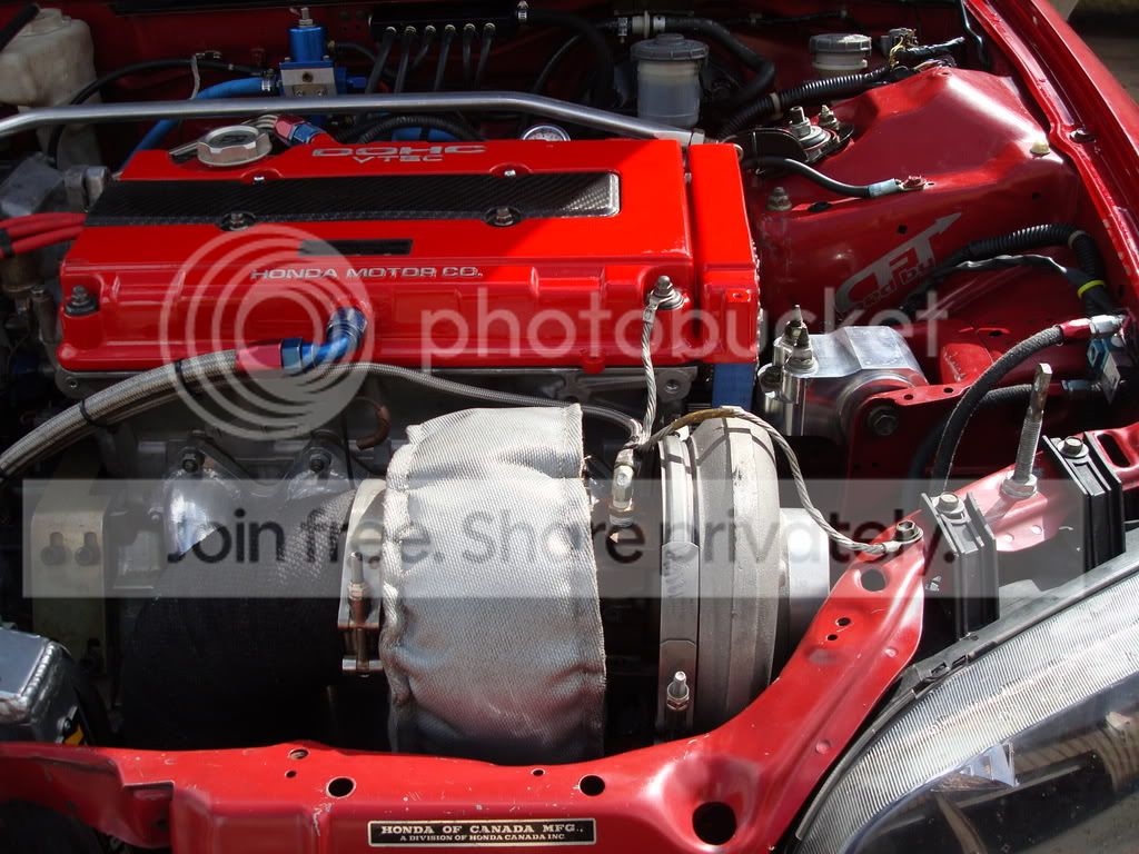

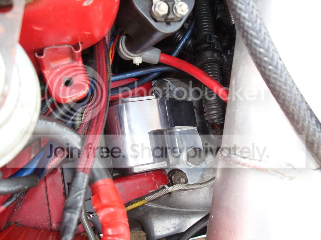

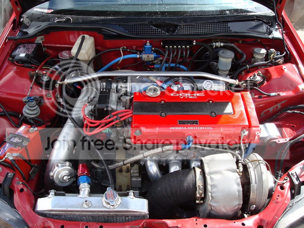

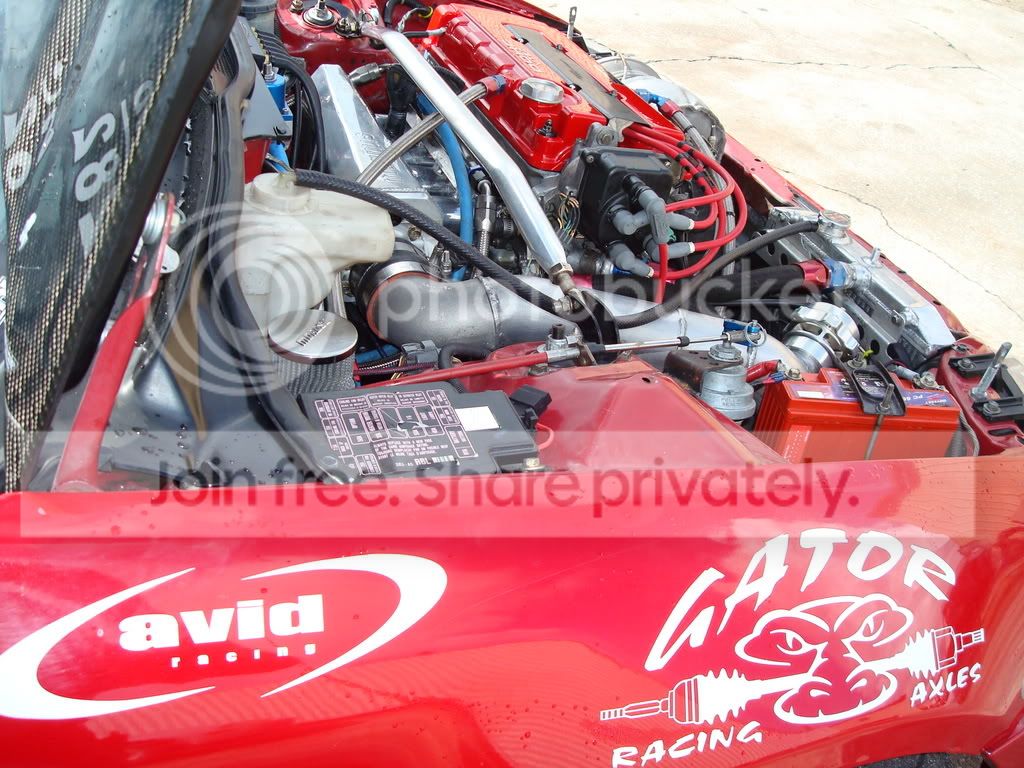

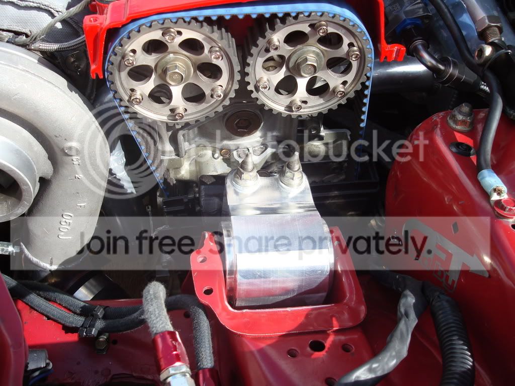

Hey, everyone. Here are some pics of it on CFT's SFWD, this is just right before they left for e-town. There are quite a few people running are new Pro-series mounts this weekend, so watch out for it. We will be having many applications to come. Next will be for the EK's... Good luck with everyone in E-town and we'll see you there.
Hope you everyone like's the pics. I'll have more pics from e-town after this weekend. Thanks to the boyz @ Tempest Racing for posting the test.

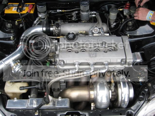

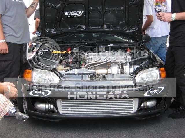

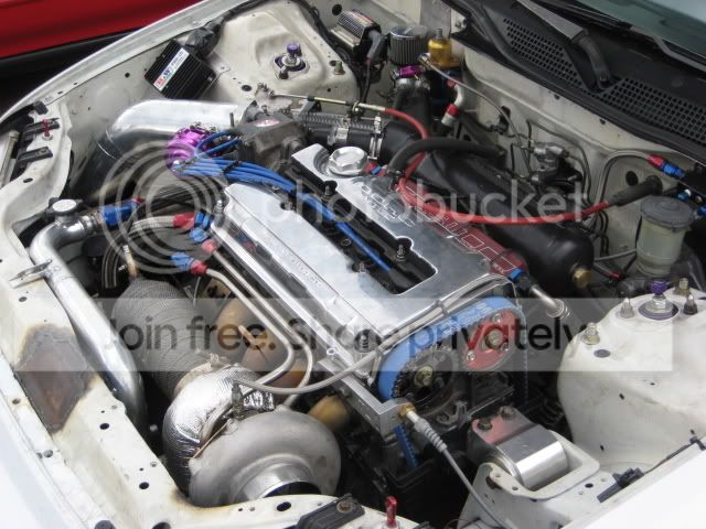

Here are some pics from over the weekend from E-town.
I love Courtney's engine bay, damn that **** is clean! 9.3xx Crazy!
The boyz from MB racing in action this weekend
These were some of guys running are Pro-series mounts this weekend.
