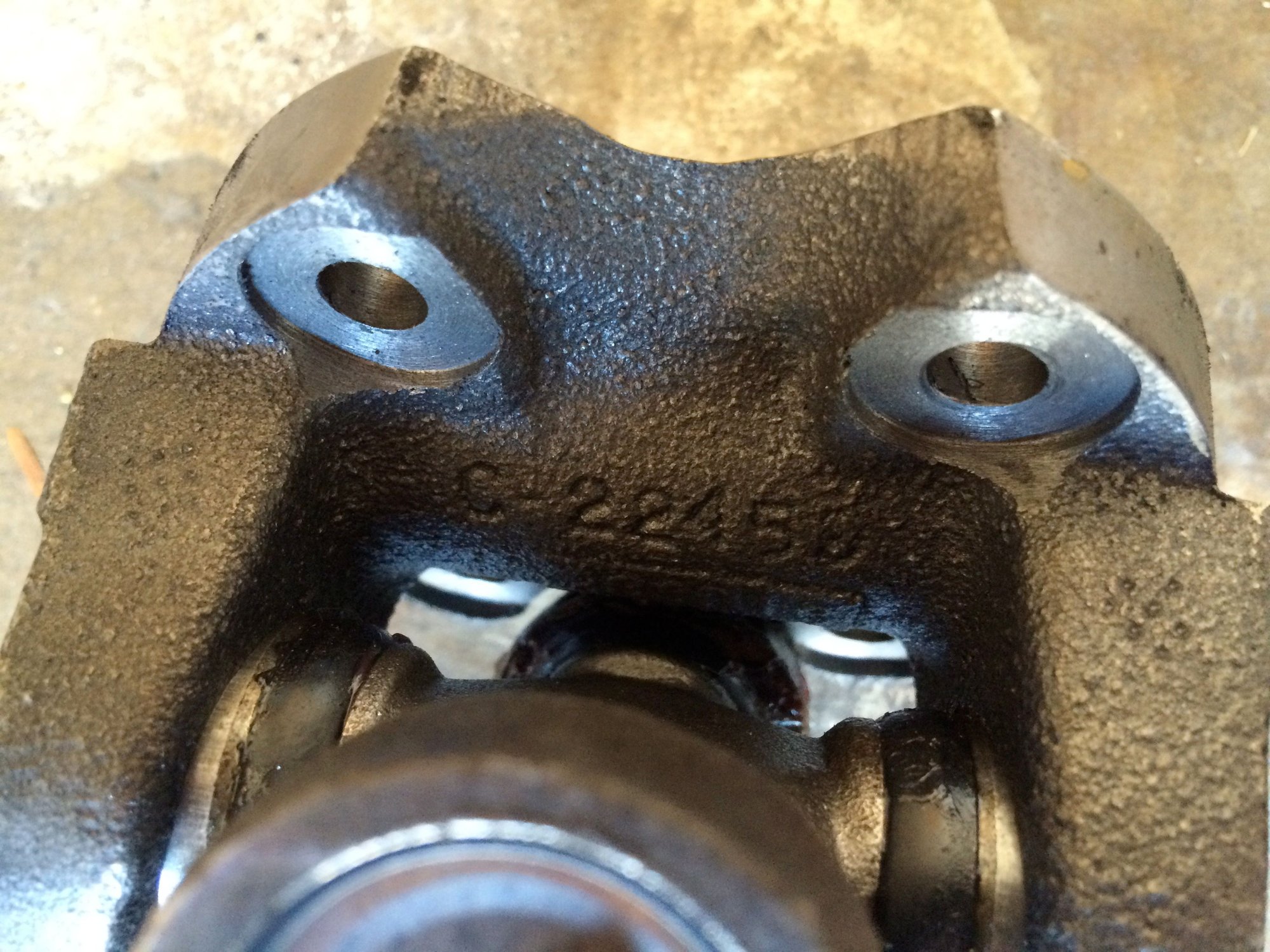

Originally Posted by tony_2018
weak *** joint...
Yep, and about the size of my thumb.

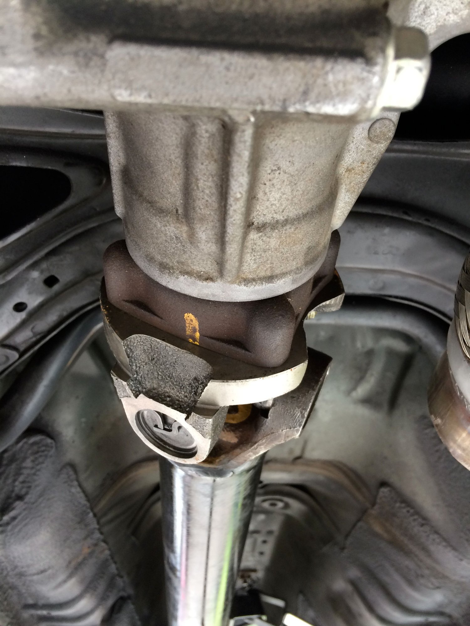

The U-joints fail stock with everything mounted and angled properly?
What will you do since you are not near stock?
What you guys didn't read from his previous post was that, he wants to do it his way. The correct way would be to order the proper rear sub frame, remove current rear subframe, weld on new subframe and be done. Get the proper lca's as well.
Thank you, I do have a plan. If it doesn't work, then the plan changes. Yes this is one correct way to do it, but not the only correct way. And there are no "proper lca's" for this set-up really. LCAs are not the problem. Maybe you mean RTAs in which the only available ones to us here are from the CR-V or the '87-89 Civic RT4WD. The CR-V RTAs are huge and would require you to completely remake the rear strut towers so that you can move the mounting points to the rear. The Civic RT4WD RTA's are too long requiring one to have to cut a section out of them and weld them back together to fit. Either way you are talking about a lot of custom fab work. There's no easy way around this unless you can actually source RTSi parts, which I cannot.
They sure do! Short of pulling a rabbit out of my ***, the guys at the driveshaft shop have some good ideas. They have been in the business for a very long time now and are pretty resourceful. I'm not the only one that's ever walked into their shop with crazy expectations...

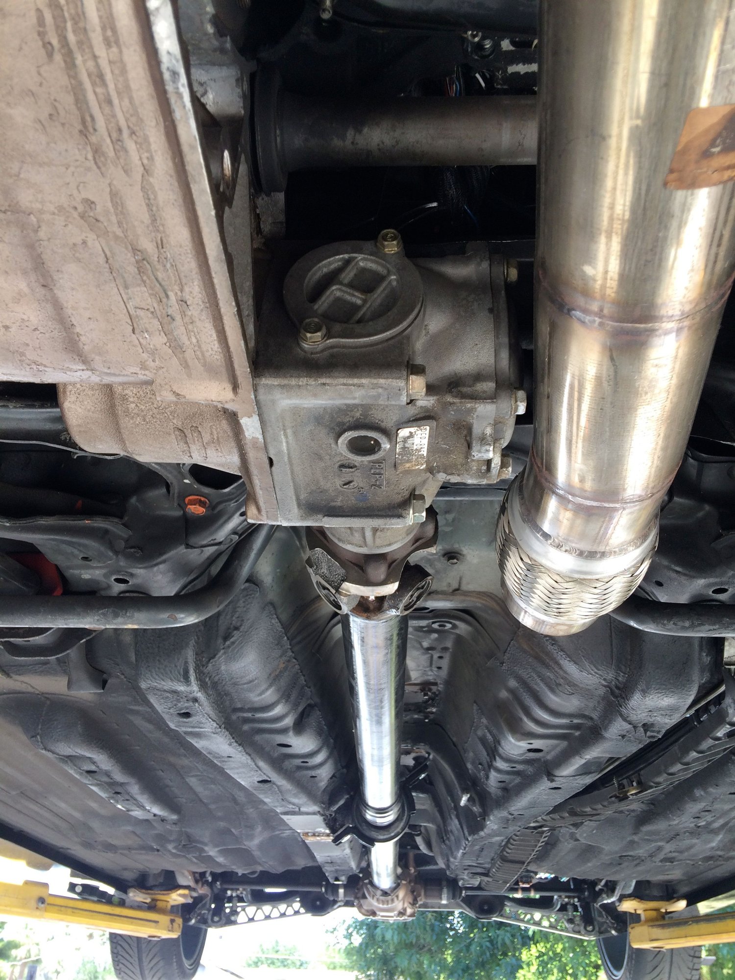

OK, let's get back on topic here. Picked up the driveline today and if this works out, I'll be pretty impressed with this driveshaft shop. So they were able to utilize the CR-V driveline, which is great news to start with. This saves me some money, keeps the mounting points the same, and allows me to use as many Honda parts as I can, which was one of my goals. Granted this is now a "custom" driveline, but it's the thought that counts. What they ended up doing is using replacement yokes, u-joints, and flanges for a Chevy 1/2 ton. Luckily the CR-V flanges have a pretty common bolt pattern that is also the same as the Chevy 1/2 ton. These things are huge compared to the stockers, I mean way bigger. I forgot to ask for the stock u-joints and flanges back so that I could do a side-by-side comparison. I put a quarter in one of the pics for comparison. The stock u-joints would have fit a dime in the same place. With the integration of these new u-joints, they were able to set-up the driveline to compensate for the 3/4" that I moved the diff back, which means the center CV joint of the driveline will once again be in a good location. Like I said, I really had my doubts about the factory u-joints and for good reason. I am feeling a **** ton better about these joints, so lets get the this thing installed and see what it can do... And what else we can break...

Looks good, def looks 10x better.

Got the driveline installed. Everything fits nicely and looks much stronger. I had to get some longer bolts as the flanges are much thicker. Made some driveline loops too, which I should have done before. Safety, safety, safety. Took her for a little drive and everything seems to be in good order. I drove her very, very lightly. I only got her up to about 50mph and accelerated from a stop a couple of times. Nothing crazy, just wanted to make sure **** wasn't going get shot out of the back of the Civic. The tags are also expired and I don't have any insurance on it, so I really couldn't do too much driving. First impression though is not bad. The rear end is a little noisy when the diff is locked, but that was to be expected with the way I mounted it. It does feel a little funky when I try to turn into a driveway with the diff locked. I'm sure if I tried to do a u-turn or circle with the diff lock it would feel really funky. I don't think anything is binding. It's just that the rear tires can't turn at different speeds. The nice thing is that I can turn off the locker and it feels like nothing is back there. I've also been driving and turned off the locker, and it feels like I just unhooked a trailer. Definitely a drag with the diff locked. Well, maybe I shouldn't say that. I only notice it when I unlock the diff. I'm sure things are out of alignment too. I'm really hoping everything in the rear comes into alignment. That remains to be seen. The clutches in the diff seem to be holding very well with the locker on. Only takes about 3-4 seconds for the pump to fully lock it up, so it's quick. Like I said I really didn't get on it and am just babying it at this point. For now everything is working, so I am very happy with how far we have come. I will continue to drive it more and more each time and get on it harder and harder. Still so much left to do until this project is done, but this is a huge stepping stone. HUGE!

Looks good, but exhaust trying to kiss trans. Maybe a heat shield between them?
LOL, welcome to the world of CRV issues. I have ran it both ways, with wrap and without...
Anyways, DarryCar, the drag you feel when you have the TCD unit locked is absolutely normal. Welcome to the power robbing RT4WD driveline. You are just lucky you can unlock it at will. IIRC - From what most have seen, with the driveshaft installed there is typically a 10 - 15% whp power loss versus without the driveshaft installed (in your case locked / unlocked).
The sensation you have when turning while locked is normal. Your rear wheels are turning at different rates due to the open diff in the rear, but the sensation you are feeling is due to not having any front to rear speed slippage due to air locking the clutch pack. The normal design would only be activated when the fronts were slipping so you wouldn't feel this with a stock TCD unit. So when the front and rear tires aren't slipping then something has to eat up the slip differential that needs to take place. This is a result from the wheels being slightly overdriven and same size tires front and rear being used. Basically you are chewing up your rear tire(s) by turning with It locked... haha.
I may wrap it or ceramic coat it in the future. Long ways from there though.
I knew there would be some power loss with this set-up, but what I lose in power I think I will make up for in traction and then some. It will be interesting to see what it puts out on a dyno. I'll be able to do pulls in 2WD and 4WD, so I should be able to see exactly how much power loss there is! Didn't even think about that till just now. And yes it is nice that I can unlock the rears. Saves me some tires in the turns and some gas on the highway.
I've gotten on the Civic just a little harder each time I drive it and man, what a difference! It's like night and day! Even with shitty as old tires this thing is gripping and moving out. Still babying it a bit as I want to make sure nothing is coming apart on it. I was thinking I may try to put some sort of bushing or something in between the top mounts of the diff and the cross bar just to give it a little bit of a cushion. Not sure what as this may throw off the geometry of the diff and driveline. I feel we are getting there though. So far so good...
