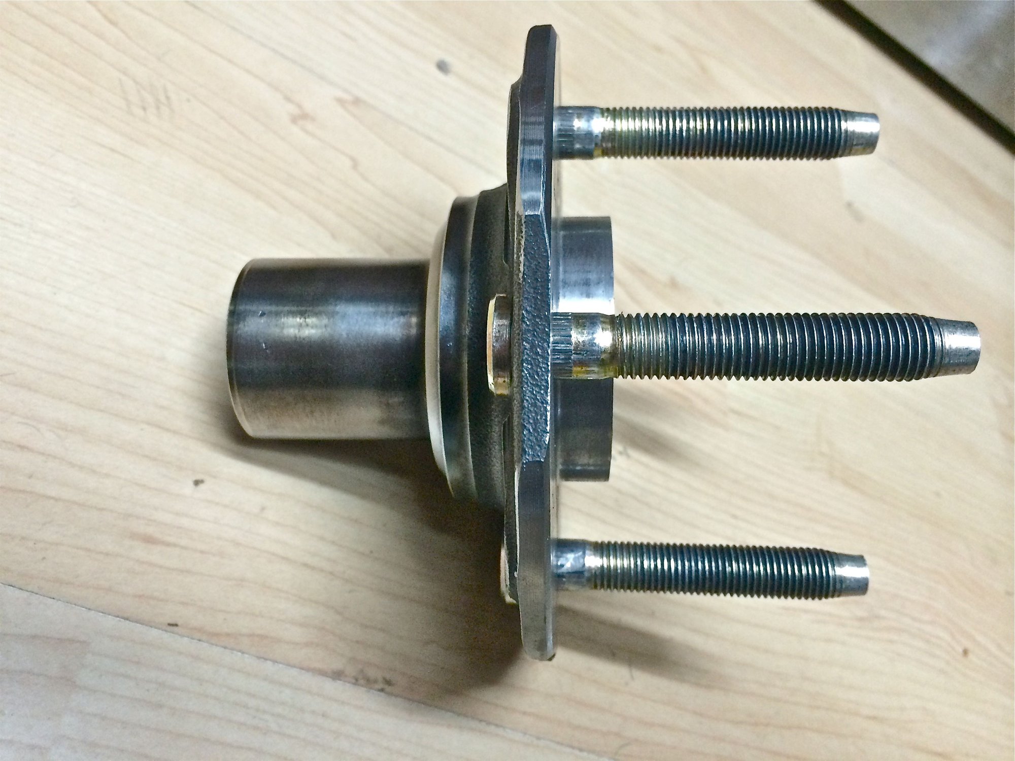

For now the plan is to use the CR-V hubs and rear axles. I do want to see how much they can take and where the weak link is. Other projects that I have studied have had success running the CR-V set-up, but ever build is different as you may know. Looking at how small the rear axle shafts are, it's amazing that they don't break under normal load with a stock B20 driving them. I'm sure the RT4WD system has something to do with the longevity and durability of the rear axles as they never truly see full torque output. I will be deleting some of that system, so that will change things significantly.
5 lug rear CR-V hub.
Back side of hub. Studs removed.
Because of costs and I am never going back to rear drums again, one of my goals is to keep this a four lug set-up and retain rear disk brakes. If I went with five lugs I would have to buy a new set of wheels, new brakes, convert the fronts, and who knows what else, so it just makes sense to stay at four lugs for now. In order to do this, the lugs have to be pressed out and all of the holes have to be welded up, the hub machined, and drilled with a 4x100 lug pattern.
No more holes.
Here you can see that the hubs will not fit into the brake rotor hat. the outside will have to be taken down as well as the center in order to properly fit. From the looks of it, there should be plenty of material to do so without compromising integrity or safety. I should have mentioned that as one of my goals in the beginning, SAFETY!!!
Hub is too big to fit into the backside of the rotor hat.
Center section is also too big for the hat.
Front side of hat.
So it is off to the machine shop along with the rotor hats. I do have some ideas on how to use beefier hubs and axles, but for now I am going this route to see how it holds up. Still waiting on the manual transmission and a couple of other toys. Stay tuned...

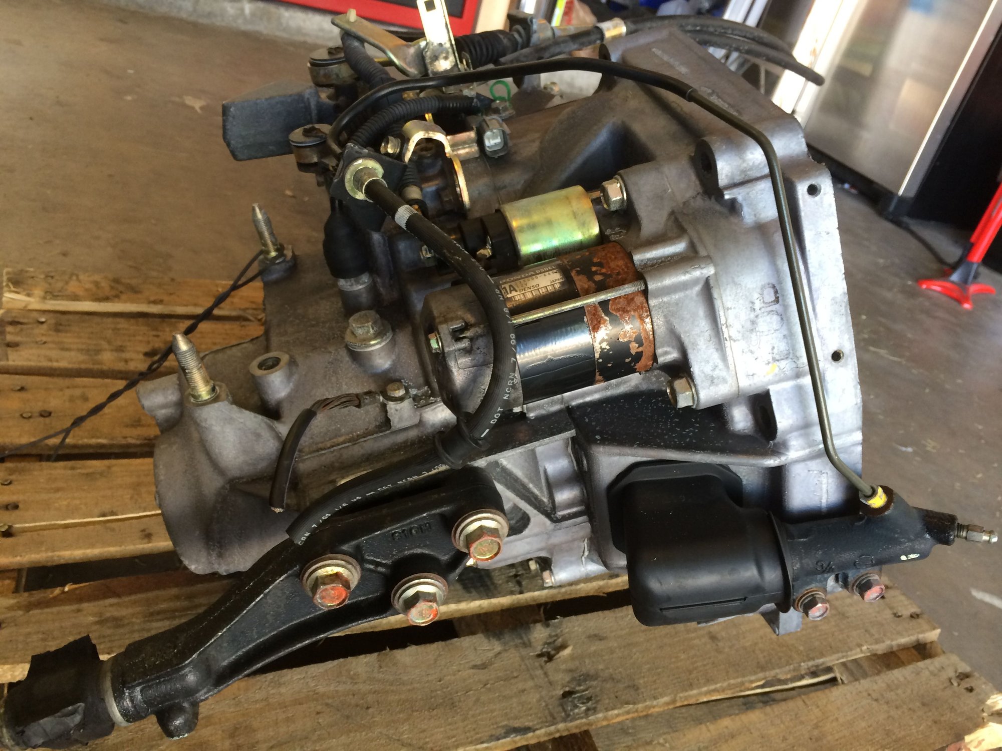

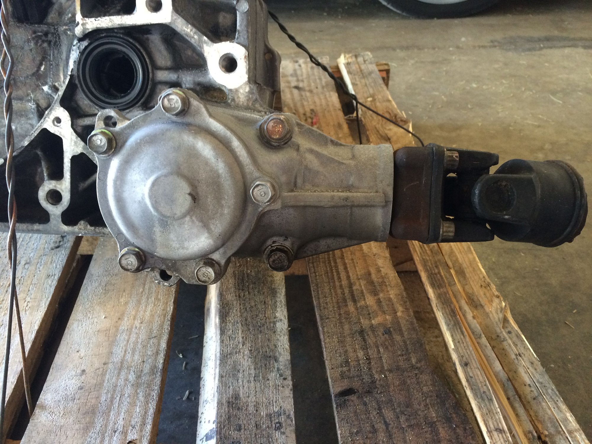

Another piece of the puzzle arrived today. :thumb up: A full sized 16 wheeler came through my neighborhood and dropped it off. An AWD manual trans out of a '00 JDM Honda CR-V. Already you can notice the differences. Because of the use and location for a transfer case, the shift linkage that the B16 uses will no longer work. This means converting to a cable shifting setup. This is where is would have been such a big help to find a manual trans AWD CR-V donor locally. Purchasing the shifter box and cables brand new through Honda is quite expensive. Currently in search for one from a CR-V or something else that may also work. Another difference with this trans is the use and location of the cable shifting mechanism, which moves the starter to the front of the transmission housing. This will require me to have to extend the wires that go to the starter. Other than that it looks pretty much the same. Honda definitely kept things simple.
Cables and shift mechanism.
Transfer case. Gears are driven off a ring gear on the open diff. Hopefully this little guy can handle some power.
Transfer case where shift linkage entered and mounted on a B16 manual trans. You can also see where the intermediate shaft goes.
Starter towards the front of the housing.
One thing I have always loved about Honda engines, especially the B series, is how clean they look. It's easy to clean up wires, delete or hide vacuum and coolant hoses, and remove unnecessary brackets. The B series really is a good looking engine in a world of auto manufacturers that produce unsightly engine bays. I take a bit of pride in keeping a clean engine bay that looks pretty. That being said, it kind of bothers me that I have to now deal with cables, shift mechanisms, and hideous looking starter. I know, weird right? I'll get over it and figure out something to do with it all. Maybe I'll delete the start all together and just push start the car whenever I go somewhere...

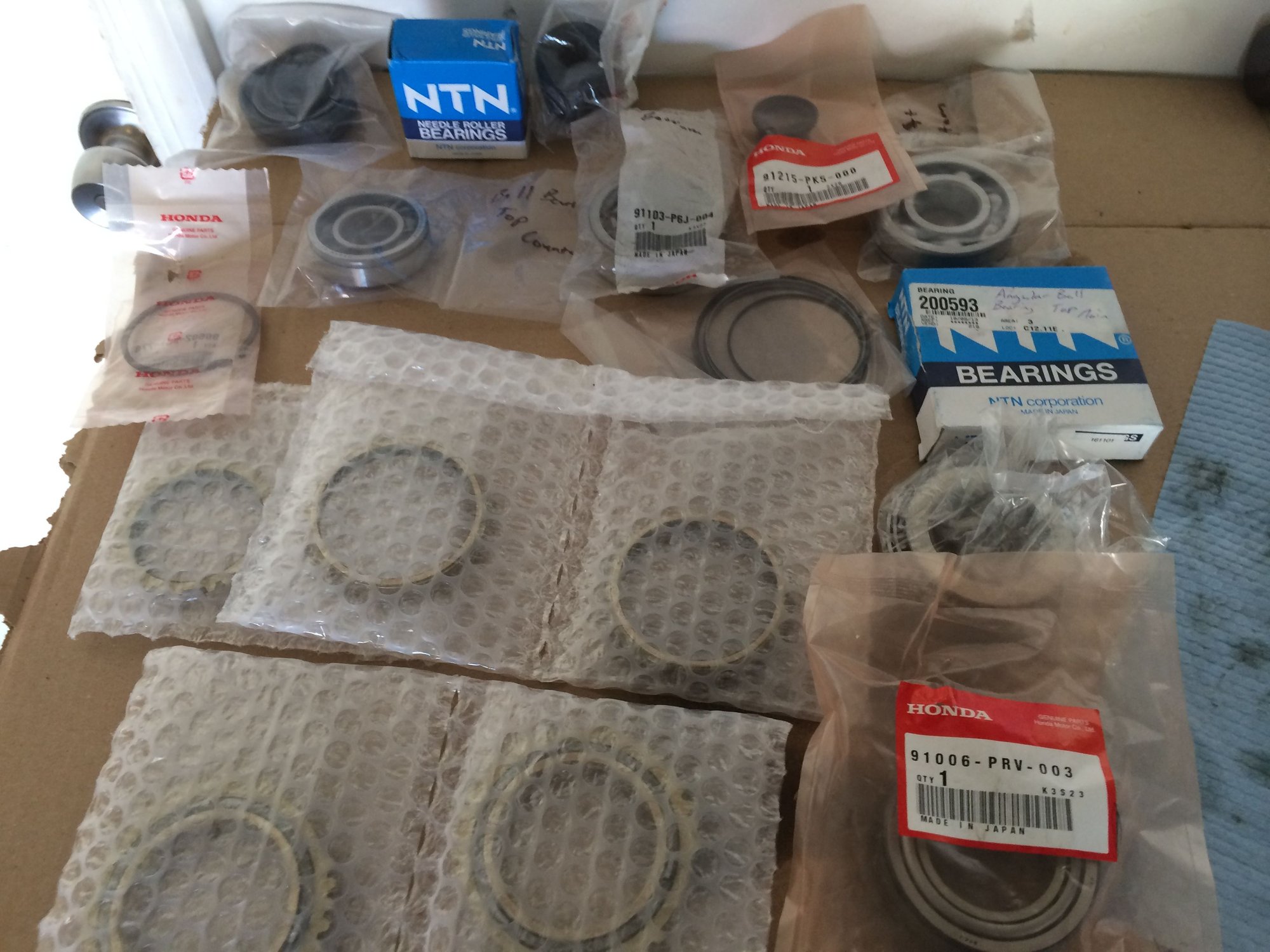

Tore into the transmission over the weekend and things are looking pretty good on the inside. This is good news as I had no history available on it. Not that you see a whole lot of CR-Vs being hot rodded, but you never know. The gears, hubs, synchros, shift sleeves, and forks all looked to be in good to great condition. The little bit of fluid that was left over was free of metal and the magnet was clean. Can't ask for better than this.
A basic rebuild is all I will be needing at the moment. Ordered up all new bearings and seals. I will be installing 1st-5th carbon syncros for added strength and reliability. One of my goals with this build is to be able to run an LSD in this transmission. Having an LSD in my current set-up has been one of the best upgrades I have done and I really can't see ever going back to an open diff and being happy. The purpose of this project is to increase traction in a light weight, high horsepower/torque vehicle. Having to deal with torque steer will defeat that purpose. :thumb down: Luckily for me, there have been some H-T members that have put in the R&D and successfully installed an LSD into the SBXM. I have contacted one of these members (who will remain anonymous, but he knows who he is) and this gentleman is going above and beyond to help me with this project. I mean, a total stranger who doesn't know me and I have never done anything for has offered his services to me without batting an eye. That's pretty special and it shows you that yes there is good people on H-T who truly want to help and see people succeed with their projects. So thanks to this man, I have spent more money than I should have and ordered up an MFactory H22A LSD. Parts should be in soon...

Got some cool stuff today! Not sure if Christmas came late, or early. Either way, happy, happy. Unfortunately this is all stuff that once installed, I will never be able to see again. On the other hand, these parts will make a world of difference when it comes to the drivability of this project.
Rebuild! You know, the necessary accoutrements...
MFactory H22A Helical Limited Slip Differential
So purddy!
I can see right through you.
A bit unnerving to send out a brand new expensive piece of equipment to get chopped up, but I believe it to be going into good and capable hands. I should be getting the hubs back soon from the machine shop. Once I have those in hand, I can start on the Frankenstein rear trailing arms. Stay tuned...

Got the CR-V hubs back from the machine shop. They came out pretty good and fit the hubs nicely. Just need to drill and tap a couple of holes for the rotor screws. Here are some before and after shots.
Before: 4 lug
After: 5 lug
Welded up
Machined and drilled to 4x100
Outer ridge shaved down to fit the hat
Center taken down to fit the hat
Studs back in
Now we can get started on the rear trailing arms. The plan is to build a jig for the Civic trailing arm, cut out face of the CR-V rear trailing arms that the wheel bearing/hub assembly bolts to, bolt the assembly to the jig, and attach it to the Civic rear trailing arm. Sounds simple, right?
