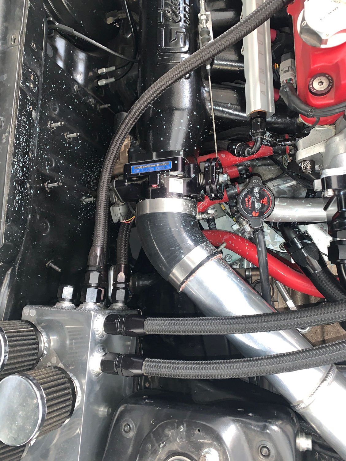

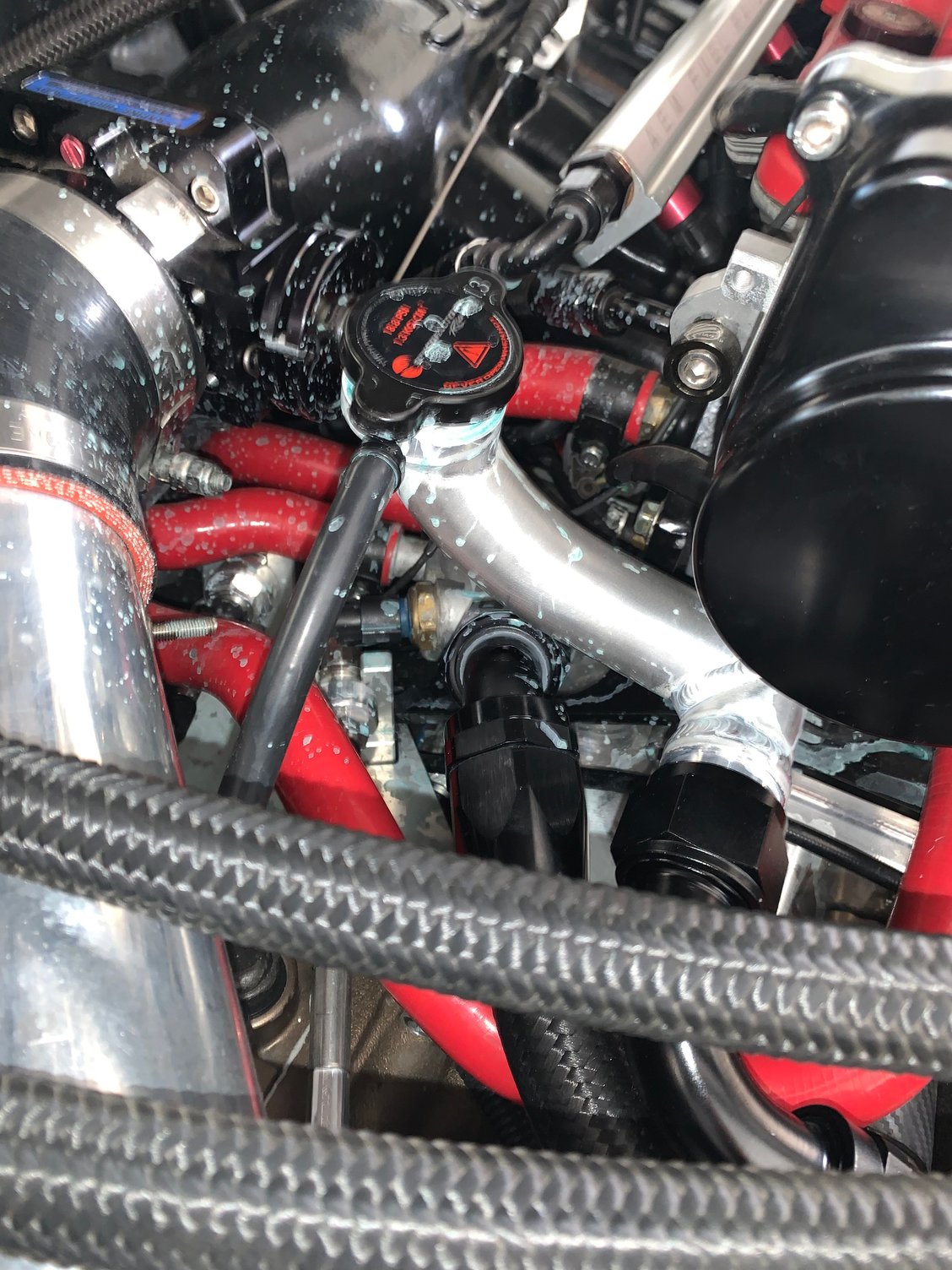

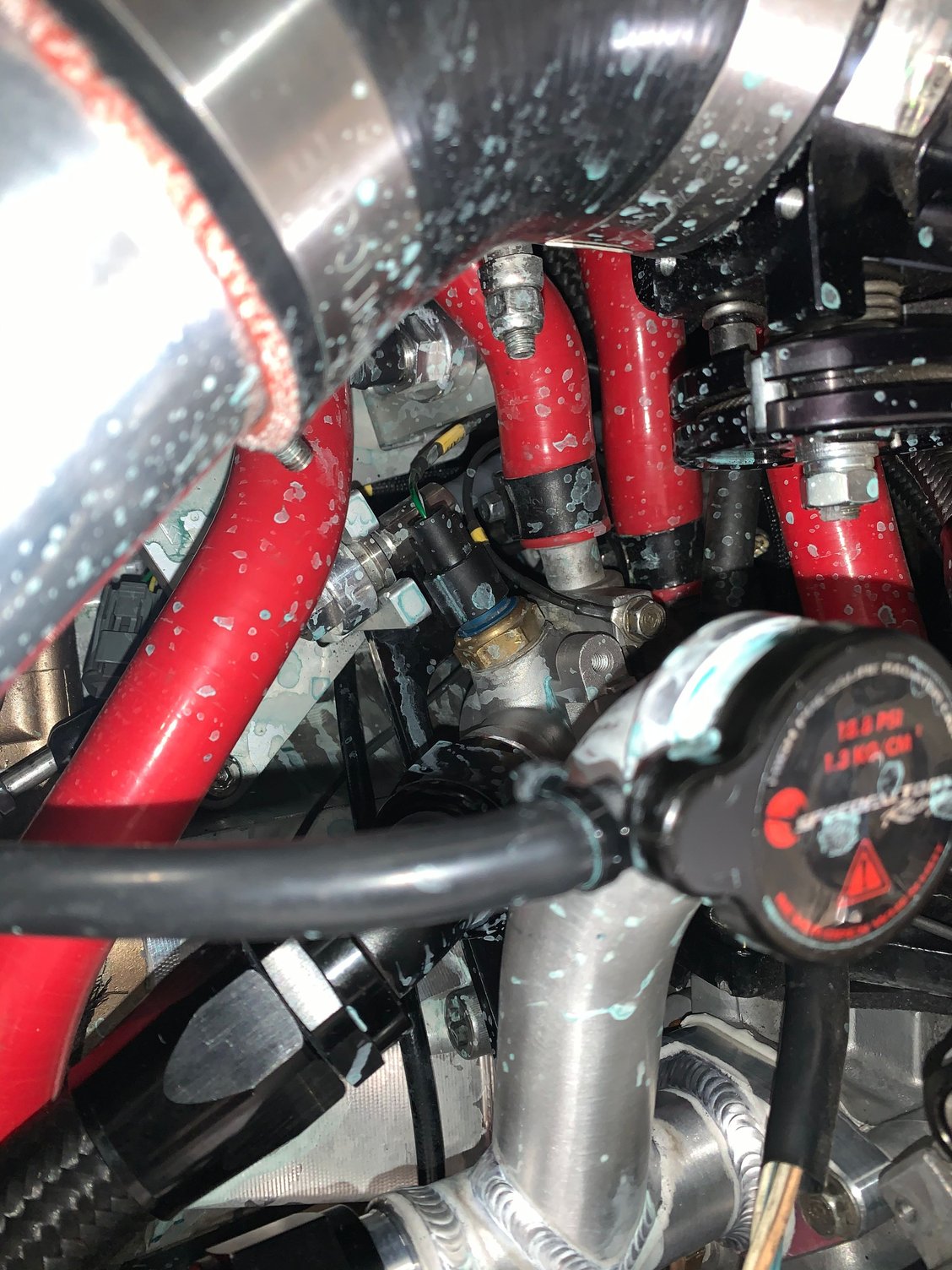

Got it on the road and did a few hot laps. This radiator upgrade seems to be working out quite well. Temp never went over 196F and it is a lot warmer out now than it was in February. When I got home though I did notice a coolant smell outside of the Civic. Popped the hood and noticed a bit of a mess. Looks like the rad cap failed for some reason. Not sure if maybe it just wasn’t seated correctly or what. By the time it cooled off and I got it cleaned up I didn’t have time to take it back out. It just so happens that I accidentally ordered two rad caps, so I have a spare if that is really the problem.
In other news, I went to seal up the transfer case o-ring when I noticed that my hydraulic throwout bearing is already leaking. Now I’ve got to go and take the trans off again, which means pulling the engine to do so just so I can fix that. Always something seems to be the theme here.

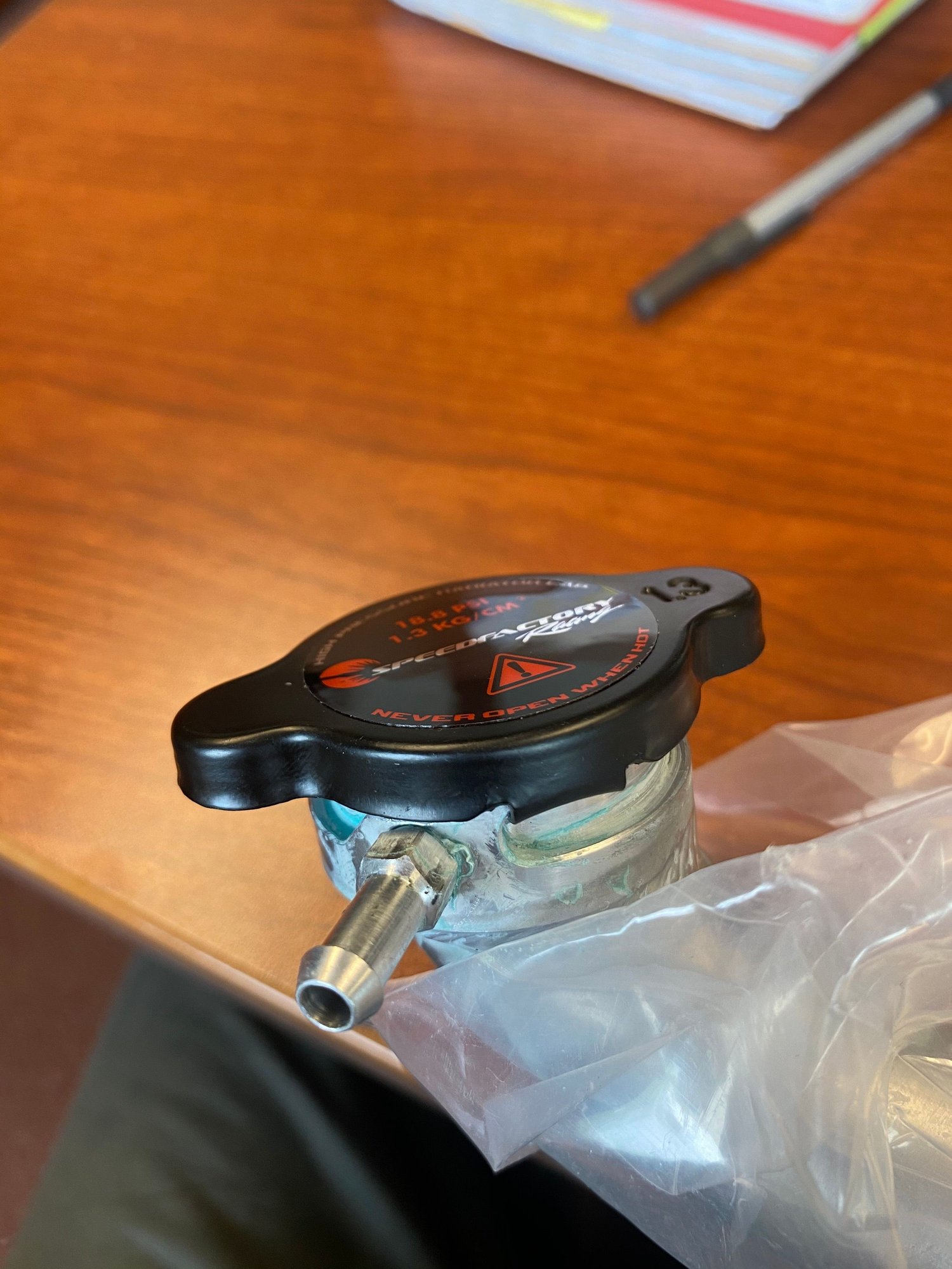

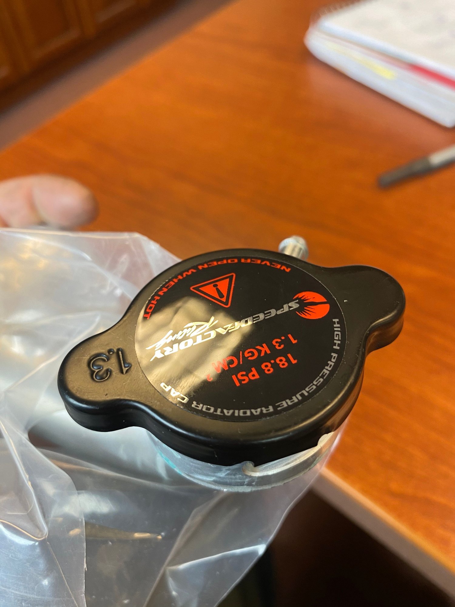

Tried a couple of things and still getting a leak around the rad cap. I can’t get it to do it while the car is stationary. It’s only after I drive it and it’s under load that it starts spitting coolant out. Contacted SpeedFactory and they are sending me a new filler neck. It’s hard to believe that’s what the problem is, but who knows. Maybe they just made an odd ball and I got it. So back to the drawing board.

So I sent them some pictures and they got back to me...... I had a good laugh at myself... Apparently I was not turning the cap all the way. I thought the notches on the cap sat in the grooves of the filler neck. It made sense to me being in that position because the cap would sit straight in orientation and look how the cap on my radiator would sit. But I guess the cap has to be turned passed those grooves, which locks it down tighter, but does not look right. I tired it and it does turn more. I just haven't gotten to test it out yet. So give that a try.

These are the photos they sent me. I had it so the tabs on the cap were lined up with the nipple for overflow can. You can see here that the cap goes past that.
