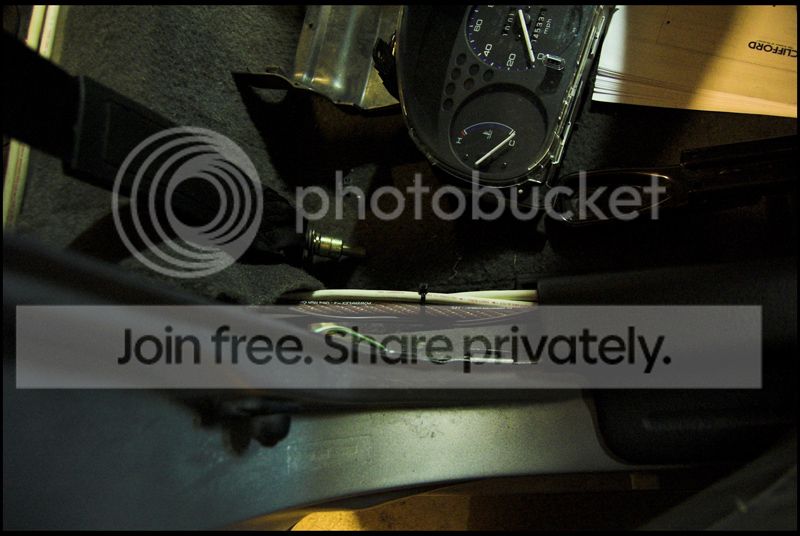

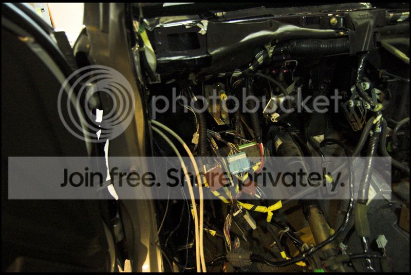

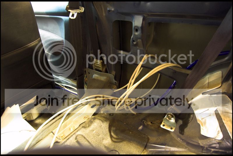

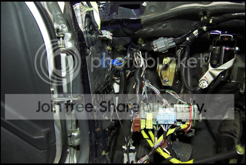

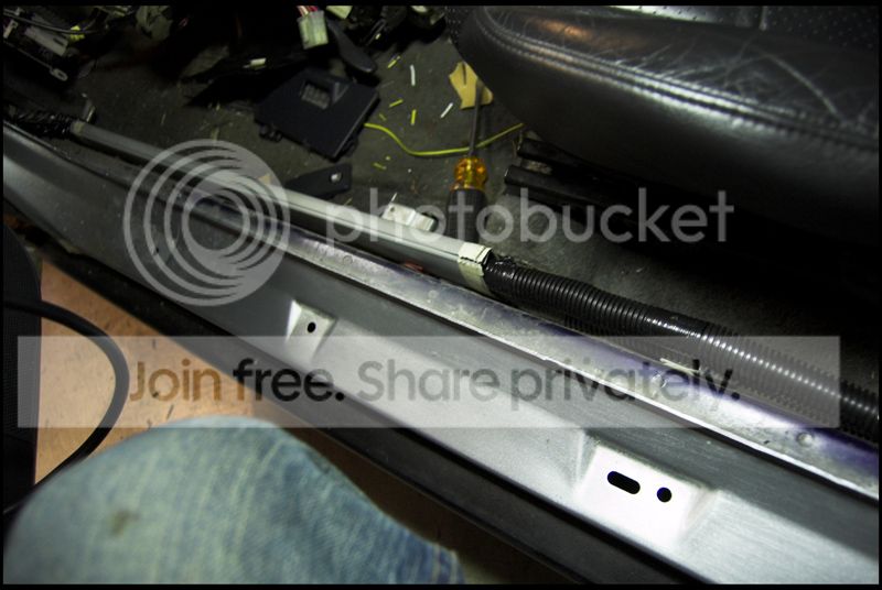

Little bit of an update. Ran the 1/0 back to the trunk, ran wires in to the doors for door locks, and ran dual runs of shielded twisted 14 gauge in to the doors as well. Don't worry I put the grommet on the body and will be sealing everything with some sort of silicone or sealant. Pics -
The thing that sucks is that I forgot to add a hoodpin wire to the loom, but oh well, I'm going to have to run more lines forward for the radar jammer anyways. Tomorrow I'll probably start tagging wires for the alarm.

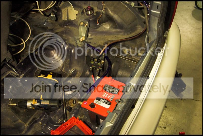

Oh and btw, not sure if I mentioned it earlier or not, but the speaker lines are all ran to the quarter panel because that's where I'm going to be installing the 3 amps.

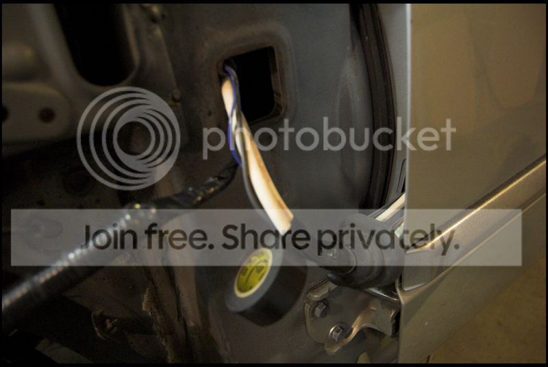

<TABLE WIDTH="90%" CELLSPACING=0 CELLPADDING=0 ALIGN=CENTER><TR><TD>Quote, originally posted by Slain »</TD></TR><TR><TD CLASS="quote">wiring into those doors are a bitch..damn molex connectors..
i always see ppl half *** that part... good to see a thought out install
Well it's about a million times easier with the fender off
Any recommendations for a good sealer? Would some sort of outdoor caulking suffice?
</TD></TR></TABLE>Well it's about a million times easier with the fender off

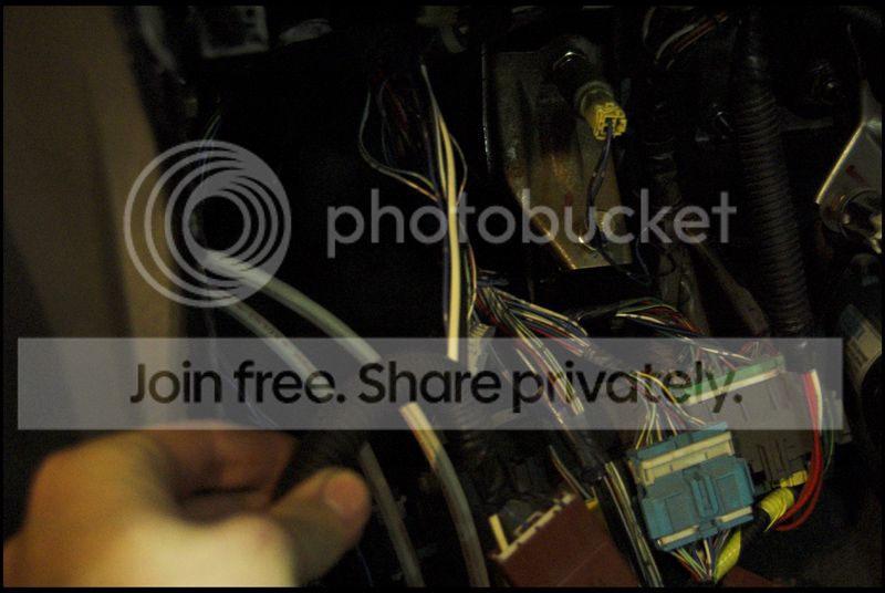

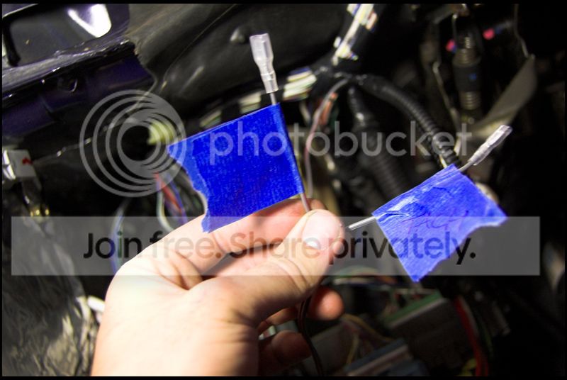

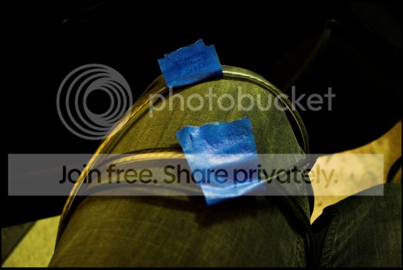

Alright, got some more work done tonight -
Got the other 4 gauge ran to the fusebox, so now I have one 1/0g, one 4g, and two dual 14 guage's ha ha

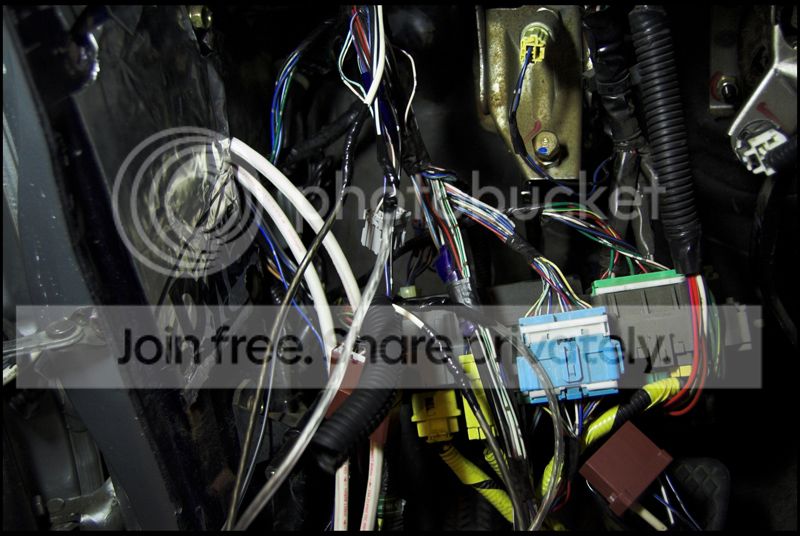

Started tagging wires for the alarm -

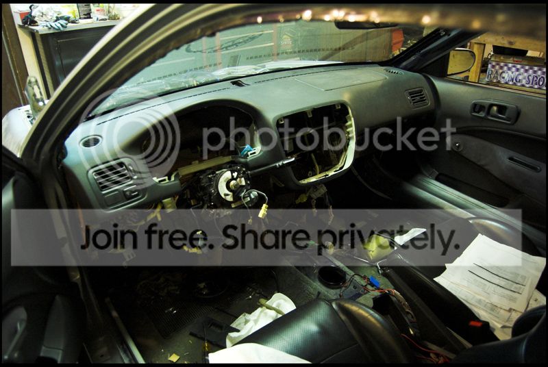

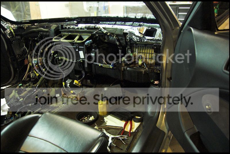

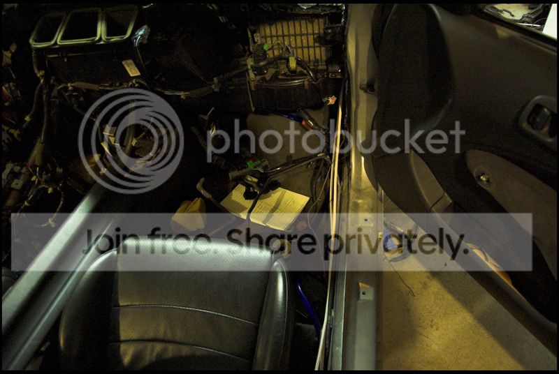

Here's a before picture of sorts -
Cut the tape and peeled back the split loom on the upper portion of the ignition harness. Theoretically this will be a lot harder to get to, but I can't remember exactly how it sits with the dash on. It will look stock, and I main on running a few "extra" wires in to the lower ignition harness just to expletive with people

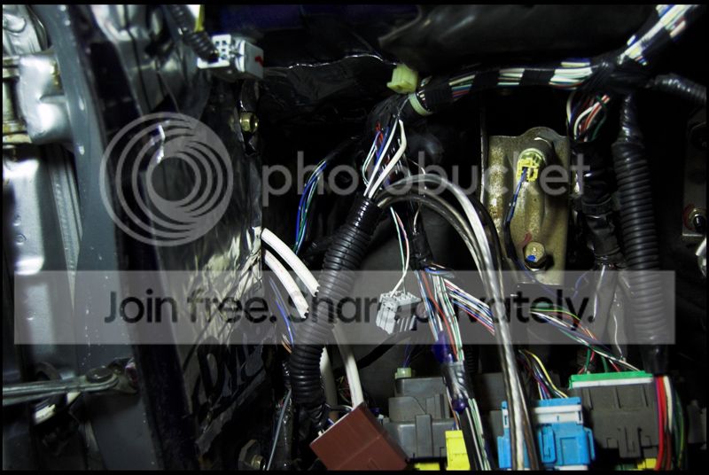

Starting to solder and tape things up -
All back together in the factory loom -
The alarm I'm installing has ignition and starter kill, so that's why there are 4 wires.
Always make sure to tag your wires so you know what's what after you tape things back up. I've learned this lesson the hard way ha ha -
How she sits after getting some other **** done -

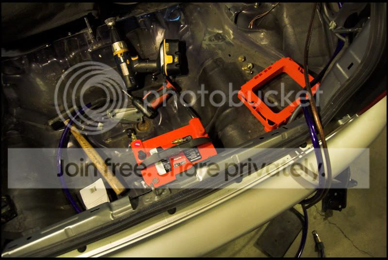

Ok. Time for more.

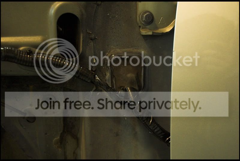

Had to take the fender off anyways, so I took a picture of the sealed door grommet -
Where I started tonight -

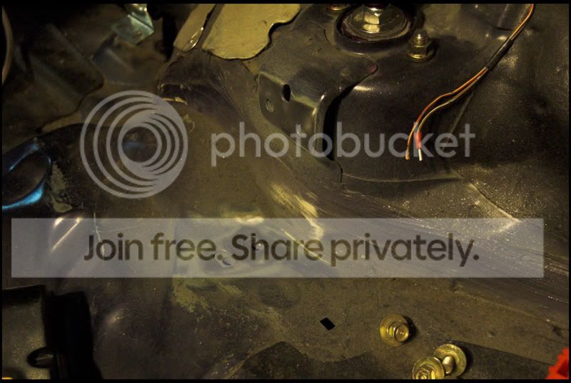

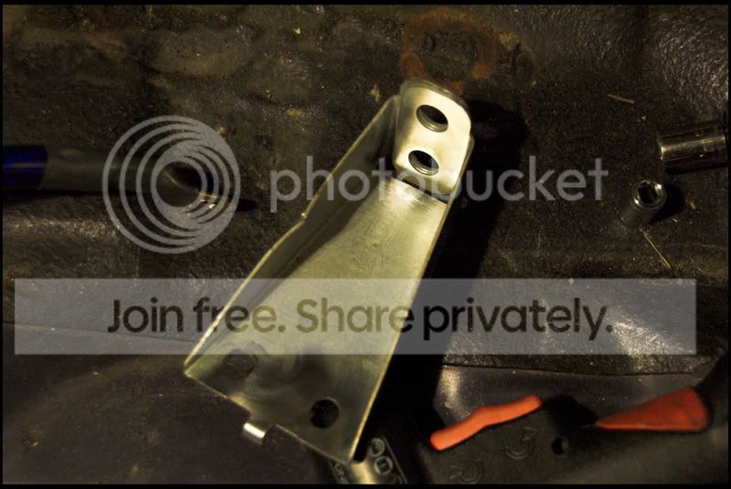

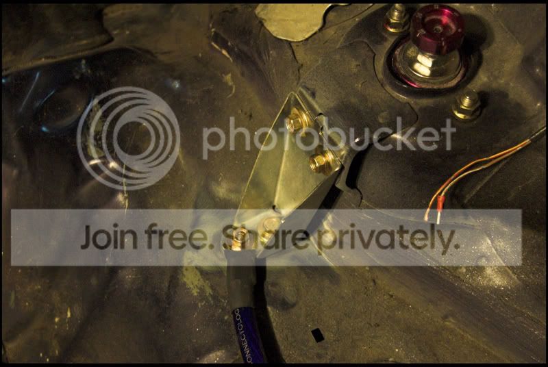

Decided to use the side shock tower bracket for the mount for my ground. Might have to move it, but not a big deal. Ground everything down with a wire brush wheel -
The final product, for now anyways. Will build a box around the battery once I get the car to work (have a table saw etc there).

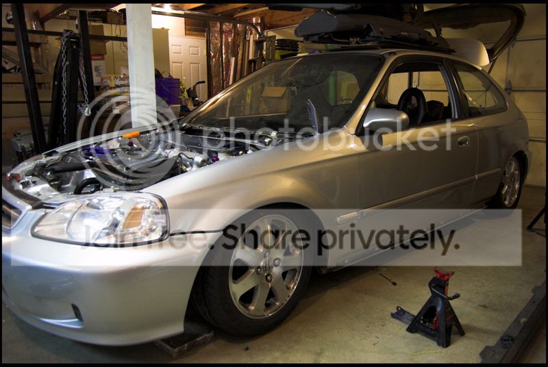

Really need a radiator fan before I can get the car going
