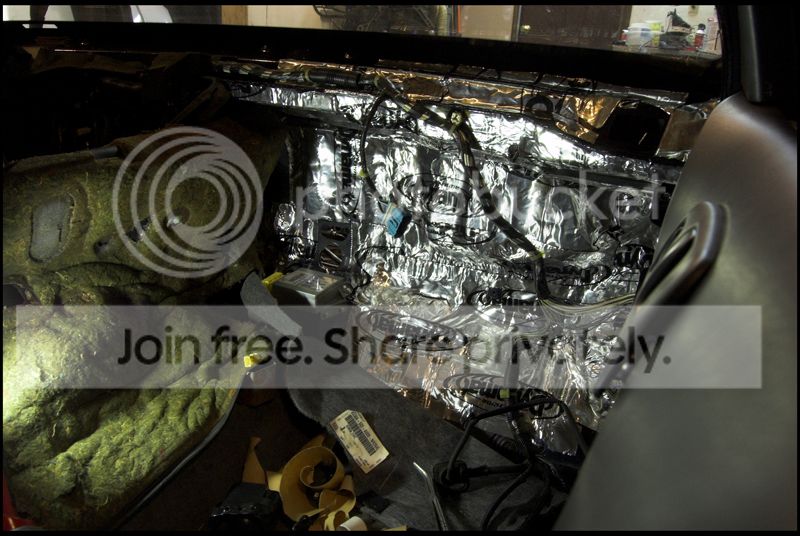

Only thing stereo related I've done thus far -
