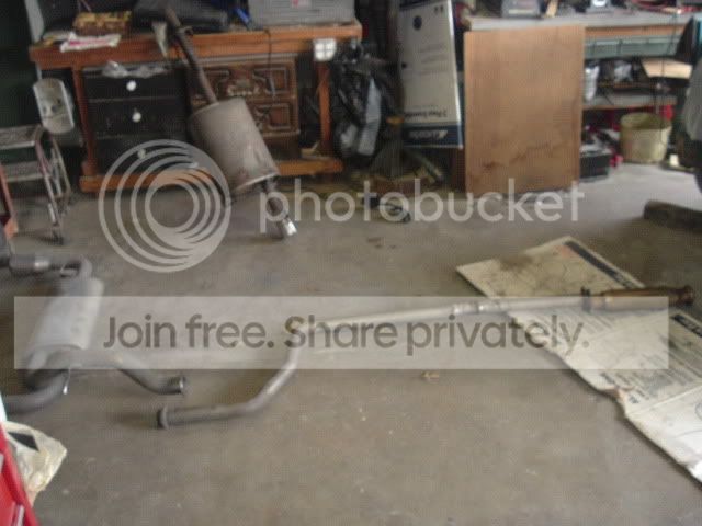

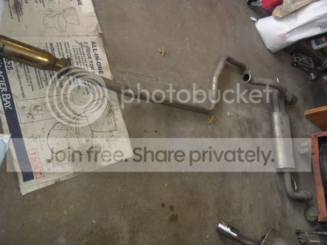

also i pulled off my exhaust today
look at this wonderfully made exhaus ti pulled off
i picked up some prebent piping and i jsut need to get a muffler and im going to piece togethr an exle back to get rid of that dual crap
then later on im going to do a full exhaust when i get some more money and do work to my motor but for now this is fine!

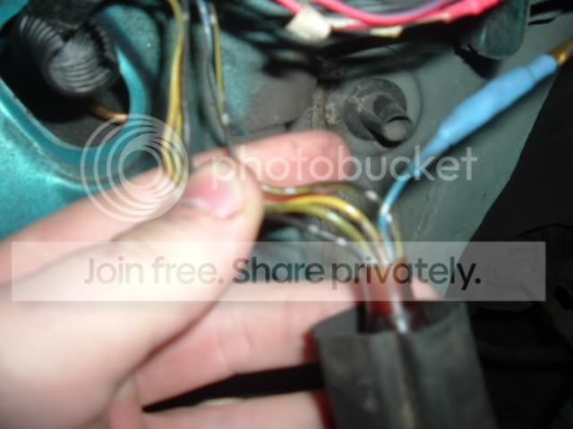

yeah dude i have the wires going to the relay all there and wire coming offf the switch on the block and one of the wires the yellow /green tracer is going from the switch to i think somewhere on the head right by the upper coolant hose not sure if its the same wire but i think it is
and i know the blue wire goes from the relay to the fan, i couldnt find the blue wire to where it goes so i cut it and ran it to the fan
i think all the other wires are connected i hope haha
i read somewhere that coming off the relay
black---- is ground
black / yellow --- is power , runs from relay to fan (also splits in the harness and goes to fuse 15 under dash fuse box)
BLue--- runs from relay to fan
yellow/ green ---- runs to temp controlled fan switch, also splits off and runs to the fan control ECU
fan switch on back off block has
black --ground
yellow/ green-- which goes ?
edit: and i also believe pin C06 on the ecu is coolant temp sensor (Red/ White)
anyone know where im going with this if i went in the right place?

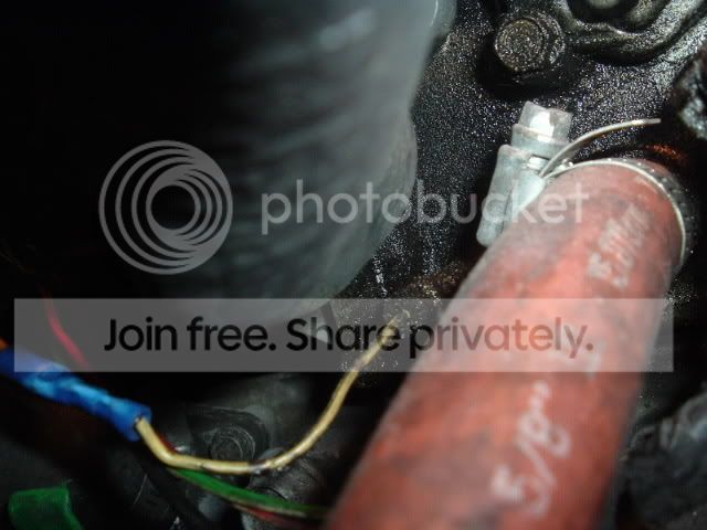

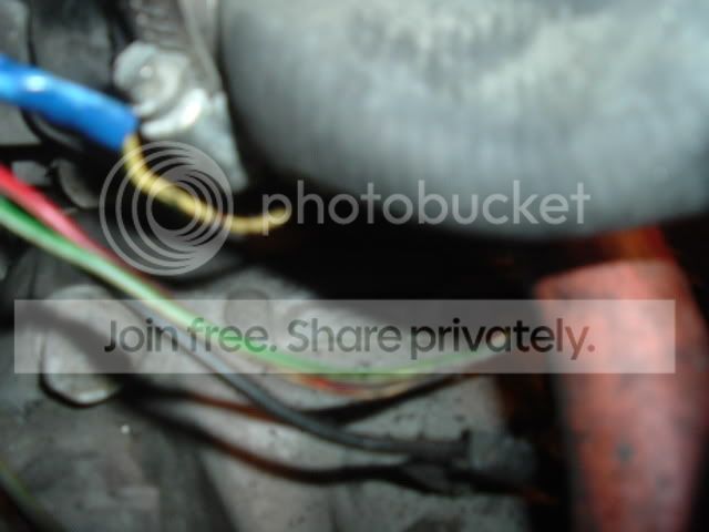

but what does that one wire coming off the switch in the bakc of the block go to on the side of the head? i dont have a picture of it ..
actually let me go take a shot real quick
Yea I dont know where that wire goes. I followed it and it just went into the main harness into the cabin. I just made sure it was hooked up on the block. To be honest with you I didnt even know it went for the fan.
