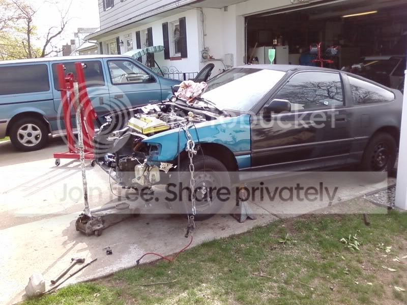

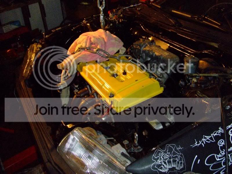

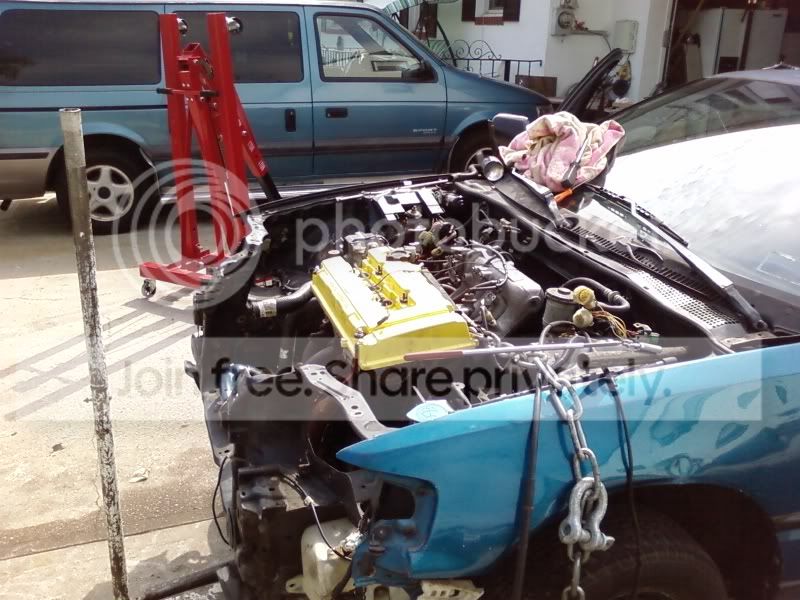

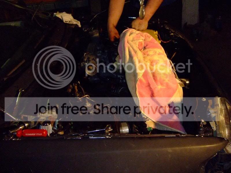

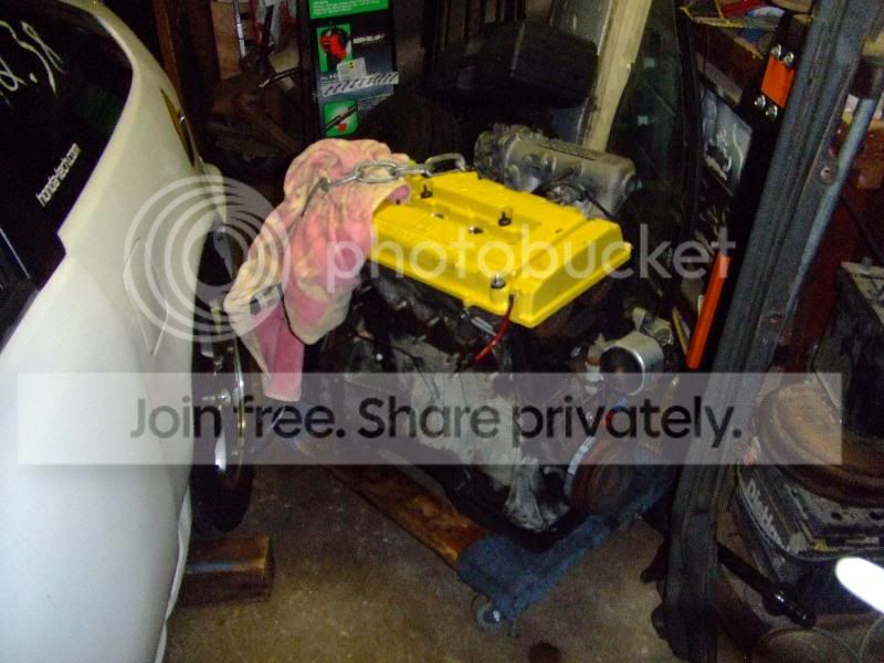

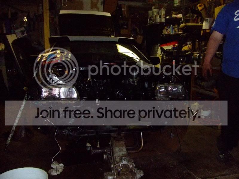

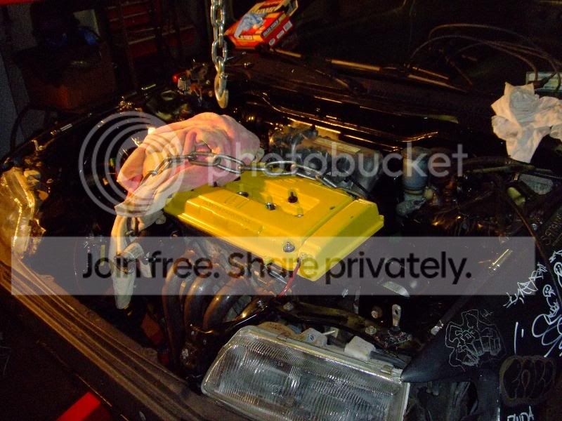

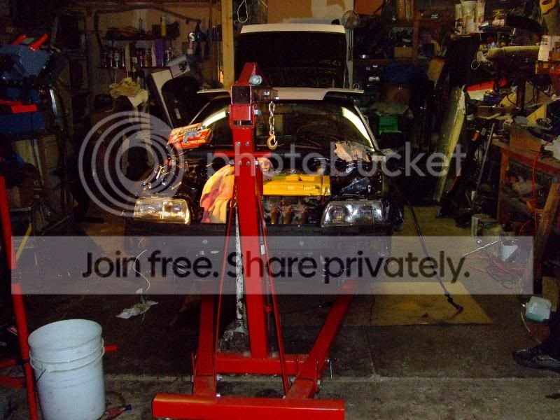

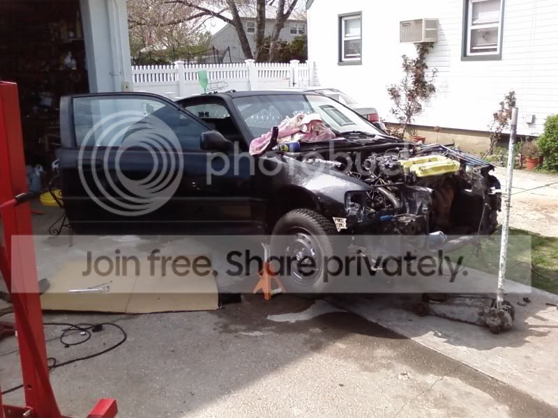

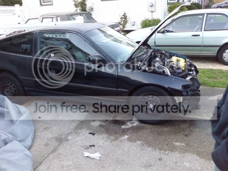

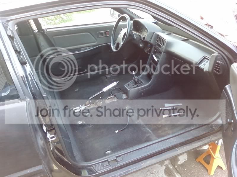

well i got the engine out of the white crx last night, and i started to put the new one in taday. engine is in the black crx and bolted up shiftlinkages are switches and bolted.
wiring is all done except for 2 connectors, one connector i dont think the dx has but the Si does and the other connector is for the fuel injectors (the white connector) not the green one for the resistorbox
pictures up in a few
couple shots in the car
preping to take out
BAM OUT

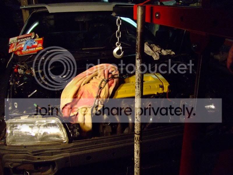

the B16a just chillen on the dolly

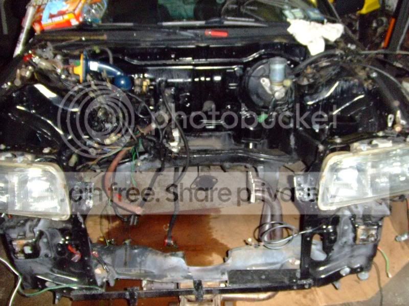

and now the engine is sitting in the black crx
clean interior

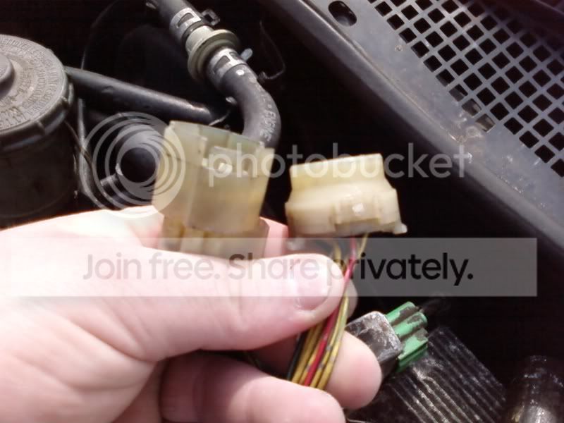

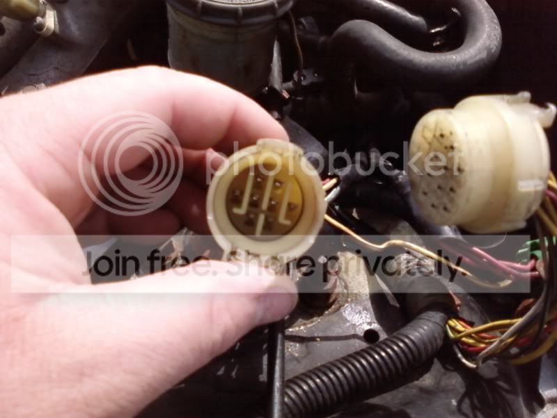

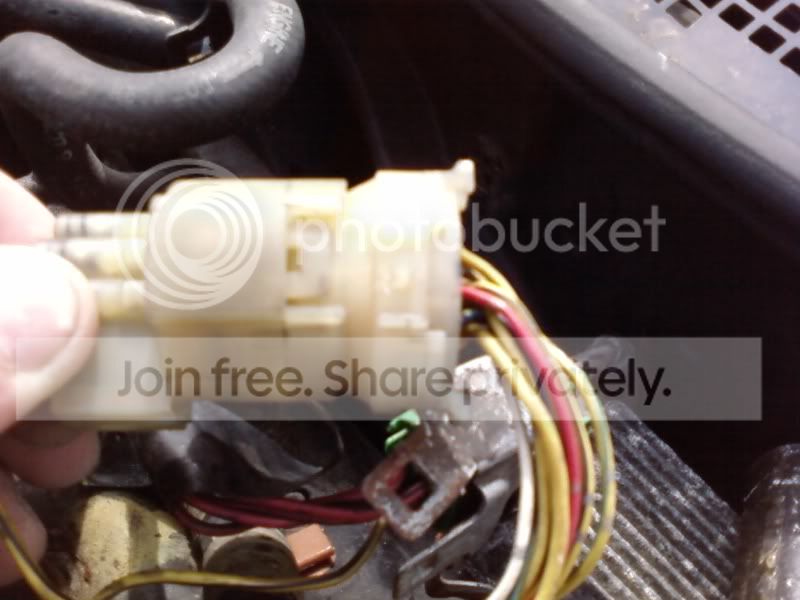

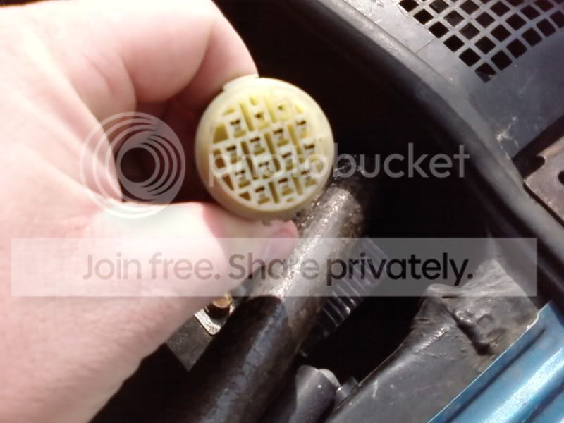

ill get the pictures up of the connector that doesnt fit
and why does one have 12 and the other have 8

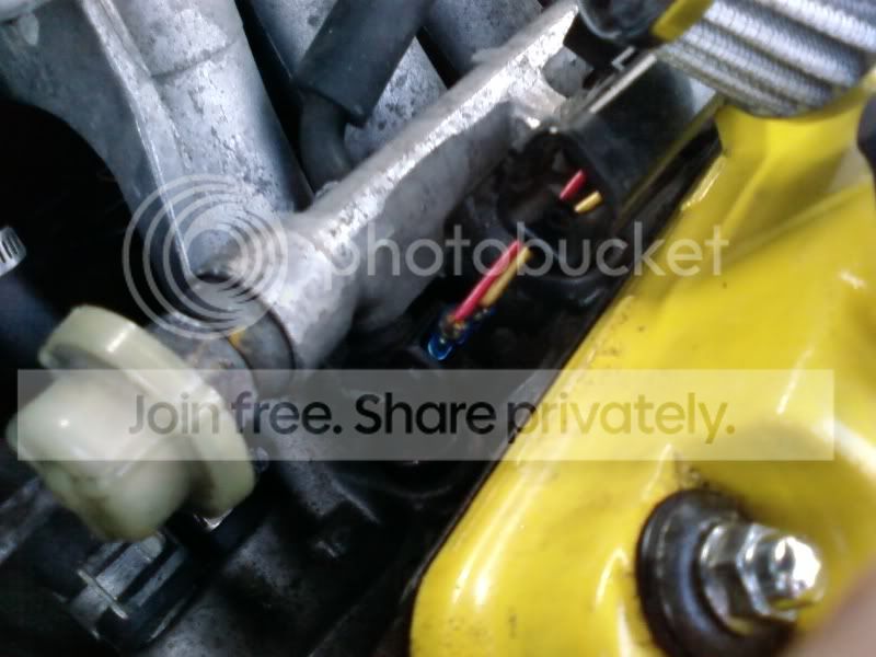

ok now i took the engine harness off my Si bc the dx didnt have one
sooooo i dont know why or what car the guy who i bought the car off of, got the MPFI conversion from bc the green connector fits to the resistor box. but the injector harness connector does not fit .
ok now here are some pictures
this is the connector on the DX
see how it has 12 or 13 wires (pinouts)
this is the connector from the Si wire injector harness
side by side
and together( they the male part is bigger than the female part)
now i just need to find a wire diagramm on the injectors so i can get either a new connector or just have the wires connected individually by either one solid wire or quick connected
other than that i think thats the only problems on the car beside me having to rewire for VTEC
side by side

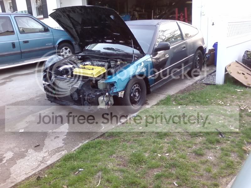

UPDATE:
got that **** running, my father went to the DMV got it registered(bc im at work now)
going home in 20 minutes and going to put everythign back together and get some pictures up
im excited i need this **** running for next weekend CARLISLE import show.

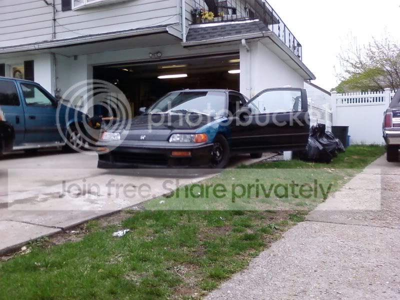

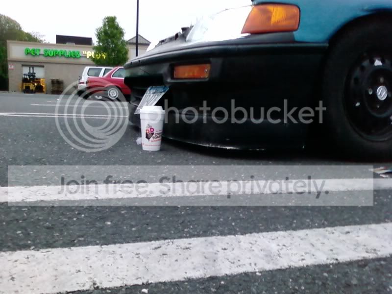

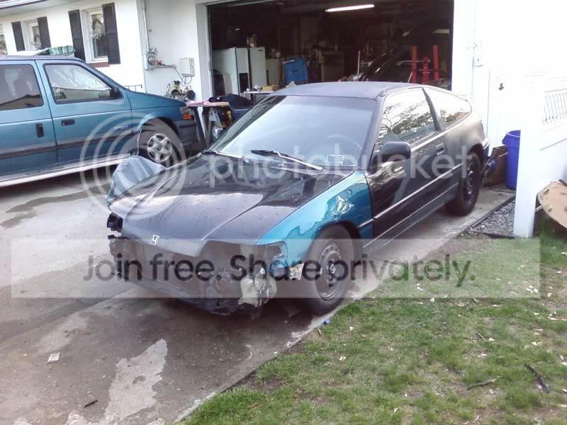

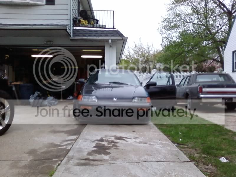

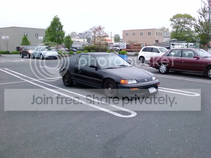

finally got it registered and drove it. it drives nice! but the brakes are really wierd
how low can you go hahahaha i need to raise the front end
and the rear looks so high because there DC discs on the back and the upper arm needs to be replaced
oo and i need osme injector clips
sleepy time for tonight, untill tomorrow
now i dont knwo why the brakes are soooooo low i blead the brakes and got a 40/40 prop valve and i believe there is a 7/8" MC but i think the stock BB can this cause the brakes to be on the floor? or maybe the brake master cylinder piston needs to be adjusted
