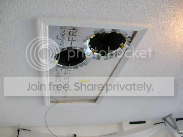

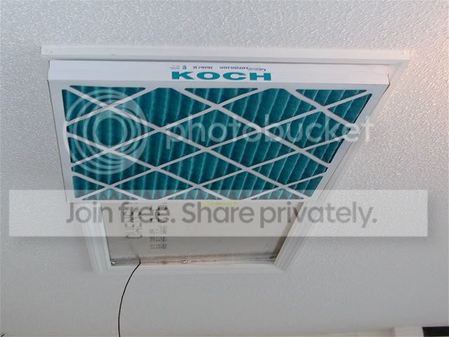

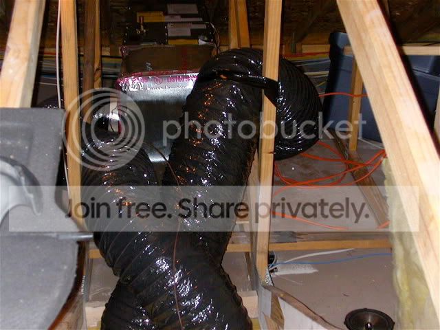

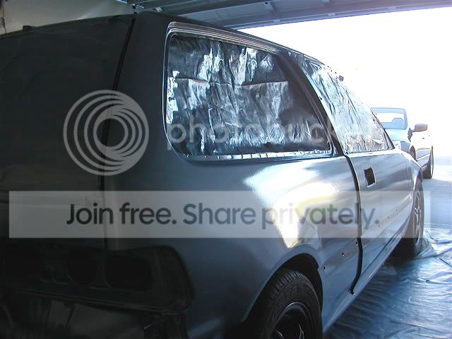

update-exhaust fan is installed and works better than i thought it would. everything except the unit was salvaged so it's not pretty but works fabulous. Do not try this at home Lol. sheet metal can slice you up and 240V might hurt.
plenum-used sheet metal framing studs to make a box, wrapped the box with sheetmetal, left the endcap off so i could screw it to the bottom of the unit, screwed to the unit, made an endcap, and finally sealed with metal tape.
electrical-the orange wire is 240V (10ga wire with a ground) power for the fan. The fan pulls 1A so i just spliced into the other AC unit in the garage instead of adding a seperate circuit. The brown wire is 18ga 3 wire t-stat cable used to relocate the controls from the attic to the garage.
Replaced my attic access panel with ductboard. Cut holes in the plenum and ductboard, made start collars and ran two ducts. One is 9" and the other is 10".
when the fan comes on the garage door pulls in and the howling begins. The filters are pleated 24x24x1 and suction is holding them up.

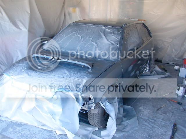

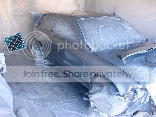

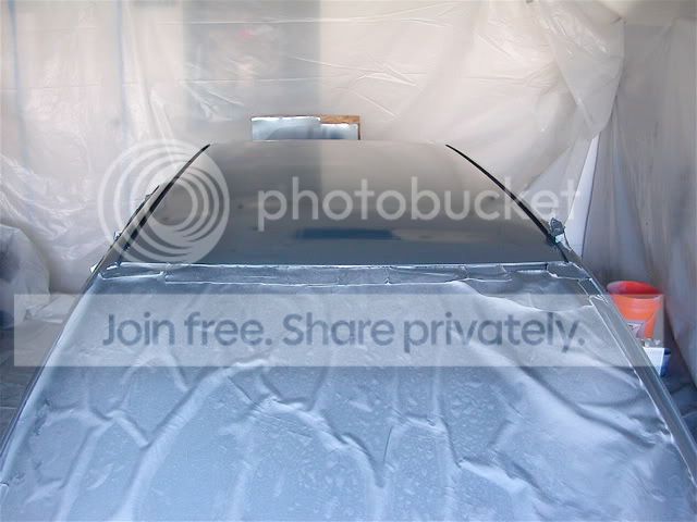

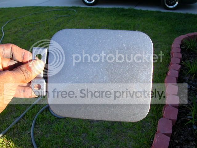

The wife had to go somewhere for the day, so last night I called my boss told him i had something to do in the morning and i'd be done between 9-10. he said "ok" no questions asked.
started at 7am this morning. rolled the car into the driveway and watered down the garage walls and floor. pushed the car back into the garage and wiped it down with wax/grease remover. then wife left at 8am this morning and at 8:01 I started painting. Mixed up 12 oz. paint, 3 oz. slow hardener, and 3 oz. slow reducer, strained it and dumped it into the gun. started at the top and worked my way down. after the gun was empty i waited 20 minutes and repeated 4 times.
at 9:45 painting was complete.
I beleive the exhaust fan made the difference between a paint job and a great paint job. check out that air filter. I figured after the paint hardened that the fan would be useles with the plugged filter. i had a spare so i swapped them out.
orangepeel isn't too bad. I'm going to let it dry for a week and then i'll wetsand it with 2000 and buff it to a shine,
b-35m montreal blue metallic paint
Modified by eda6 at 12:46 PM 5/14/2006
