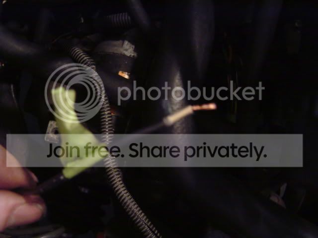

The other wire I am wondering about is my o2 wire. I went and looked on my Hf and the wire is a white wire. So I came back to my Si and there was a white wire that doesnt have anything on it. I think it has to be it, idk maybe it isnt. It runs from the ecu...Here is a picture of the wire I am talking about. As you can see it has a black shell or whatever around it. O well heres the pic.
Sorry its so blurry. But tonight when I get everything done I will upload all my pictures to show you guys the progess. It looks GOOOOOOOD!

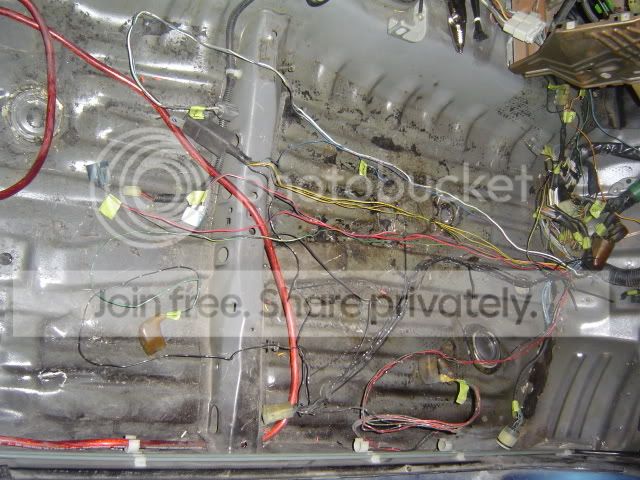

<U><FONT COLOR="red">***UPDATE*** 03/01/07</FONT></U>
Lately the only thing I have been worried about is getting my wire tuck done. I have been working on this for weeks now and was wanting to wait till I got everything done before I posted a update. Well the only thing I have left to do now is run my headlights, corners, and marker lights. I have learned alot while doing this tuck and I am very glad that I did it on my own. My first intentions was to have someone else do it for me but after looking over everything I didnt think it would be that bad.
I think somewhere I told you guys I started by labeling everything. If you ever do a wire tuck you want to make sure you label EVERYTHING, it will help you out soooo
much. The next step was to start unhooking and pulling everything through the firewall into the cabin of the car. Once all that is done the best thing to do is start removing all the factory tape and wire loom. You do this so you can reroute everything MUCH easier. After everything is removed you need to group everything up to where they are going. The best way I found was to loom everything together that was going under the dist. Put everything together that was hooking up the the manifold and then loom everything that is going to your alternator. That is pretty much it on your passenger side. The only thing I have coming out of my passenger side is my injectors.
When I get home from work tomorrow I am going to dive right back into the car. I canot wait to get it all finished. After my wire tuck next to do is work on the 16s. I am going to sand them completely down and probably repaint them a graphite color... I dont know yet if I will reuse them though, I would really like to have a set of HXs or Si rims.

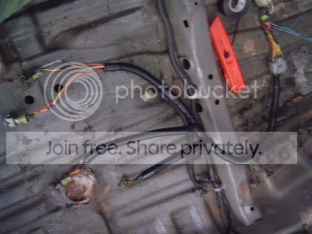

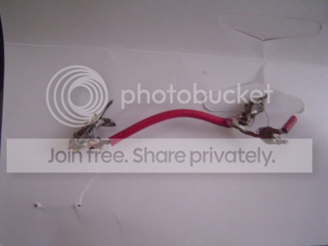

Here is a section I cut out of the old wiring. Just wanted to show you how it did look.
And here is the new sections..

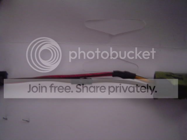

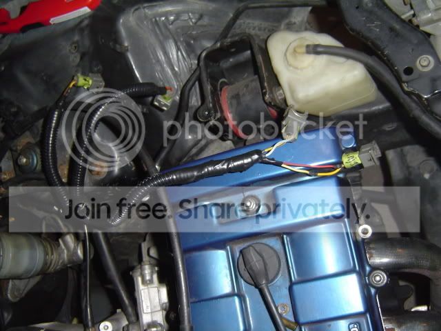

Injector wires went from this...
to this...
to this...

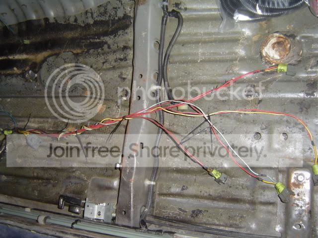

and here they are in the engine compartment getting ready to put ran under the manifold

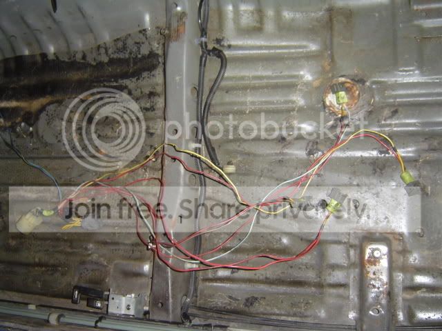

Here is the driver side headlight, etc wiring sitting in the cabin getting ready to be ziptied together and ran through the frame rails
passenger side

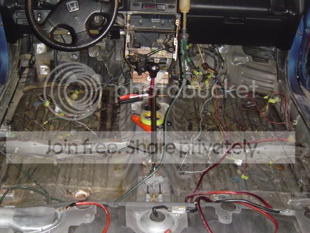

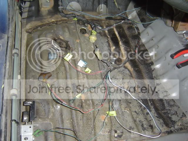

Overall shot of the inside as of right now

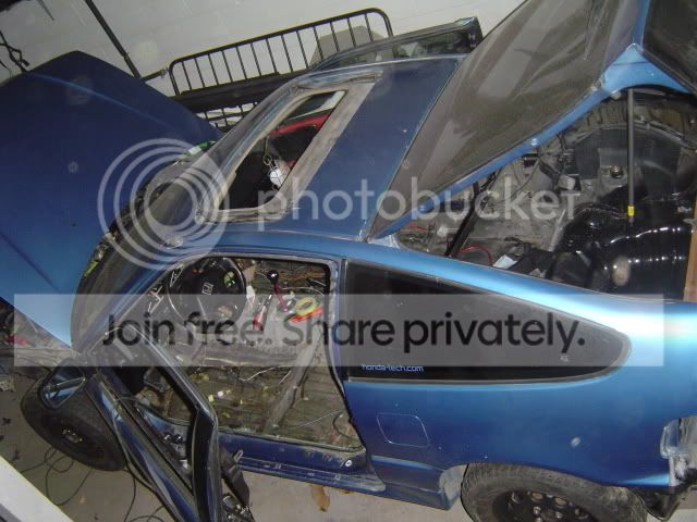

Well thats about it..I leave you with one last picture of how the car is sitting in the garage ready for bed after her surgery.haha. Shes tired...
to this...
to this...
passenger side

that black wire above is the o2 sensor if your obd1 you can just cut it.

if your are running OBD1 then you have already wired in the four wire o2 sensor. the one wire that is left(as in still there), under the dizzy is what used to be the obd0 02 sensor. it's just a left over wire. i went back into the harness a little bit cut it, put some silicone over it and shrink tube.
well i fucked that up but you get the point.

Hey you did kinda mess that up. But after rereading it I understand it..haha.
Well my car is still obd0 so I guess I have to use that wire.
