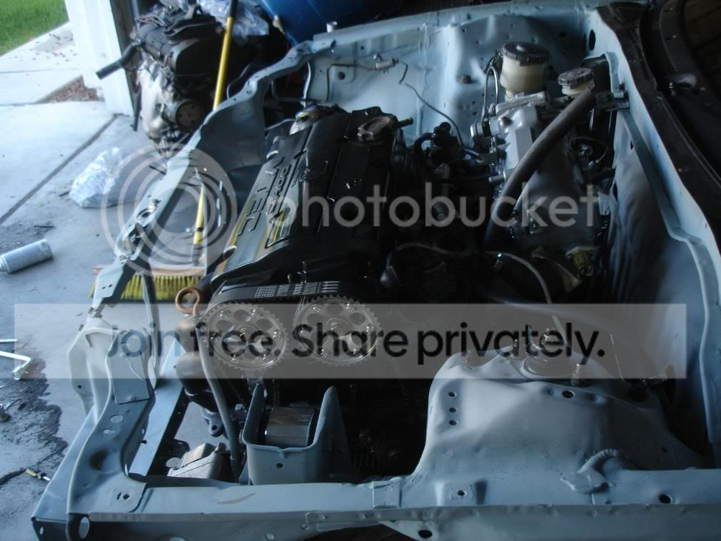

thevtechnician came by and helped out with sooooooooooooooooooo much. alot of things got done this past week. BECAUSE i didn't remove my balance shaft, i DID run into alternator and crank pulley clearance issues. without removing the balance shaft and moving pullies towards the block you HAVE to cut Or notch the frame rail AND pound the blood out of the framrail. i did. a messy job i did too. desperate times calls for desperate measures. i notched the frame rail like so.....
IF i could weld it wouldn't look so bad. so my plans are to leave it like this until i can afford to go all out with a full body work and paint job.

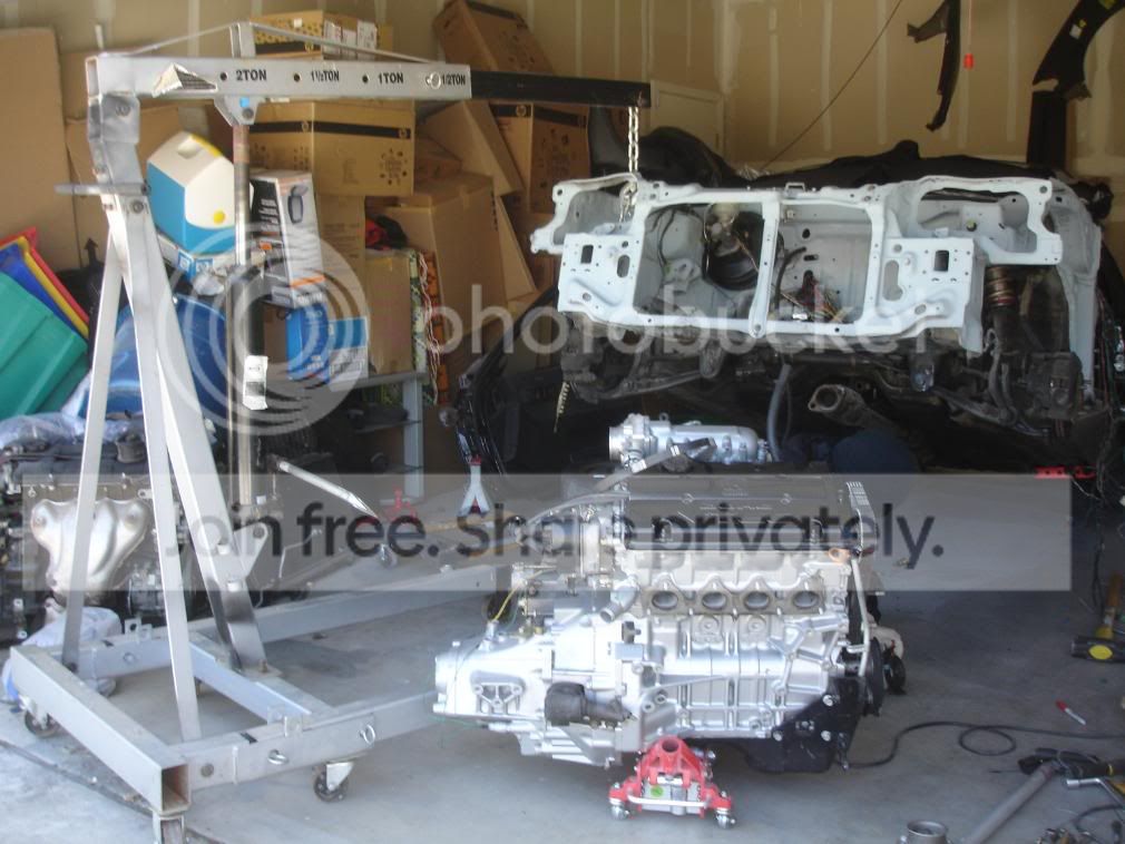

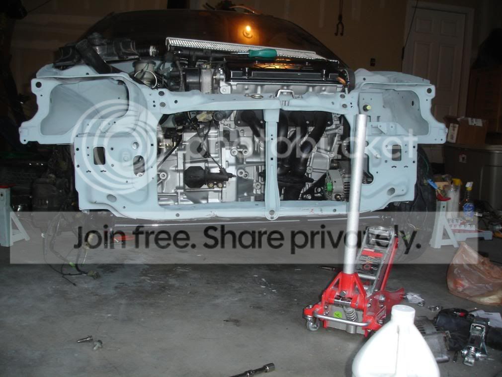

and here's my second attempt at dropping the chassis into the motor, lol
TA DA! it was EASIER to mount it in this order if motor is put underneath;
block side,tranny side, rear mount.

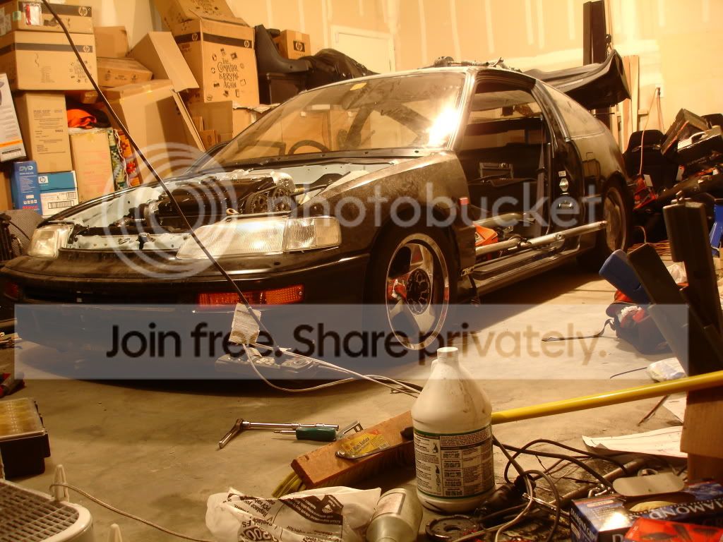

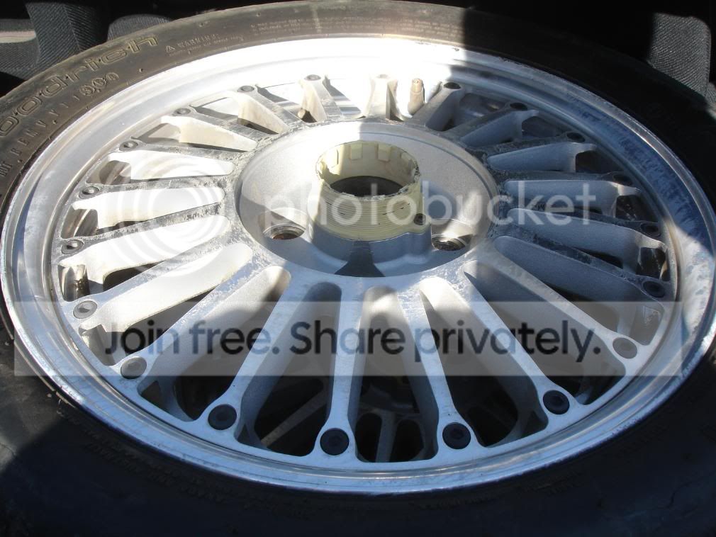

and i picked up these rims today from the yard!
they look kinda funky...ME lIKE iT! sorry for my weird taste.

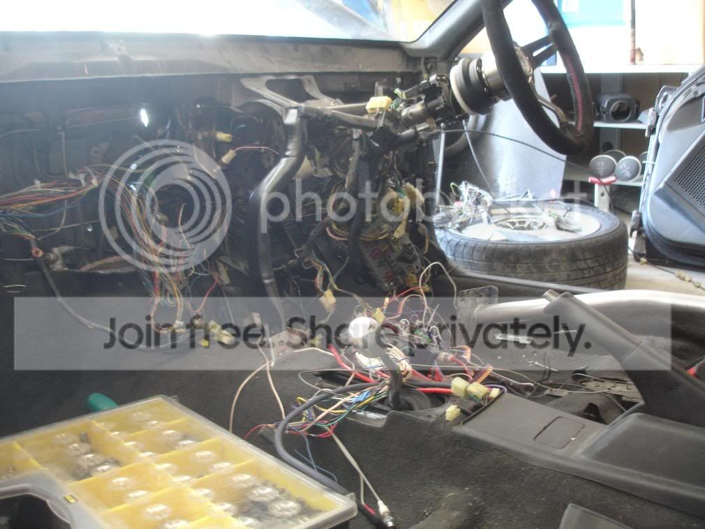

and this is how my interior and harness sits:

They almost look like some old school super fins! What size are they? They would look real good either white or polished.

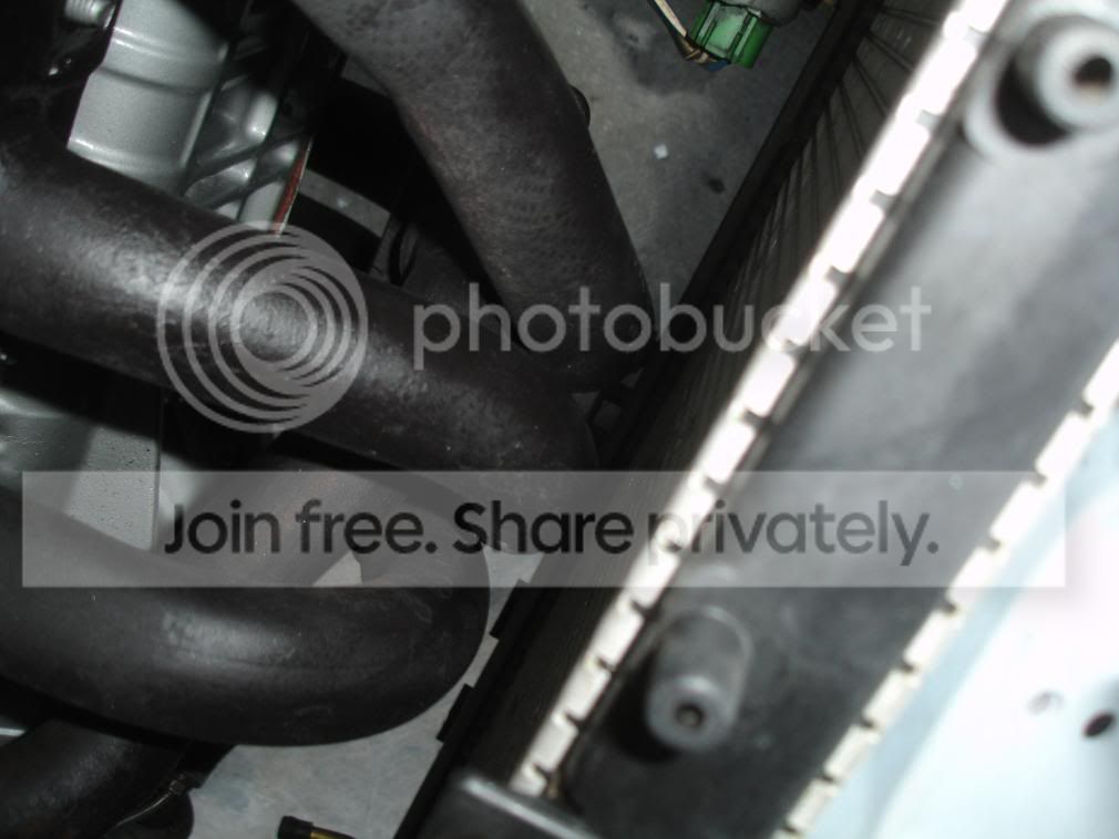

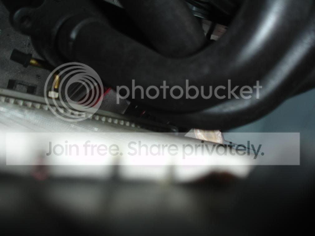

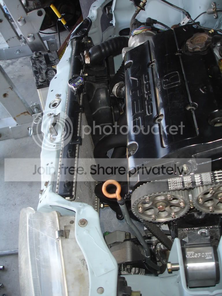

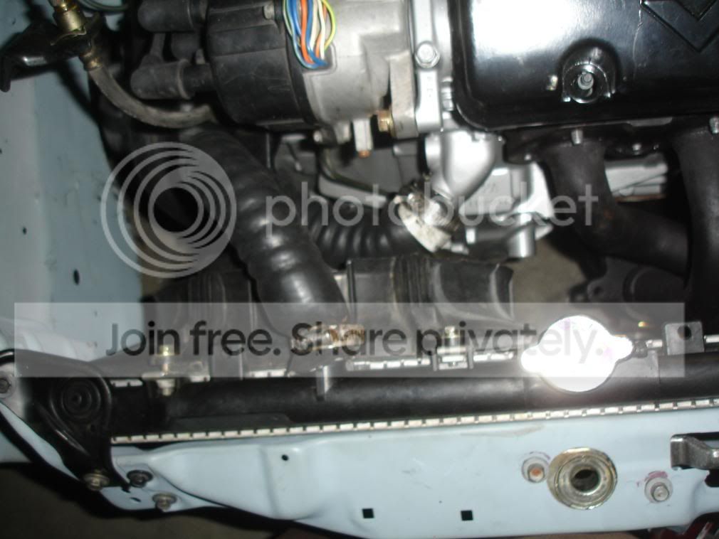

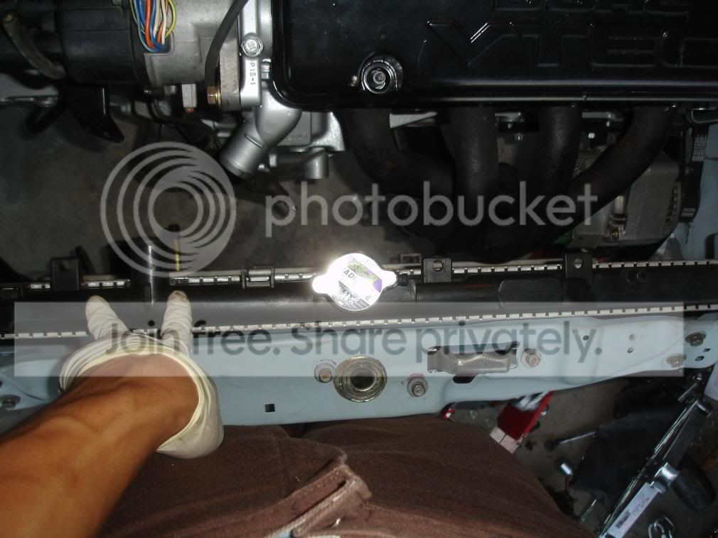

i've tried my best to get pics of my clearances but they suck!
here's a top view of the upper radiator hose and radiator fanclearance...

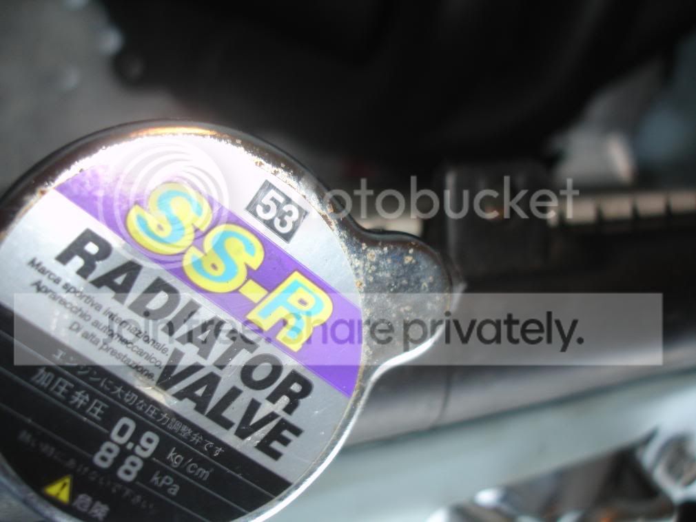

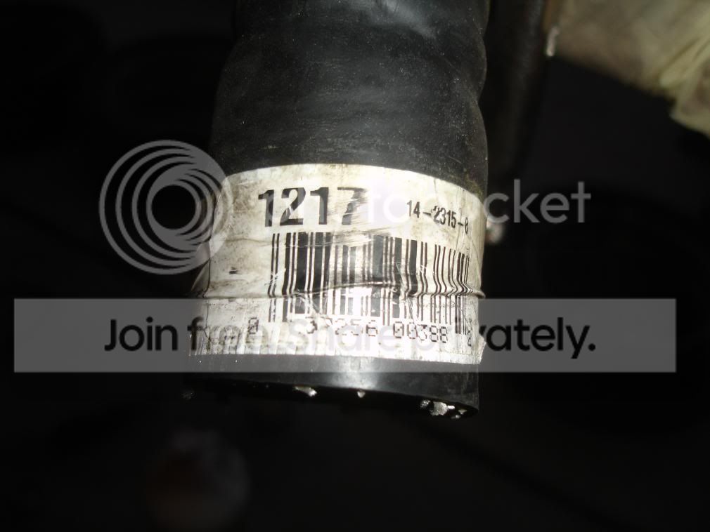

the Autozone part number....get it the zone!

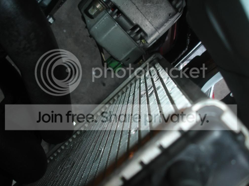

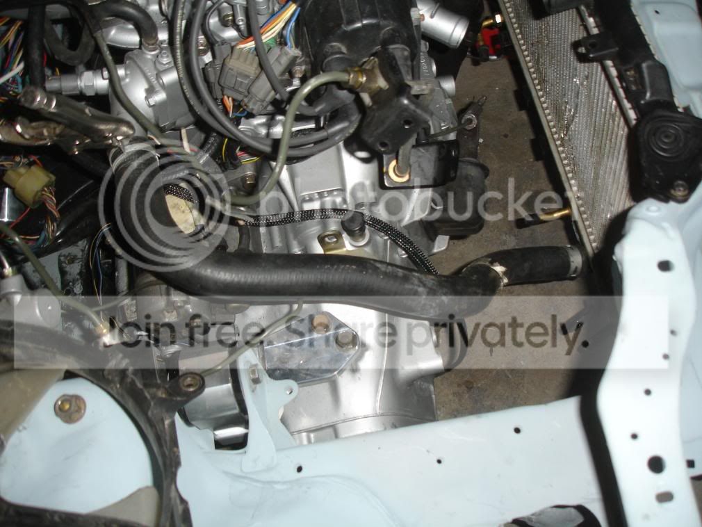

here's my lower radiatior hose. if i wasn't so lazy, all i'd have to do is rotate the radiator end of it and the bends look like it conforms to the shape of the tranny.
...i thought it was my stock hose but it could've came off of my old siR setup.

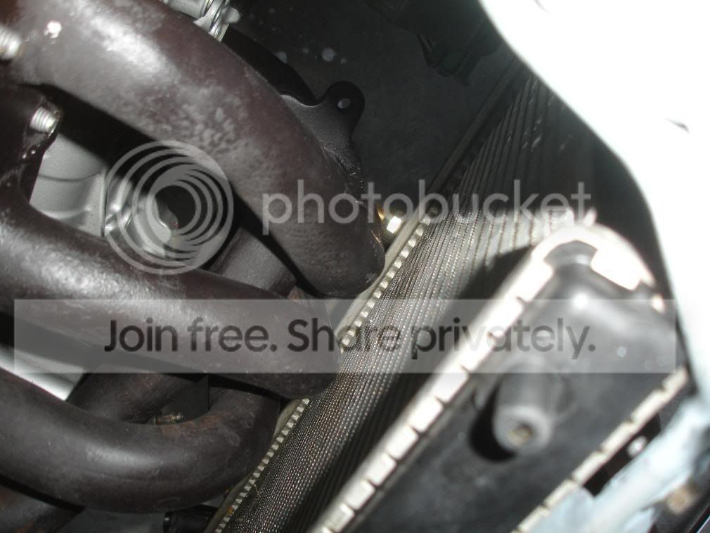

not only did i have clearance with the stock headers but, it bolts on to my stock exhaust setup!

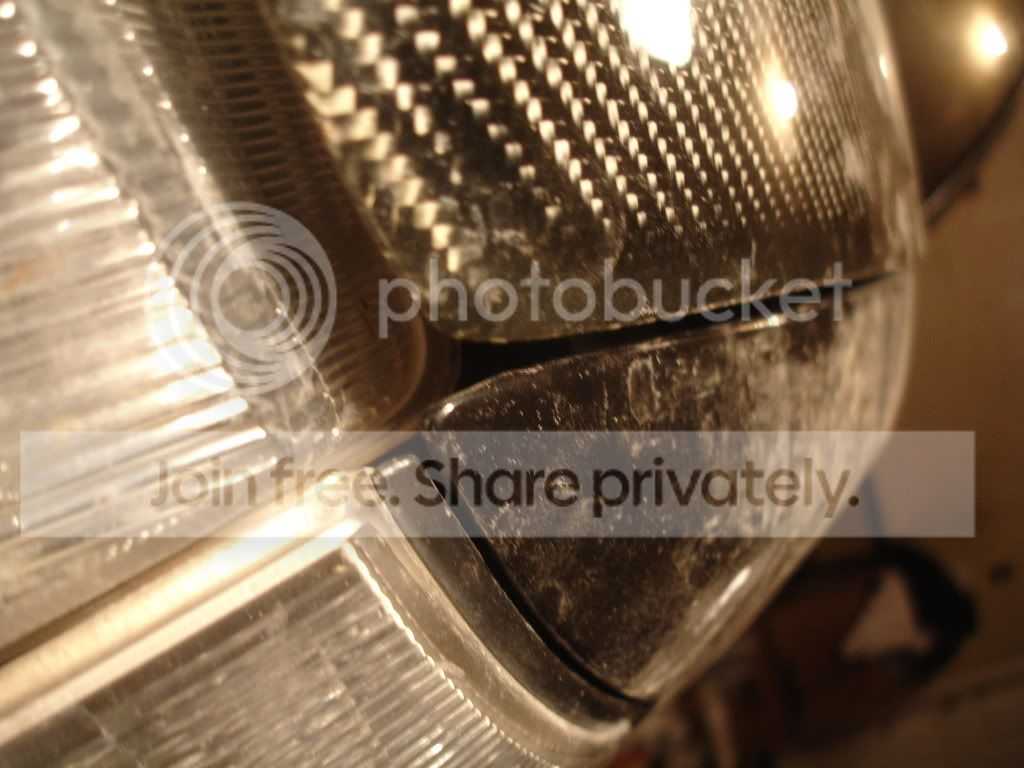

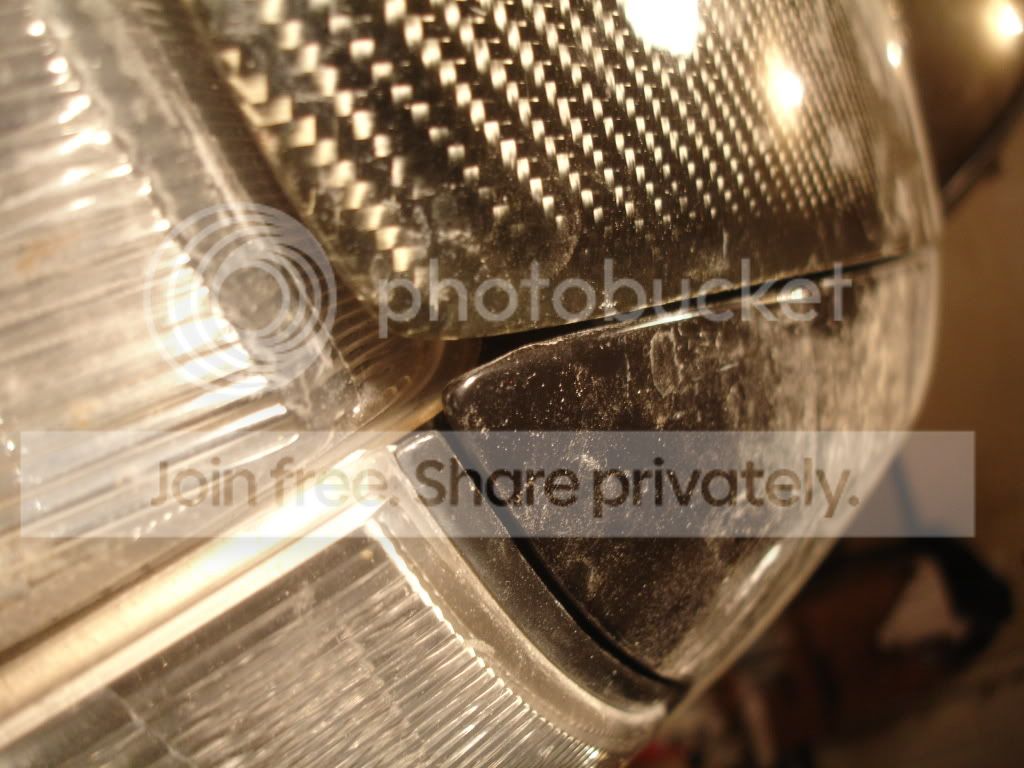

i even have HOOD CLEARANCE! not cuts here!....yet
and with a firm pressure of two fingers...
my setup for the hood clearance was due to the hasport efb2 mounts + qsd kits + uncut valve cover + siR carbon hood AAAAAAAAANNNNNNNNNNDDDDDDD no oil cap
you'll see my fix for that soon!
