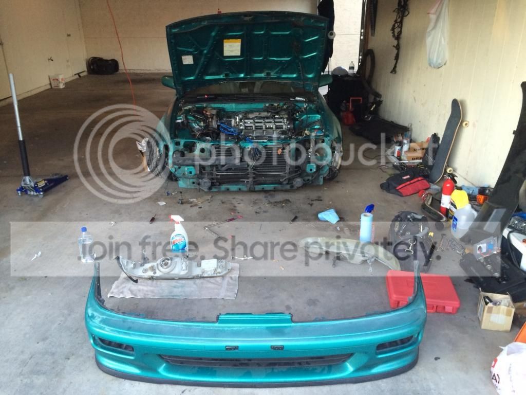

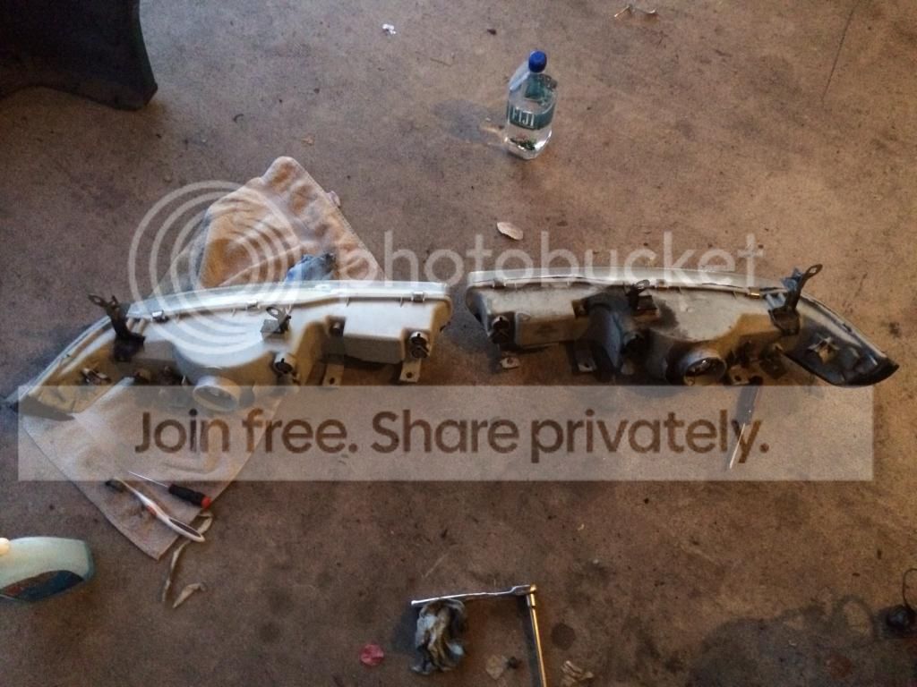

Even with all that wiring nonsense, I was able to have a friend come over and help me out with realigning my hatch. It was sticking out about an inch when I got it and has been a huge eye sore to me the entire time. I forgot to take before photos, but here’s the tentative end result.

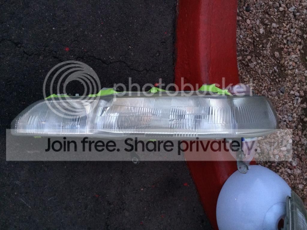

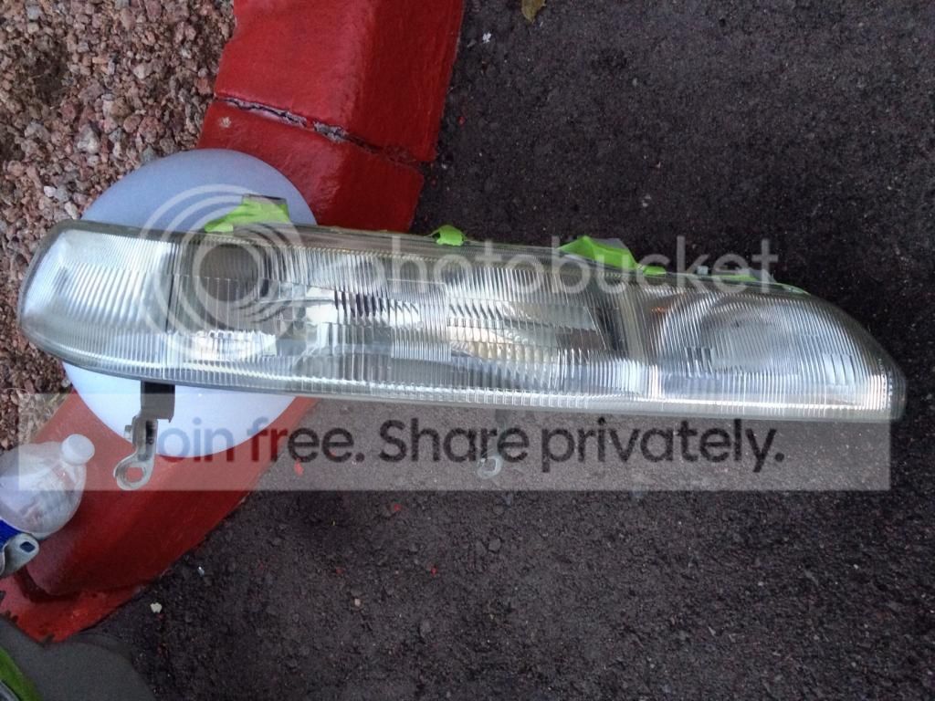

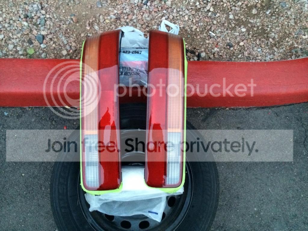

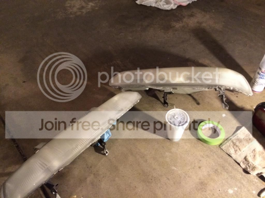

All of the lights on the car (with the exception of the amber bumper lenses) are obviously pretty old and worn. I decided after looking into a few different options to go ahead and refinish them since the car wasn’t moving anytime soon.
After a quick wipe down…

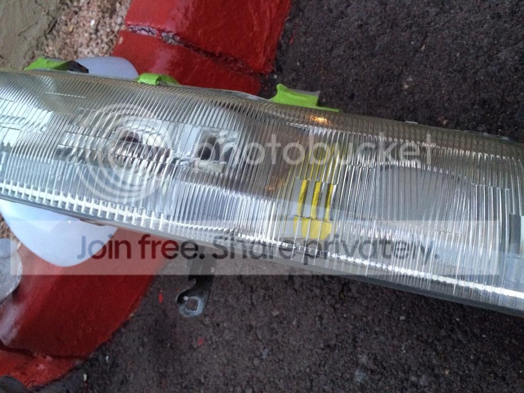

After wet sanding with 320 and then 800, this is how they turned out…
The tails weren’t as bad, so I just roughed them up with the 800 and taped them off. After wiping them down, all lights received 2 coats of Spraymax 2K Glamour High Gloss clear (Part # 368 0061). The end results can be seen below…

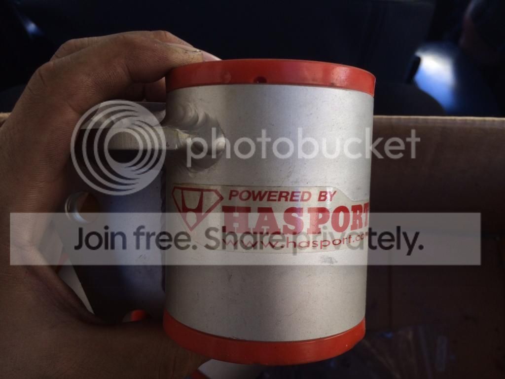

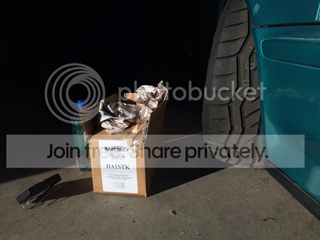

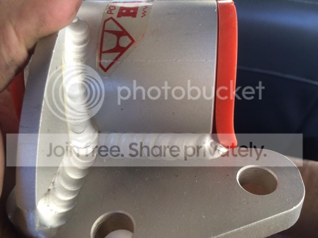

Hasport DASTK1 Mounts 62A
