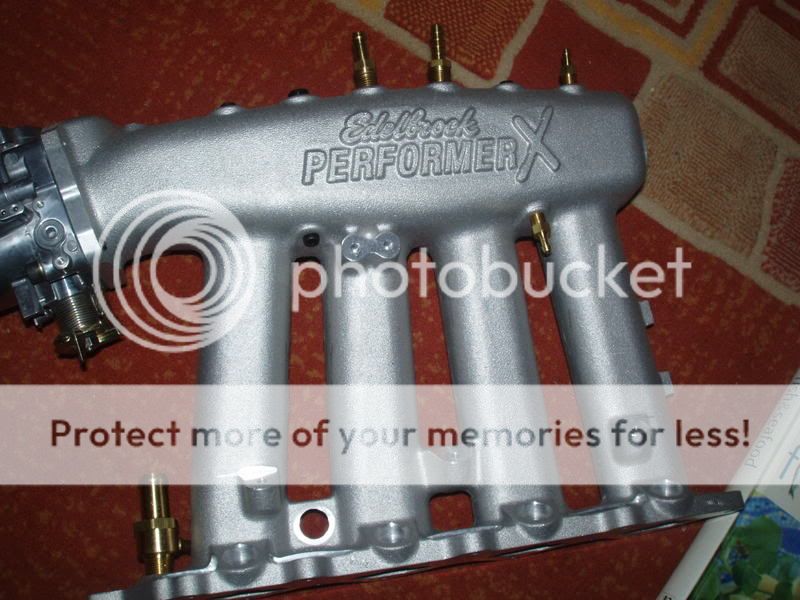

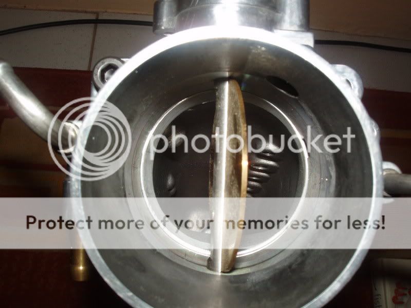

I just got my PerformerX manifold for my B18C5 build, went to the machine shop to bore the opening to 68mm only to find out he can't do it. He said that he doesn't have anything big enough to clamp the manifold in place to mill it. He used his digital inside-outside caliper and measured 65.98mm diameter on th emanifold, so I decided to bolt it to the throttle body and see what is the difference like. I need you guys to look at it and tell me if there would be any drawbacks in bolting them together "As Is".

even with a dremel and some patience it can be done... if you know what you are doing.

if I was to use a dremel, it would be best to do it with the TB still bolted,right?

yea u can do that, or just mark it where it needs to be cut

bolt it on...use something to mark the edge that's "sticking out", take the tb off, get the dremel and go to work
if you port it a little bigger than what you marked, i believe this is okay but i would just be careful and take my time so the air has a nice transition from TB &gt; IM (aka port matching)

Get the throttle body gasket, put it up 2 the manifold n mark the opening..get a dremel n go 2 town...
