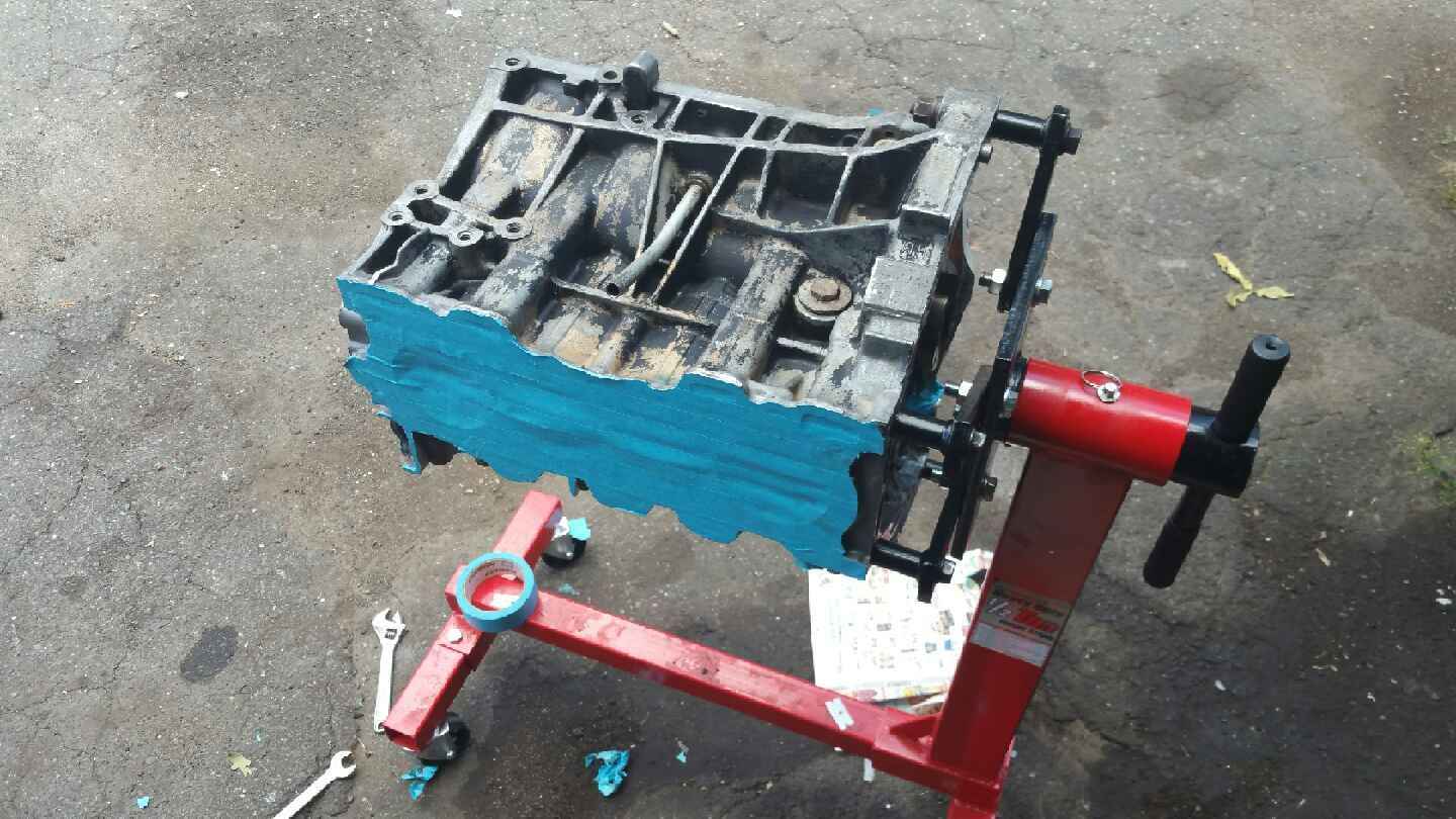

What's up guy! I thought I start a thread on my B series all motor build I've been working on for the last few months. I really think yall will enjoy this as much as do! The journey hasn't finished just yet, but hey, that's why it's a project.
10/21/15 progress!!!
That being said here's the low down on what it's been like.
I'm not a mechanic, nor do I have any prior car projects. But I know enough to get the parts purchasing correctly. And with the much needed help of my mechanics Flex and Keymar, I think we've got enough brains to reach that 300whp goal

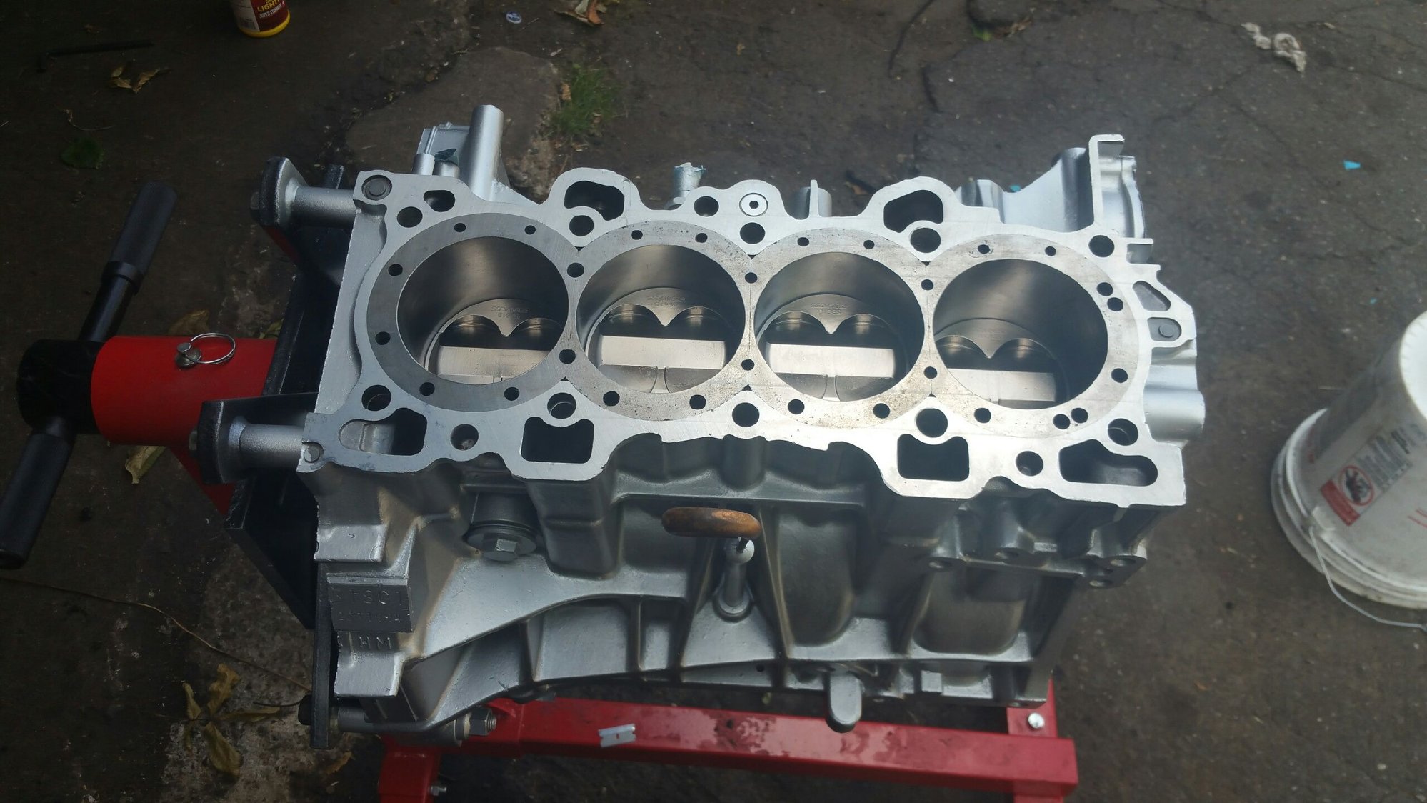

Parts
Bottom end:
Gsr b18c block (purchased bare)
Golden eagle sleeves&block guard(85.5mm!!!)
Golden eagle oil squirter plugs
ACL race bearings
Honda LS 89mm crank
ARP main studs
ARP head studs
ARP ROD bolts
Manley rods
WEISCO 85.5mm 13:25:1 Comp
Type R oil pump
Gates racing timing belt and water pump kit
Honda oem Crank gear and key
GSR girdle w/new bolts
Moroso turbo oil pan
DOWNSTAR complete bolt kit

Good luck on the build!
Did your oil squirters hit the crankshaft and that's why your deleting them? Just curious a sit seems some people said they clear and others said they touch.
Mine touched and I had to plug them in my old build.

I bought the block bare, without squirters. My mechanic told me I needed them. Not 100% sure why honestly.

I personally think that if you are able to keep them you should. The purpose of oil squirters is to cool the piston, not for lubrication like many people think.
Cooler pistons help resist detonation. But with ethanol, it's not quite as important since e85 has a high octane rating.
With 89mm cranks they seem to be very close to touching. Just curious if you're cleared or not that's all.

89mm crank will hit the oil squirters, as far as I know you will need LS rods to go with the crank because of the different designs between the GSR & LS rods that cools them.
