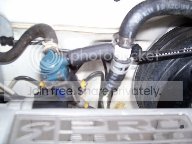

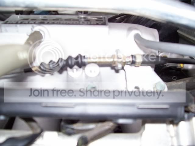

here are some pics to help you out. the extra opening you have on the new manifold will not be used so cap it with a thick rubber vacuum cap.
this is how it should look. i got to clean it up a little. the line on the right goes to the break booster. the one on the left goes to the purge on the EVAP can. and the bottom goes to the manifold. also you throtle cable will be relocated to the right unless you can cut some of the bracket off and drill new holes in it.
hope this helped.

what did you do with the extra water bung the skunk 2 manifold has?
Old Apr 5, 2007 | 02:12 PM
integraguy2000's Avatar
Posts: 24
From: Mansfield, Louisiana, U.S.A.
Default Re: Skunk 2 intake install problem...? (dc4_wHORE)
the one your pointing at in the second pic you will need to cap it off with a thick rubber vacuum cap and someting to hold it down with like a squeeze clamp. thats all.
