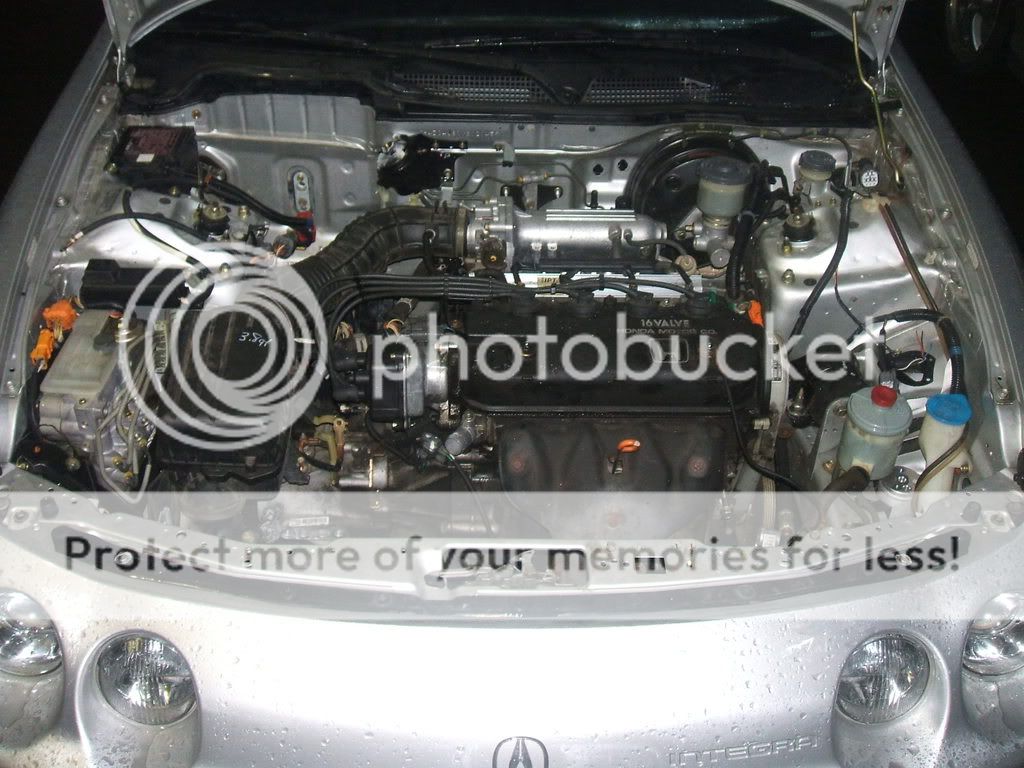

Here's some pics of the SOHC integra... just dropped it in.. wait'n to get it wired since the harness is obd1 car is obd2... looks wierd but not to out of place...

man that's a lot of empty space
Old Jan 12, 2008 | 10:42 PM
God-Driven's Avatar
Posts: 224
From: Houston, Tx, u.s.a
what brakets are you going to use for the p/s pump?

Default Re: (God-Driven)
not sure yet, might have to track down a d series PS bracket and see if that works..

need OBD2a jumper to OBD1 fyi, not OBD2b so there is no confusion
And to who said a lot of empty space, did you see a radiator in there yet? nope.
