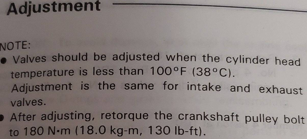

You are not supposed to adjust the valve lash after the engine is warmed up! always do it cold. when hot, the metal expands and when you're working on it it's going to cool down and settings will change.

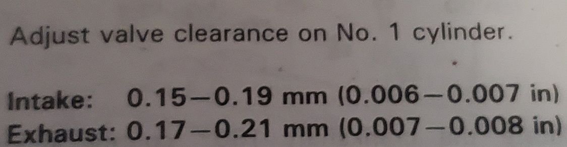

Correct
From the helms for 95 del sol with B16a3
