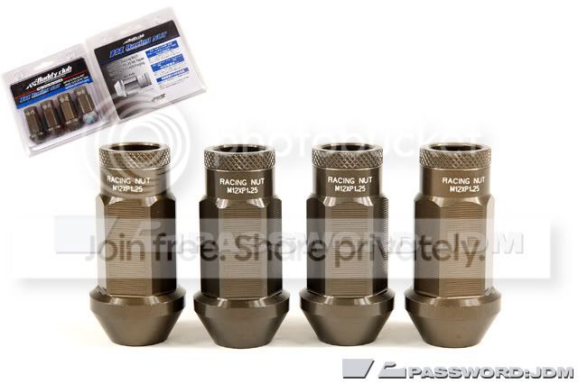

i need to get new lug nuts,
ive originally wanted to get the buddy club P-1 racing nuts,
but when i saw my friends rays lug nuts and compared them to other no name brand lugs, these where soooo much lighter than anything ive ever seen,
honestly so light, that i think they would break lol. but they probably wont
you could tell just by holding them that these weigh almost nothing compared to others.
any one ever try the buddy club p-1 vs. the rays lugs?

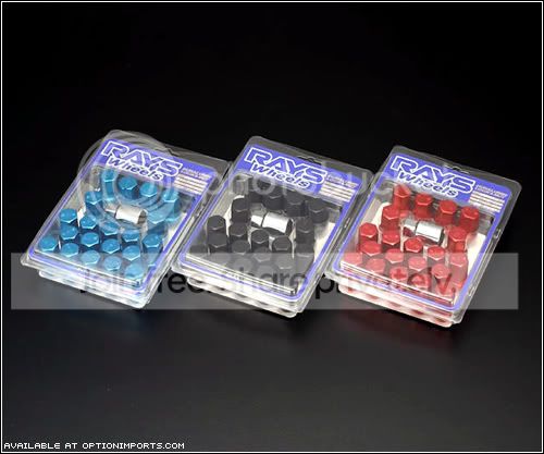

"Rays Engineering, the maker of Volk Racing Wheels, has released a new line of performance lug nuts. Made from Duraluminum, these lug nut are extremely strong and light (the Rays lug nuts are 0.8 oz. each compared to 2.1 oz. for the stock pieces)"
what about muteki?
I'm probably gonna get the newer dura-nuts by rays.

thanks for the input, im sure these will work for my after market wheels,
any one else ever seen the buddy club p-1 lugs, or held them in ur hand?
i want to know how they compare to the rays dura-nuts.
or know the exact spec. weight in oz. (.8oz for rays.) (?oz. for buddy club)
i still want to consider these as an option.
i think im gonna get the buddy club p-1 lugs a little bit cheaper but not sure if i want to buy it.
not to mention the rays come with a set of heptagonal lugs(7sided) for theft prevention/protection. i know there are a lot of people out there getting jacked.
it doesn't matter to me that much, i just like to have things done right the first time, with out having to spend money again later for a poor choice in an attempt to save money. im on a low budget, planing to get a paint job(black)

<TABLE WIDTH="90%" CELLSPACING=0 CELLPADDING=0 ALIGN=CENTER><TR><TD>Quote, originally posted by RED DA &raquo;</TD></TR><TR><TD CLASS="quote">it has been said that the red ones will fade/lighten. i don't think that the black ones will fade tho
skunk2s? ill check those out too </TD></TR></TABLE>
I have the black Rays lugs on my car. They don't fade, but the corners are a little chipped, and silver metal shows through the black. I also swap tires once a month for autocross, so each lugs gets taken off and put back on twice a month, which a lot more wear and tear on the lugs than a normal daily driver car would endure. I'm also about to get rid of them, they just aren't worth the hassle. You can't use an impact, or take it to any shop that would, for fear of cracking the nuts.
Someone once told me, "No other nuts on the car are made out of aluminum, why would you hold the wheels on with one?" and I'm starting to understand. They're very very soft. Honestly, during an HPDE, the last thing I should have to think about is the strength of my lug nuts. I recently had a flat tire, and since I'm an idiot and didn't keep 4 OEM lugs in the car for the spare, I had to use the Rays lugs to use the spare. Just tightening them down creased the lugs, because of the different seat shape. Thankfully, I have a set for a 5 lug car and can throw those 4 away, as I wouldn't trust them now.
New, they look great. They're the only flat black lugs I've seen. But, I'm done with them. Expensive and weak might be fine for some things, but I need to know without question that my wheels will stay on the car at speed.
