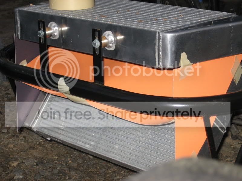

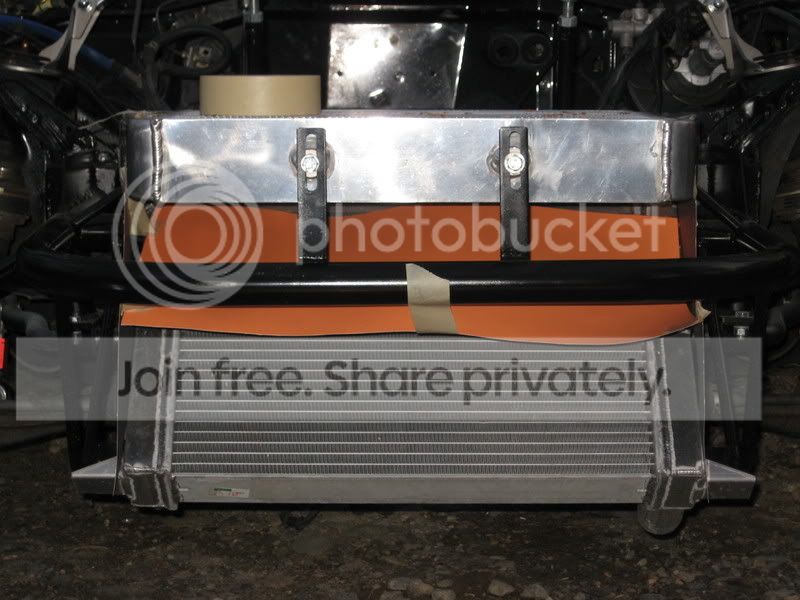

i started to make templates to cut aluminum and to get an idea of what i want tith the ducting. what do you guys think of the setup, i will be running a scirraco puller fan in the back of the rad. and i do have the room to run some 6" pusher fans on the intercooler if needed.
Old May 4, 2008 | 05:21 PM
ROTARY's Avatar
Posts: 588
looks good, the radiator outlet looks like it needs to be moved further up so you have 5-1/2" to 6" of ground clearance from the lowest part of your radiator also put the bumper back on and make sure there is no gaps in your ducting

theres enough ground clearence, but im gonna cut that fitting off and run a 16an fitting for rad hoses

make your ducting go to the core of the radiator and not the end tanks

I second (or third?) having your ducting going from end of the rad core to end of the IC core. Don't include the end tanks in the ducting, it will just create a place for air to stall.
I'd also run it without the middle separator and see how it all does with IAT and CLTs. Then if you feel that one is getting an imbalance, add a piece in that can be adjusted. Slot the side ducts (or drill extra holes) and use brackets to adjust the separator.

<TABLE WIDTH="90%" CELLSPACING=0 CELLPADDING=0 ALIGN=CENTER><TR><TD>Quote, originally posted by 4drsedaneg &raquo;</TD></TR><TR><TD CLASS="quote">i started to make templates to cut aluminum and to get an idea of what i want tith the ducting. what do you guys think of the setup, i will be running a scirraco puller fan in the back of the rad. and i do have the room to run some 6" pusher fans on the intercooler if needed.
is this for your miata? im kind of confused. in your pics in the other thread it looks as if you cut the frame rails and everything out ahead of the front strut towers, but in the pics in this thread it appears that you have just about everything but the radiator support and a few other supplementary pieces of non integral frame. what gives?

Default Re: v mount opinons (Justin Olson)
no its the same as in other pics. just camera trickery in this one
