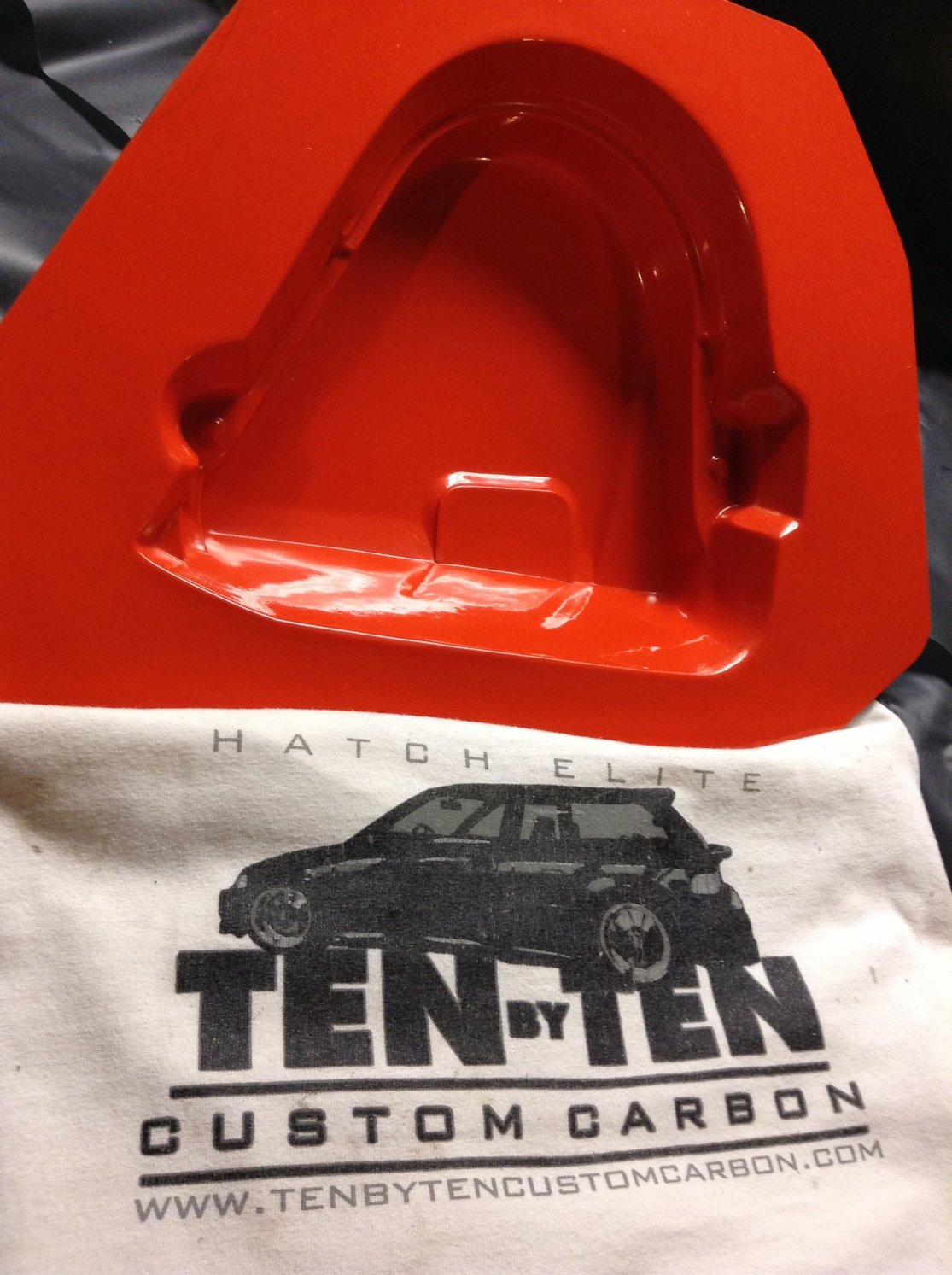

We started with a BNIB cover as you see here...
Here we see design work complete on the plug as it waits to be waxed and have PVA mold release sprayed on.

As for this project, the previous picture shows the design work done on our mold plug. To begin the mold we first apply a mold release wax, then spray a PVA (polyvinyl alcohol) mold release to ensure trouble free part removal after cure.
Once dry, we use a gel coat cup gun to spray Orange Tooling Gel Coat. After that a tooling dough fillets reinforce the detail. Next many layers of Chopped Strand Mat are applied and the mold is finally capped with a fiberglass Tooling Fabric specifically made for molds.
Fast forward past cure and removal, we have a production level mold ready for combat.

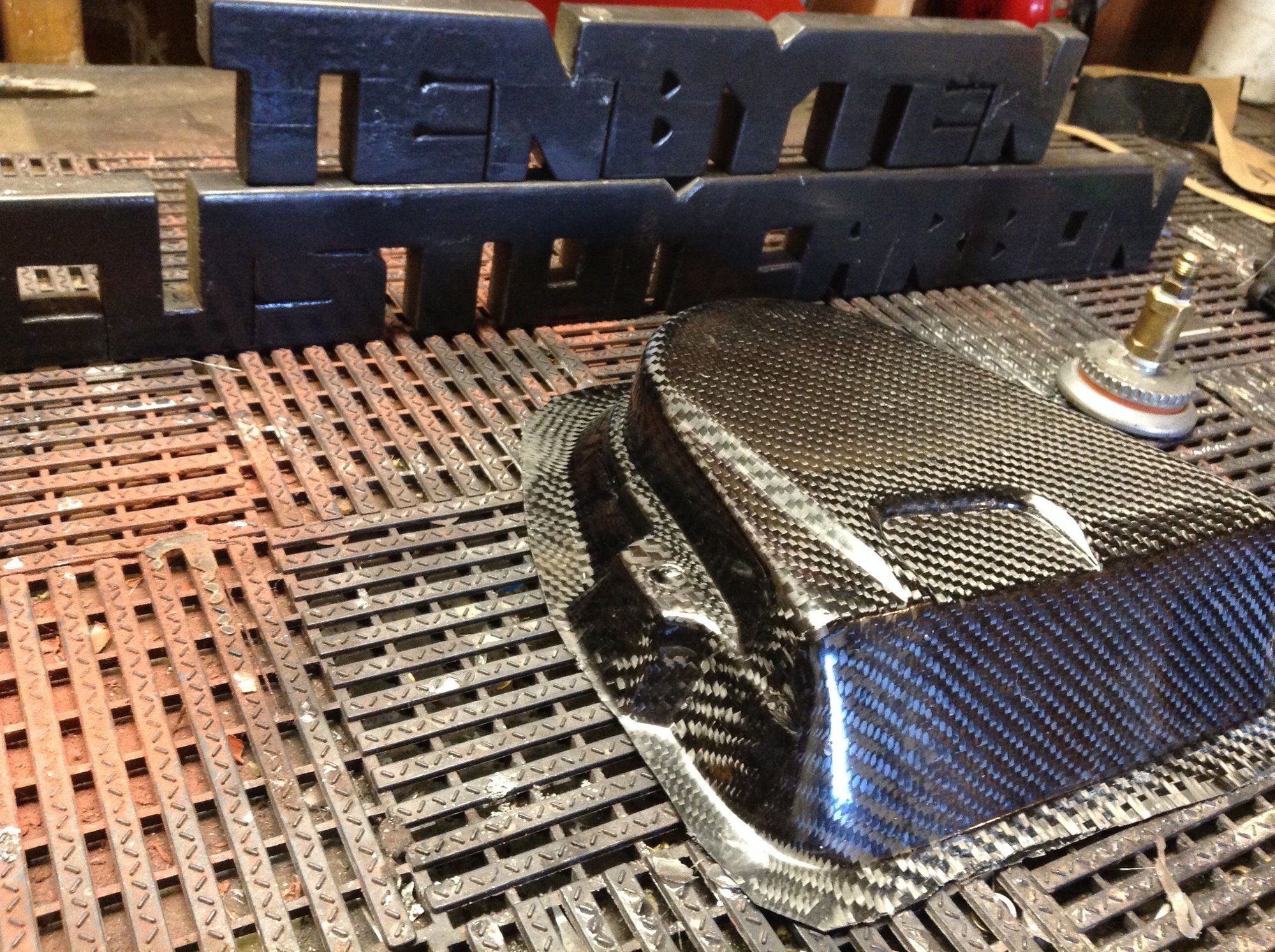

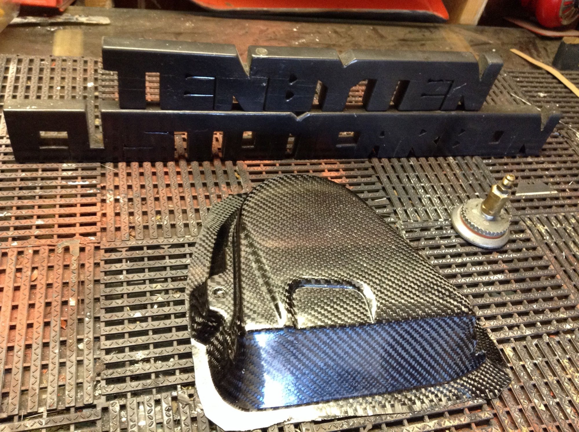

After fighting multiple bag leaks we were able to get the first part laid up successfully. Here is the part popped from the mold moments ago....
#CarbonFiberTimingCover #SOHCVTEC #Dseries #D16 #HatchElite #TenByTenCustomCarbon #CustomCarbonFiber<br/>So Fresh and so Clean popped right from the mold minutes ago....<br/>More to come.<br/>
Just needs a little finishing and trimming, pics to come..
