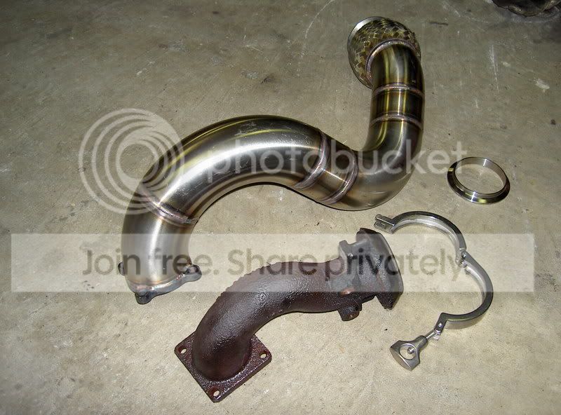

Heres the last manifold I made for the baja1000 this year, this is for one of the main race trucks, we ceramic coated it in the bling finish. My supplier ran out of of the smooth 45* bends so the orange peel look on some parts is not the cerma coat but just rough weld el's.
Don't know how many of you guys have tried making 1.5"sch 40 collectors for split turbine on a 6cyl engine but its quite time consuming! I don't weld the inside of my collectors, The collectors are milled so the fitup is good, that said though I actually cut this specific collector with a dry cut saw.
Old Sep 29, 2007 | 03:42 PM
dave@passenger's Avatar
Joined: Jun 2006
Posts: 978
From: Abbotsford, BC
Ic pipes:
3" downpipe:
Compared to stock:
FMIC:
Custom intake manifold:
Complete:
