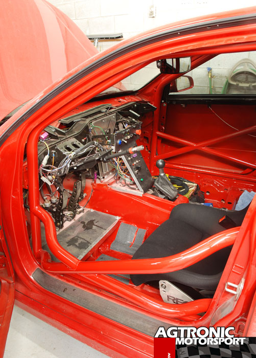

Agtronic's Avatar
Posts: 988
From: Montreal, Quebec, Canada
Default Re: Quick roll cage question
Is this what you mean?
For the record, I did not build this cage, but as far as I know, it is an FIA-spec cage.
Old Mar 11, 2009 | 02:31 PM
redboost10's Avatar
Posts: 7,056
yeah they dont care how you bend them horizontally, but from what ive seen, they tend to frown at large vertical bends due to the lack of support to the leg area, hope you understand what i am saying, kinda hard to explain.
