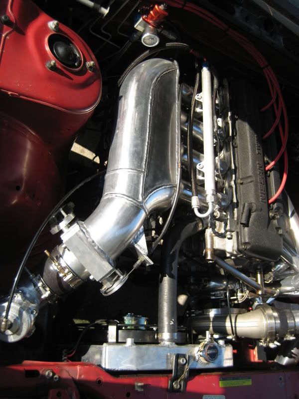

the intake mani design was thought up between me and my good buddy Angel. He is the one who did all the fab work you see on the car. Its basically what will work the best while still keeping it as simple as possible.
materials were sourced locally for the most part, except for the velocity stacks that came from ross machine racing.

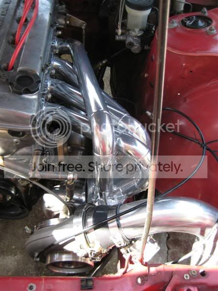

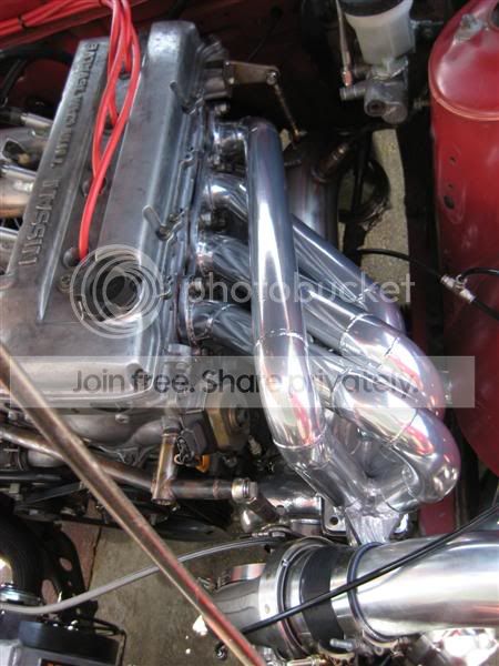

btw: Got the exhaust mani back from coating. ill have some new pics up tomorrow and maybe a vid or two if we get it running.

Looks great man-- what happened to the 350z motor? Also-- what gauge/size aluminum piping did you use?

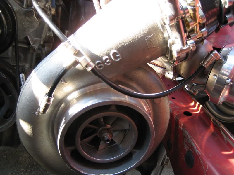

yo ramon, its alan (jerms friend with the black wrx) .. last time i heard ofu was with the white k-hatch (waaay back). ive been sourcing parts for a ka-t build with this same turbo but with the R cover.. i wondering why you chose to go with the standard cover besides the v-band outlet?

$$$ is the reason i don't have an R cover.

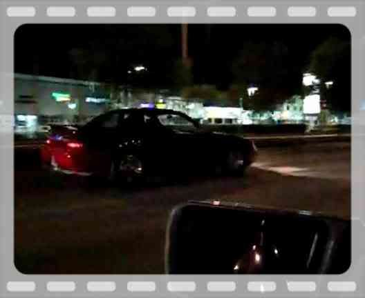

vids from Friday night while my buddy Angel was cleaning up the pump gas map. its on 15 psi. I'm very surprised at how well the s372 spools and responds between shifts. I get full boost (15 psi for now) before 5k and no noticeable lag in power between shifts. Cant wait to turn it up to were it should be.
first vid is just me messing around with a buddies stock turbo evo (you can see him towards the end of the vid on the right)
http://www.youtube.com/watch?v=Pf3ckL-5aJA
this is me running a friends 470 whp srt-4.
http://www.youtube.com/watch?v=jf8xlPjbqdw

yo that first clip scared the bejezzus outta me.. u need some in-car footage with a shot of the tach. and was the camera car a mini-van or sumthin? cojones thats a slow chaser..
