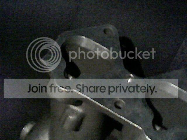

a buddy of mine hooked me up with a jg manifold , cause im doing an all motor set up but the problem is that its broken from one edge and its missing a hole for a bolt.....i wanna have ur opinions to see if i can still fix this and what suggestions u guys have thanxs in advanve.

run it without the bolt, you'll be just fine!

Run it.

i was thinking of just getting them to weld anykind of piece and the ill just drill a hole and see what happens =/

It will not seal without that bolt in. Have it welded and then surface it. Its an easy fix.

find the broken tab nd but joint it, then machine down the flange so its smooth again

run it.. it wont leak.

lol it prob wont leak , but might as well weld a tab on it drill a hole and suurface it for good measures

bolt it up and put some silicon gasket maker around it. let it setup for 24 hours, done. no leaks.

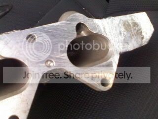

i took it to get it fixed and heres the outcome i think it should be ok now ...just need to drill a hole and maybe cut it a little ........
