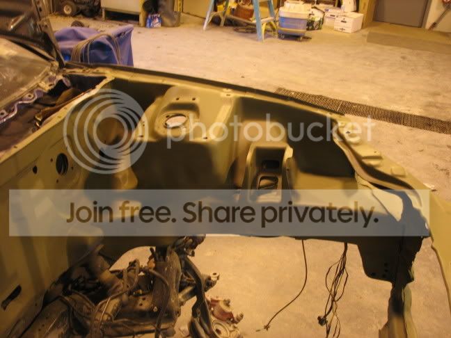

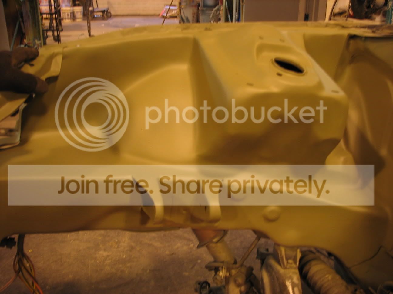

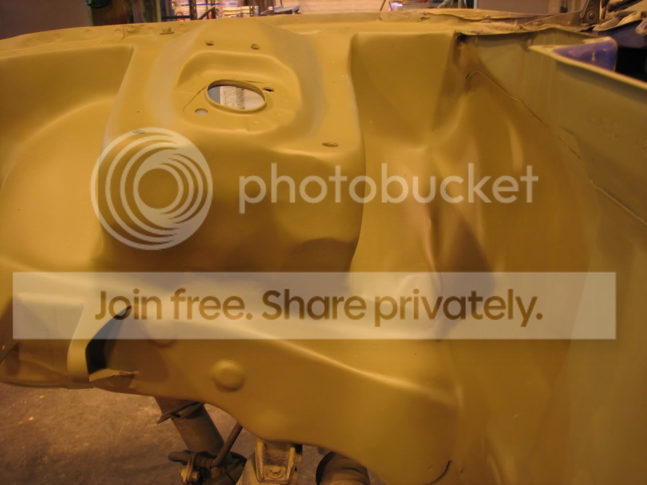

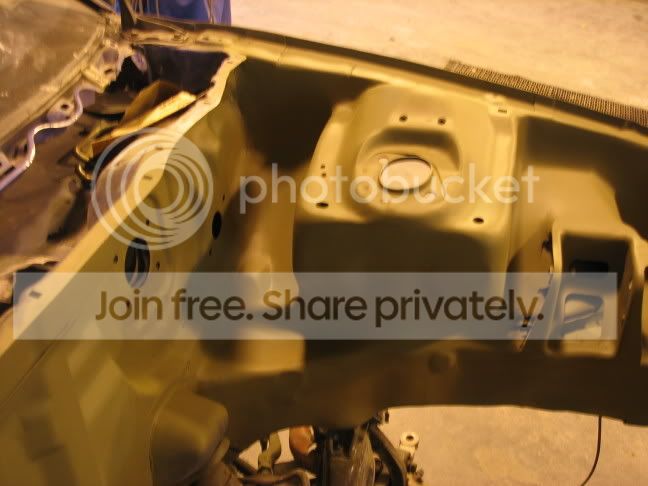

the engine bay got a its first full layer of primer tonight its not done but it will give an idea il take pictures tonight

UPDATE its not done but this will give you an idea il get some pics next week when the engine is mocked in
