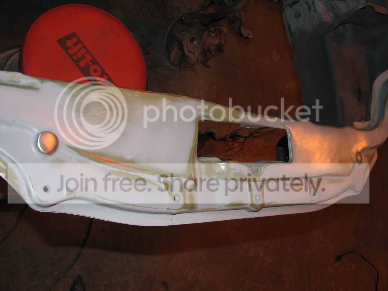

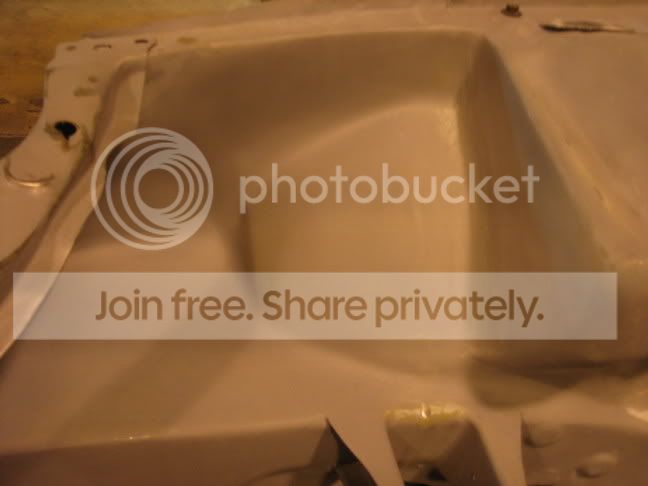

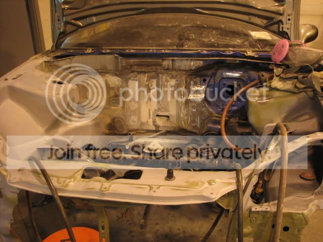

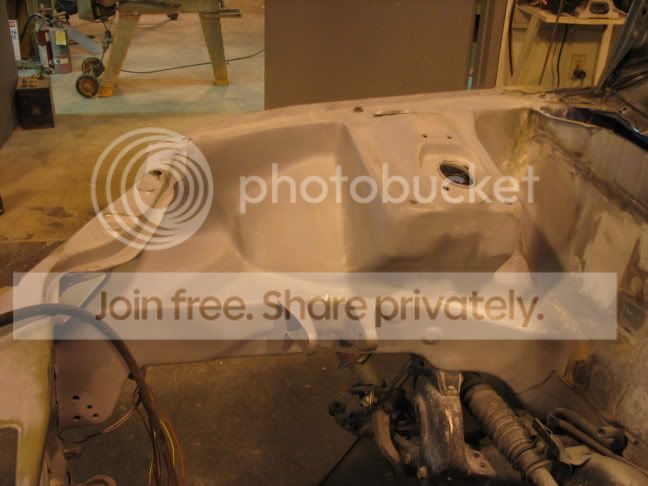

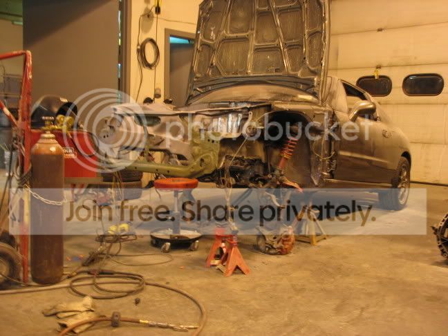

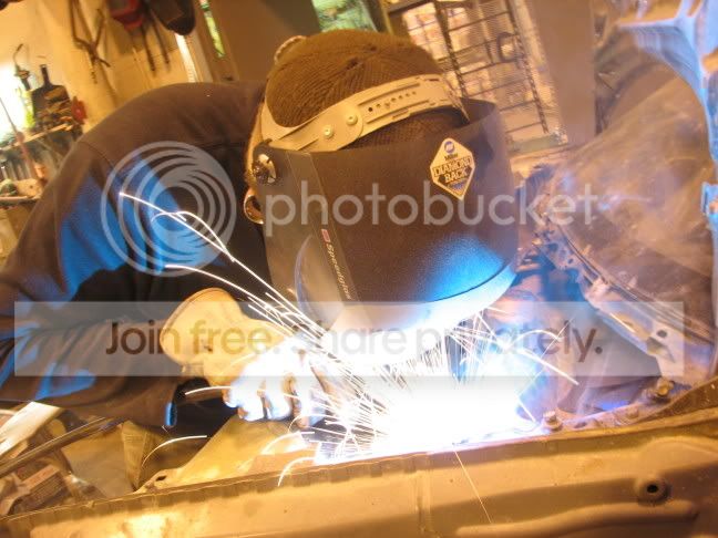

here are some pics of my del sol hoping to have it in primer in a fiew days then get the engine in for mock up and running my break lines building my turbo manifold and dp and charge piping then rip it all back out to paint it. wires for headlights are ran through the frame along with the brakelines wish me luck

Nice man, I have always considered doing something simular to that to have a very smooth look inside my engine bay also, only thing is, it would be a nightmare getting it clean for all the bondo and fiberglass.

i used stripese and little 1 inch sanding disks its a long process i have a month invested now probally near 100 hours

the stripping isint that bad its all the welding grinding and sanding that kills you and i hate bodywork but it will be worth it when people wonder how it runs

<TABLE WIDTH="90%" CELLSPACING=0 CELLPADDING=0 ALIGN=CENTER><TR><TD>Quote, originally posted by cstay &raquo;</TD></TR><TR><TD CLASS="quote">the stripping isint that bad its all the welding grinding and sanding that kills you...</TD></TR></TABLE>

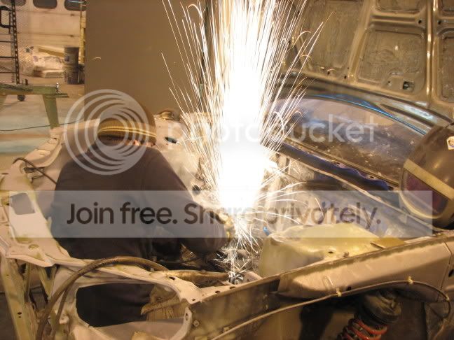

Just out of curiosity, what settings are you using on your Lincoln and what size wire?

im using 35 wire and the setting depends on where i am some times its all the way up at J 5.5 somtimes im at like C 3.5 depends on the thickness and what im welding

just to let you know, you shoudl have something on your windsheild when your welding.... the sparks will pit the glass or somewthing......i have seen it before

im replacing it it was nasty aneyways so i figured why repaint the whole car and have a nasty winshield

Can you explain a little how you did it?
I think the first is to weld all the holes - and then? Have you took tin and then fibreglass - or just fibreglass?
How have do you want to solve the problem with rust behind the welds, where you can´t add a corrosions protection fluid?

basically weld all of the bolt holes shut and for the holes that are to big just cut a piec and weld it in grind it down and put fiberglass over it. im not the best at bodywork hopefully it comes out looking good.

when you say fiberglass... are you talking about the everglass putty stuff? or did you lay down a peice of clith with resin? id be worry about the clotch/resin combo cracking under torsion/flexing.

Cracking of the fibreglass caused by torsion/vibration is what I´m a little worried about.
How are your experiences in this case?

i reeally like how u shaved that hole on the passenger side, the one where intake n stuff go thru. That looks great!!!
