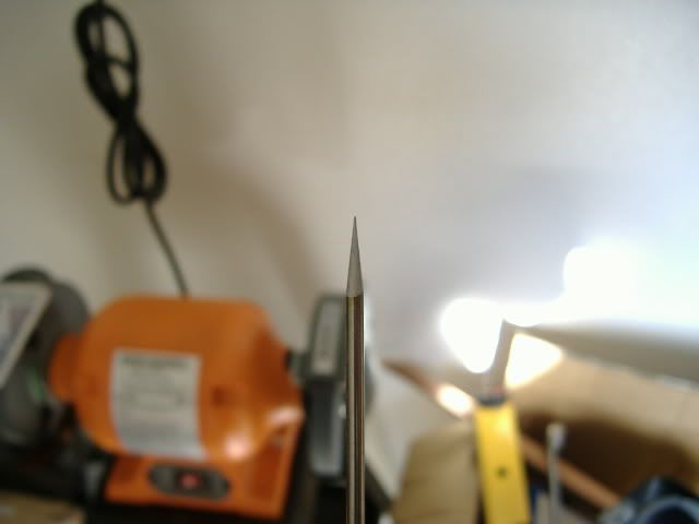

The hand-held sharpeners are essentially a tiny bench grinder with a small hole so you can only stick a tungsten in. I have a seperate 6" bench grinder that I only use for sharpening my tungstens and nothing else. It's a lot cheaper than the hand-held tungsten sharpeners.
As far as the color of tungsten goes, I use red 3/32" tungstens for everything. I sharpen it to a fine point regardless of the material. It has always worked great.

thanks for the comments, the biggest cup i have is a #6 so Im looking to get a gas saver/larger cup kit soon. Plus Im left handed so that has to score me some points right? More like a handicap haha. Wow you sharpen yours to a lot narrower point then i do, I'll try doing that. Thanks

Agree with the choice of 2% and also the very sharp point.
Best to just go and buy a cheap bench grinder and a good pin vise not a pos one. I usually use my belt sander and it works the best as far as I am concerned. With the bench grinder you will usually have to grind inline with the wheel. With the belt sander its doesn't matter.
I use either 80 or 100 grit Zirconia (blue ) 6x48 belts and my sander has a 2hp with a larger pulley to speed it up. I buy the cheaper belt sanders and change the motor/pulley and have a better unit then a very expensive delta or the like.
The other problem with the dedicated tungsten grinders is they cant seem to do short pcs
